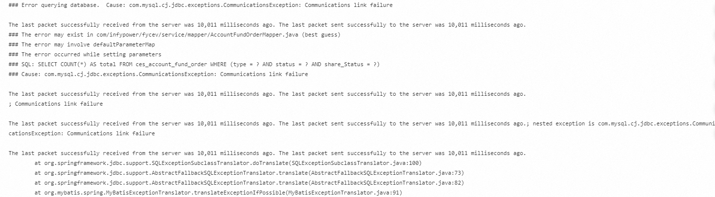

异常如下:
  1. ### Cause: com.mysql.cj.jdbc.exceptions.CommunicationsException: Communications link failure
  2. The last packet successfully received from the server was 10,011 milliseconds ago. The last packet sent successfully to the server was 10,011 milliseconds ago.
  3. ; Communications link failure
  4. The last packet successfully received from the server was 10,011 milliseconds ago. The last packet sent successfully to the server was 10,011 milliseconds ago.; nested exception is com.mysql.cj.jdbc.exceptions.CommunicationsException: Communications link failure
  5. The last packet successfully received from the server was 10,011 milliseconds ago. The last packet sent successfully to the server was 10,011 milliseconds ago.
  6.         at org.springframework.jdbc.support.SQLExceptionSubclassTranslator.doTranslate(SQLExceptionSubclassTranslator.java:100)
  7.         at org.springframework.jdbc.support.AbstractFallbackSQLExceptionTranslator.translate(AbstractFallbackSQLExceptionTranslator.java:73)
  8.         at org.springframework.jdbc.support.AbstractFallbackSQLExceptionTranslator.translate(AbstractFallbackSQLExceptionTranslator.java:82)
  9.         at org.mybatis.spring.MyBatisExceptionTranslator.translateExceptionIfPossible(MyBatisExceptionTranslator.java:91)
  10.         at org.mybatis.spring.SqlSessionTemplate$SqlSessionInterceptor.invoke(SqlSessionTemplate.java:441)
  11.         at com.sun.proxy.$Proxy152.selectList(Unknown Source)
  12.         at org.mybatis.spring.SqlSessionTemplate.selectList(SqlSessionTemplate.java:224)
  13.         at com.baomidou.mybatisplus.core.override.MybatisMapperMethod.executeForIPage(MybatisMapperMethod.java:121)
  14.         at com.baomidou.mybatisplus.core.override.MybatisMapperMethod.execute(MybatisMapperMethod.java:85)
  15.         at com.baomidou.mybatisplus.core.override.MybatisMapperProxy$PlainMethodInvoker.invoke(MybatisMapperProxy.java:148)
  16.         at com.baomidou.mybatisplus.core.override.MybatisMapperProxy.invoke(MybatisMapperProxy.java:89)
  17.         at com.sun.proxy.$Proxy535.selectPage(Unknown Source)
  18.         at sun.reflect.GeneratedMethodAccessor2431.invoke(Unknown Source)
  19.         at sun.reflect.DelegatingMethodAccessorImpl.invoke(DelegatingMethodAccessorImpl.java:43)
