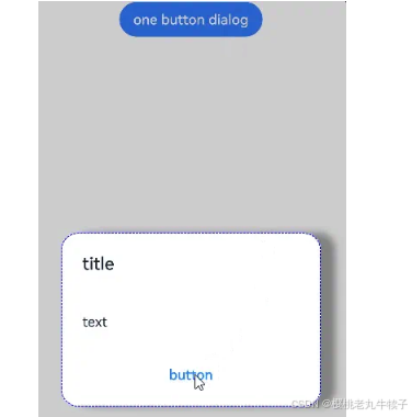

示例1
说明
直接使用AlertDialog可能导致实例不明白的问题,建议使用[getUIContext]获取UIContext实例,并使用[showAlertDialog]调用绑定实例的AlertDialog.show()。
分别弹出一、二、三个按钮的弹窗。
  1. // xxx.ets
  2. @Entry
  3. @Component
  4. struct AlertDialogExample {
  5.   build() {
  6.     Column({ space: 5 }) {
  7.       Button('one button dialog')
  8.         .onClick(() => {
  9.           // 建议使用this.getUIContext().showAlertDialog()
  10.           AlertDialog.show(
  11.             {
  12.               title: 'title',
  13.               message: 'text',
  14.               autoCancel: true,
  15.               alignment: DialogAlignment.Bottom,
  16.               offset: { dx: 0, dy: -20 },
  17.               gridCount: 3,
  18.               confirm: {
  19.                 value: 'button',
  20.                 action: () => {
  21.                   console.info('Button-clicking callback')
  22.                 }
  23.               },
  24.               cancel: () => {
  25.                 console.info('Closed callbacks')
  26.               },
  27.               onWillDismiss:(dismissDialogAction: DismissDialogAction)=> {
  28.                 console.info("reason=" + JSON.stringify(dismissDialogAction.reason))
  29.                 console.log("dialog onWillDismiss")
  30.                 if (dismissDialogAction.reason == DismissReason.PRESS_BACK) {
  31.                   dismissDialogAction.dismiss()
  32.                 }
  33.                 if (dismissDialogAction.reason == DismissReason.TOUCH_OUTSIDE) {
  34.                   dismissDialogAction.dismiss()
  35.                 }
  36.               }
  37.             }
  38.           )

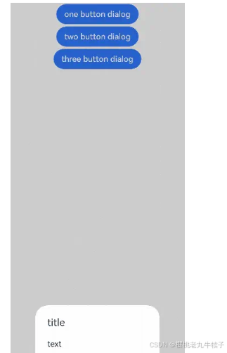

  84.         Button('three button dialog')
  85.         .onClick(() => {
  86.           // 建议使用this.getUIContext().showAlertDialog()
  87.           AlertDialog.show(
  88.             {
  89.               title: 'title',
  90.               subtitle: 'subtitle',
  91.               message: 'text',
  92.               autoCancel: true,
  93.               alignment: DialogAlignment.Bottom,
  94.               gridCount: 4,
  95.               offset: { dx: 0, dy: -20 },
  96.               buttonDirection: DialogButtonDirection.HORIZONTAL,
  97.               buttons: [
  98.                 {
  99.                   value: '按钮',
  100.                   action: () => {
  101.                     console.info('Callback when button1 is clicked')
  102.                   }
  103.                 },
  104.                 {
  105.                   value: '按钮',
  106.                   action: () => {
  107.                     console.info('Callback when button2 is clicked')
  108.                   }
  109.                 },
  110.                 {
  111.                   value: '按钮',
  112.                   enabled: true,
  113.                   defaultFocus: true,
  114.                   style: DialogButtonStyle.HIGHLIGHT,
  115.                   action: () => {
  116.                     console.info('Callback when button3 is clicked')
  117.                   }
  118.                 },
  119.               ],
  120.               cancel: () => {
  121.                 console.info('Closed callbacks')
  122.               },
  123.               onWillDismiss:(dismissDialogAction: DismissDialogAction)=> {
  124.                 console.info("reason=" + JSON.stringify(dismissDialogAction.reason))
  125.                 console.log("dialog onWillDismiss")
  126.                 if (dismissDialogAction.reason == DismissReason.PRESS_BACK) {
  127.                   dismissDialogAction.dismiss()
  128.                 }
  129.                 if (dismissDialogAction.reason == DismissReason.TOUCH_OUTSIDE) {
  130.                   dismissDialogAction.dismiss()
  131.                 }
  132.               }
  133.             }
  134.           )
  135.         }).backgroundColor(0x317aff)

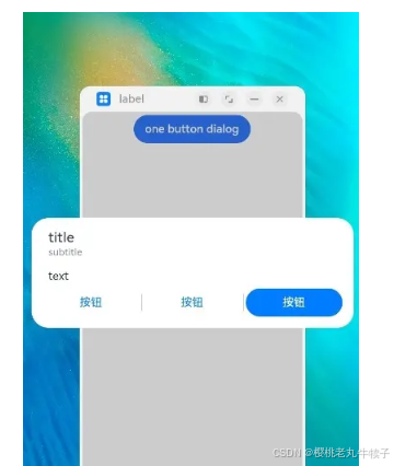

示例2
弹出可展示在主窗外的弹窗。
说明
  1. // xxx.ets
  2. @Entry
  3. @Component
  5.   build() {
  8.         .onClick(() => {
  11.             {
  12.               title: 'title',
  13.               subtitle: 'subtitle',
  14.               message: 'text',
  15.               autoCancel: true,
  16.               alignment: DialogAlignment.Center,
  17.               gridCount: 4,
  18.               showInSubWindow: true,
  19.               isModal: true,
  20.               offset: { dx: 0, dy: -20 },
  21.               buttonDirection: DialogButtonDirection.HORIZONTAL,
  22.               buttons: [
  23.                 {
  24.                   value: '按钮',
  25.                   action: () => {
  26.                     console.info('Callback when button1 is clicked')
  27.                   }
  28.                 },
  29.                 {
  30.                   value: '按钮',
  31.                   action: () => {
  32.                     console.info('Callback when button2 is clicked')
  33.                   }
  34.                 },
  35.                 {
  36.                   value: '按钮',
  37.                   enabled: true,
  38.                   defaultFocus: true,
  39.                   style: DialogButtonStyle.HIGHLIGHT,
  40.                   action: () => {
  41.                     console.info('Callback when button3 is clicked')
  42.                   }
  43.                 },
  44.               ],
  45.               cancel: () => {
  46.                 console.info('Closed callbacks')
  47.               },
  48.               onWillDismiss: (dismissDialogAction: DismissDialogAction) => {

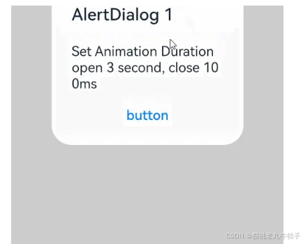

示例3
AlertDialog显示动画连续3秒,退出动画连续100毫秒
说明
  1. // xxx.ets
  2. @Entry
  3. @Component
  5.   build() {
  7.       Button('AlertDialog Set Duration')
  8.         .onClick(()=>{
  11.               {
  12.                 title: 'AlertDialog 1',
  13.                 message: 'Set Animation Duration open 3 second, close 100ms',
  15.                 alignment: DialogAlignment.Top,
  17.                 gridCount: 3,
  18.                 transition:TransitionEffect.asymmetric(TransitionEffect.OPACITY
  19.                   .animation({ duration: 3000, curve: Curve.Sharp }).combine(TransitionEffect.scale({x: 1.5, y: 1.5}).animation({duration: 3000, curve: Curve.Sharp})),
  20.                   TransitionEffect.OPACITY.animation({ duration: 100, curve: Curve.Smooth })
  21.                     .combine(TransitionEffect.scale({x: 0.5, y: 0.5}).animation({duration: 100, curve: Curve.Smooth}))),
  22.                 confirm: {
  23.                   value: 'button',
  24.                   action: () => {
  25.                     console.info('Button-clicking callback')
  26.                   }
  27.                 },
  28.                 cancel: () => {
  29.                   console.info('Closed callbacks')
  30.                 }
  31.               }
  32.             )
  33.         })
  34.         .backgroundColor(0x317aff).height("88px")
  35.     }.width('100%').margin({ top: 5 })
  36.   }
  37. }
示例4
该示例定义了AlertDialog的样式,如宽度、高度、背景色、阴影等等
说明
  1. // xxx.ets
  2. @Entry
  3. @Component
  5.   build() {
  8.         .onClick(() => {
  11.             {
  12.               title: 'title',
  15.               alignment: DialogAlignment.Center,
  17.               gridCount: 3,
  18.               width: 300,
  19.               height: 200,
  20.               cornerRadius: 20,
  21.               borderWidth: 1,
  22.               borderStyle: BorderStyle.Dashed,//使用borderStyle属性,需要和borderWidth属性一起使用
  23.               borderColor: Color.Blue,//使用borderColor属性,需要和borderWidth属性一起使用
  24.               backgroundColor: Color.White,
  25.               shadow: ({ radius: 20, color: Color.Grey, offsetX: 50, offsetY: 0}),
  26.               textStyle: { wordBreak: WordBreak.BREAK_ALL },
  27.               confirm: {
  28.                 value: 'button',
  29.                 action: () => {
  30.                   console.info('Button-clicking callback')
  31.                 }
  32.               },
  33.               cancel: () => {
  34.                 console.info('Closed callbacks')
  35.               },
  36.               onWillDismiss:(dismissDialogAction: DismissDialogAction)=> {
  37.                 console.info("reason=" + JSON.stringify(dismissDialogAction.reason))
  38.                 console.log("dialog onWillDismiss")
  39.                 if (dismissDialogAction.reason == DismissReason.PRESS_BACK) {
  40.                   dismissDialogAction.dismiss()
  41.                 }
  42.                 if (dismissDialogAction.reason == DismissReason.TOUCH_OUTSIDE) {
  43.                   dismissDialogAction.dismiss()
  44.                 }
  45.               }
  46.             }
  47.           )
  48.         })
  49.         .backgroundColor(0x317aff)
