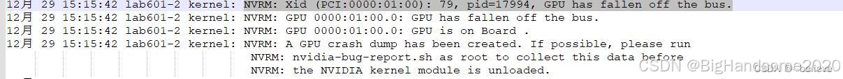

1、使用sudo nvidia-bug-report.sh查看问题log
跑训练时同时运行nvidia-bug-report.sh同步显卡状态和bug信息,从中查找到问题:
  1. Xid (...): 79, pid='<unknown>', name=<unknown>, GPU has fallen off the bus
参考ISSUE大佬提到:
   One of the gpus is shutting down. Since it’s not always the same one, I guess they’re not damaged but either overheating or lack of power occurs. Please monitor temperatures, check PSU.
  大概率是过热、缺电导致的

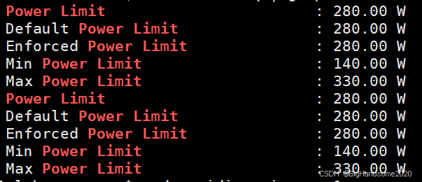

(2)显卡功耗墙
题主双卡1080TI只用了850W的电源(怀疑不敷),设置了一下功耗墙:
sudo vim /etc/systemd/system/nvidia-power-limit.service
  1. 以下内容写入文件
  2. [Unit]
  3. Description=Set NVIDIA GPU Power Limit
  4. [Service]
  5. Type=oneshot
  6. ExecStart=/usr/bin/nvidia-smi -pl 200
  7. [Install]
  8. WantedBy=multi-user.target
启用服务在启动时自动应勤奋率限定:
sudo systemctl enable nvidia-power-limit.service

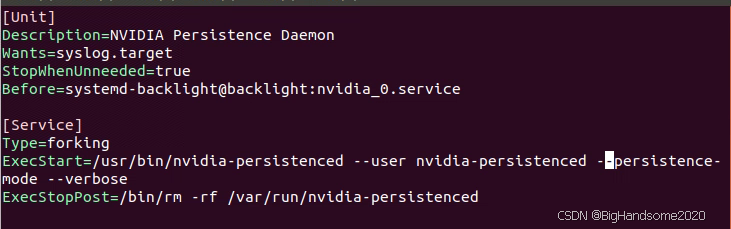

(3)显卡设置双卡持久模式,包管GPU驱动即使没有东西在运行也是处于加载状态,避免驱动频繁加载
PS:GPU默认持久模式关闭的时候,如果负载低会休眠,之后唤起有肯定几率失败。nvidia-smi -pm 1下令可以使GPU一直保持准备工作的状态,跑训练前可调用。
开机自动开持久模式的设置方式:
sudo vim /lib/systemd/system/nvidia-persistenced.service
  1. Change
  2. ExecStart=/usr/bin/nvidia-persistenced --user nvidia-persistenced --no-persistence-mode --verbose
  3. To:
  4. ExecStart=/usr/bin/nvidia-persistenced --user nvidia-persistenced --persistence-mode --verbose
