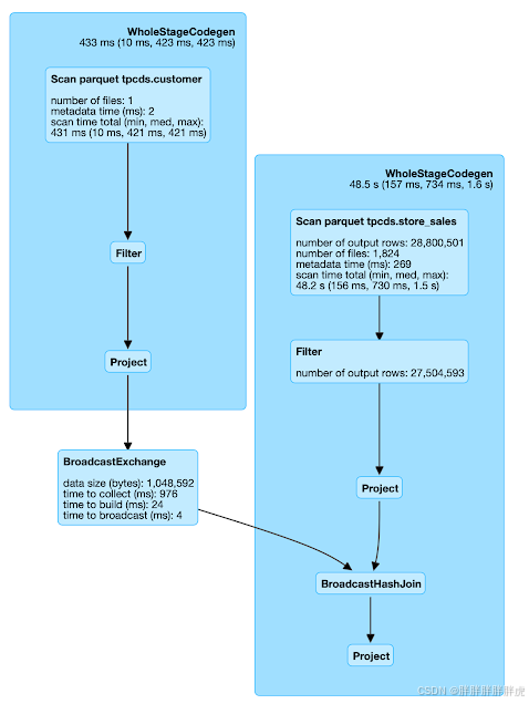

a. Broadcast Hash Join is chosen because the smaller side’s(after Filter on “customer” table) estimation is sizeInBytes=16.0 B which is below default value of spark.sql.autoBroadcastJoinThreshold – 10MB.
  1. set spark.sql.cbo.enabled=true;
  2. set spark.sql.statistics.histogram.enabled=true;
  3. use tpcds;
  4. explain cost select c.c_current_addr_sk,s.ss_sold_time_sk as c2 from customer c, store_sales s
  5. where c.c_customer_sk = s.ss_customer_sk
  6. and c.c_customer_id = "123";
Explain plan with cost:
  1. == Optimized Logical Plan ==
  2. Project [c_current_addr_sk#18, ss_sold_time_sk#32 AS c2#11], Statistics(sizeInBytes=928.0 B, rowCount=58, hints=none)
  3. +- Join Inner, (c_customer_sk#14 = ss_customer_sk#34), Statistics(sizeInBytes=1392.0 B, rowCount=58, hints=none)
  4.    :- Project [c_customer_sk#14, c_current_addr_sk#18], Statistics(sizeInBytes=16.0 B, rowCount=1, hints=none)
  5.    :  +- Filter ((isnotnull(c_customer_id#15) && (c_customer_id#15 = 123)) && isnotnull(c_customer_sk#14)), Statistics(sizeInBytes=250.0 B, rowCount=1, hints=none)
  6.    :     +- Relation[c_customer_sk#14,c_customer_id#15,c_current_cdemo_sk#16,c_current_hdemo_sk#17,c_current_addr_sk#18,c_first_shipto_date_sk#19,c_first_sales_date_sk#20,c_salutation#21,c_first_name#22,c_last_name#23,c_preferred_cust_flag#24,c_birth_day#25,c_birth_month#26,c_birth_year#27,c_birth_country#28,c_login#29,c_email_address#30,c_last_review_date#31] parquet, Statistics(sizeInBytes=119.2 MB, rowCount=5.00E+5, hints=none)
  7.    +- Project [ss_sold_time_sk#32, ss_customer_sk#34], Statistics(sizeInBytes=419.7 MB, rowCount=2.75E+7, hints=none)
  8.       +- Filter isnotnull(ss_customer_sk#34), Statistics(sizeInBytes=3.9 GB, rowCount=2.75E+7, hints=none)
  9.          +- Relation[ss_sold_time_sk#32,ss_item_sk#33,ss_customer_sk#34,ss_cdemo_sk#35,ss_hdemo_sk#36,ss_addr_sk#37,ss_store_sk#38,ss_promo_sk#39,ss_ticket_number#40L,ss_quantity#41,ss_wholesale_cost#42,ss_list_price#43,ss_sales_price#44,ss_ext_discount_amt#45,ss_ext_sales_price#46,ss_ext_wholesale_cost#47,ss_ext_list_price#48,ss_ext_tax#49,ss_coupon_amt#50,ss_net_paid#51,ss_net_paid_inc_tax#52,ss_net_profit#53,ss_sold_date_sk#54] parquet, Statistics(sizeInBytes=4.1 GB, rowCount=2.88E+7, hints=none)
  10. == Physical Plan ==
  11. *(2) Project [c_current_addr_sk#18, ss_sold_time_sk#32 AS c2#11]
  12. +- *(2) BroadcastHashJoin [c_customer_sk#14], [ss_customer_sk#34], Inner, BuildLeft
  13.    :- BroadcastExchange HashedRelationBroadcastMode(List(cast(input[0, int, true] as bigint)))
  14.    :  +- *(1) Project [c_customer_sk#14, c_current_addr_sk#18]
  15.    :     +- *(1) Filter ((isnotnull(c_customer_id#15) && (c_customer_id#15 = 123)) && isnotnull(c_customer_sk#14))
  16.    :        +- *(1) FileScan parquet tpcds.customer[c_customer_sk#14,c_customer_id#15,c_current_addr_sk#18] Batched: true, Format: Parquet, Location: InMemoryFileIndex[hdfs:///tpcds/customer], PartitionFilters: [], PushedFilters: [IsNotNull(c_customer_id), EqualTo(c_customer_id,123), IsNotNull(c_customer_sk)], ReadSchema: struct<c_customer_sk:int,c_customer_id:string,c_current_addr_sk:int>
  17.    +- *(2) Project [ss_sold_time_sk#32, ss_customer_sk#34]
  18.       +- *(2) Filter isnotnull(ss_customer_sk#34)
  19.          +- *(2) FileScan parquet tpcds.store_sales[ss_sold_time_sk#32,ss_customer_sk#34,ss_sold_date_sk#54] Batched: true, Format: Parquet, Location: CatalogFileIndex[hdfs:///tpcds/store_sales], PartitionCount: 1824, PartitionFilters: [], PushedFilters: [IsNotNull(ss_customer_sk)], ReadSchema: struct<ss_sold_time_sk:int,ss_customer_sk:int>

Query Plan in Web UI:

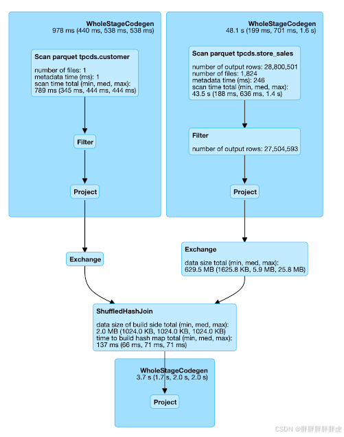

b. Shuffle Hash Join is chosen because 16 bytes < spark.sql.autoBroadcastJoinThreshold=2 * spark.sql.shuffle.partitions=9
  1. set spark.sql.join.preferSortMergeJoin=false;
  2. set spark.sql.autoBroadcastJoinThreshold=9;
  3. set spark.sql.shuffle.partitions=2;
  2. Project [c_current_addr_sk#31, ss_sold_time_sk#45 AS c2#250], Statistics(sizeInBytes=928.0 B, rowCount=58, hints=none)
  3. +- Join Inner, (c_customer_sk#27 = ss_customer_sk#47), Statistics(sizeInBytes=1392.0 B, rowCount=58, hints=none)
  4.    :- Project [c_customer_sk#27, c_current_addr_sk#31], Statistics(sizeInBytes=16.0 B, rowCount=1, hints=none)
  5.    :  +- Filter ((isnotnull(c_customer_id#28) && (c_customer_id#28 = 123)) && isnotnull(c_customer_sk#27)), Statistics(sizeInBytes=250.0 B, rowCount=1, hints=none)
  6.    :     +- Relation[c_customer_sk#27,c_customer_id#28,c_current_cdemo_sk#29,c_current_hdemo_sk#30,c_current_addr_sk#31,c_first_shipto_date_sk#32,c_first_sales_date_sk#33,c_salutation#34,c_first_name#35,c_last_name#36,c_preferred_cust_flag#37,c_birth_day#38,c_birth_month#39,c_birth_year#40,c_birth_country#41,c_login#42,c_email_address#43,c_last_review_date#44] parquet, Statistics(sizeInBytes=119.2 MB, rowCount=5.00E+5, hints=none)
  7.    +- Project [ss_sold_time_sk#45, ss_customer_sk#47], Statistics(sizeInBytes=419.7 MB, rowCount=2.75E+7, hints=none)
  8.       +- Filter isnotnull(ss_customer_sk#47), Statistics(sizeInBytes=3.9 GB, rowCount=2.75E+7, hints=none)
  9.          +- Relation[ss_sold_time_sk#45,ss_item_sk#46,ss_customer_sk#47,ss_cdemo_sk#48,ss_hdemo_sk#49,ss_addr_sk#50,ss_store_sk#51,ss_promo_sk#52,ss_ticket_number#53L,ss_quantity#54,ss_wholesale_cost#55,ss_list_price#56,ss_sales_price#57,ss_ext_discount_amt#58,ss_ext_sales_price#59,ss_ext_wholesale_cost#60,ss_ext_list_price#61,ss_ext_tax#62,ss_coupon_amt#63,ss_net_paid#64,ss_net_paid_inc_tax#65,ss_net_profit#66,ss_sold_date_sk#67] parquet, Statistics(sizeInBytes=4.1 GB, rowCount=2.88E+7, hints=none)
  11. *(3) Project [c_current_addr_sk#31, ss_sold_time_sk#45 AS c2#250]
  12. +- ShuffledHashJoin [c_customer_sk#27], [ss_customer_sk#47], Inner, BuildLeft
  13.    :- Exchange hashpartitioning(c_customer_sk#27, 2)
  14.    :  +- *(1) Project [c_customer_sk#27, c_current_addr_sk#31]
  15.    :     +- *(1) Filter ((isnotnull(c_customer_id#28) && (c_customer_id#28 = 123)) && isnotnull(c_customer_sk#27))
  16.    :        +- *(1) FileScan parquet tpcds.customer[c_customer_sk#27,c_customer_id#28,c_current_addr_sk#31] Batched: true, Format: Parquet, Location: InMemoryFileIndex[hdfs:///tpcds/customer], PartitionFilters: [], PushedFilters: [IsNotNull(c_customer_id), EqualTo(c_customer_id,123), IsNotNull(c_customer_sk)], ReadSchema: struct<c_customer_sk:int,c_customer_id:string,c_current_addr_sk:int>
  17.    +- Exchange hashpartitioning(ss_customer_sk#47, 2)
  18.       +- *(2) Project [ss_sold_time_sk#45, ss_customer_sk#47]
  19.          +- *(2) Filter isnotnull(ss_customer_sk#47)
  20.             +- *(2) FileScan parquet tpcds.store_sales[ss_sold_time_sk#45,ss_customer_sk#47,ss_sold_date_sk#67] Batched: true, Format: Parquet, Location: CatalogFileIndex[hdfs:///tpcds/store_sales], PartitionCount: 1824, PartitionFilters: [], PushedFilters: [IsNotNull(ss_customer_sk)], ReadSchema: struct<ss_sold_time_sk:int,ss_customer_sk:int>

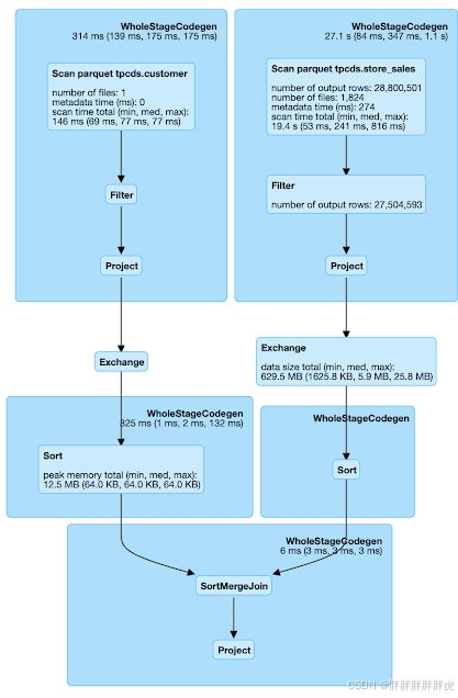

c. Sort Merge Join is chosen because Probe Table Size 16 bytes*3 > Build Table Size 16 bytes
Here we added more filters on the Build Table side(“store_sales”) to have less estimated Build Table Size.
  7. and s.ss_item_sk=456 and s.ss_hdemo_sk=789;
  2. Project [c_current_addr_sk#31, ss_sold_time_sk#45 AS c2#265], Statistics(sizeInBytes=16.0 B, rowCount=1, hints=none)
  3. +- Join Inner, (c_customer_sk#27 = ss_customer_sk#47), Statistics(sizeInBytes=24.0 B, rowCount=1, hints=none)
  7.    +- Project [ss_sold_time_sk#45, ss_customer_sk#47], Statistics(sizeInBytes=16.0 B, rowCount=1, hints=none)
  8.       +- Filter ((((isnotnull(ss_item_sk#46) && isnotnull(ss_hdemo_sk#49)) && (ss_item_sk#46 = 456)) && (ss_hdemo_sk#49 = 789)) && isnotnull(ss_customer_sk#47)), Statistics(sizeInBytes=152.0 B, rowCount=1, hints=none)
  11. *(5) Project [c_current_addr_sk#31, ss_sold_time_sk#45 AS c2#265]
  12. +- *(5) SortMergeJoin [c_customer_sk#27], [ss_customer_sk#47], Inner
  13.    :- *(2) Sort [c_customer_sk#27 ASC NULLS FIRST], false, 0
  14.    :  +- Exchange hashpartitioning(c_customer_sk#27, 2)
  15.    :     +- *(1) Project [c_customer_sk#27, c_current_addr_sk#31]
  16.    :        +- *(1) Filter ((isnotnull(c_customer_id#28) && (c_customer_id#28 = 123)) && isnotnull(c_customer_sk#27))
  17.    :           +- *(1) FileScan parquet tpcds.customer[c_customer_sk#27,c_customer_id#28,c_current_addr_sk#31] Batched: true, Format: Parquet, Location: InMemoryFileIndex[hdfs:///tpcds/customer], PartitionFilters: [], PushedFilters: [IsNotNull(c_customer_id), EqualTo(c_customer_id,123), IsNotNull(c_customer_sk)], ReadSchema: struct<c_customer_sk:int,c_customer_id:string,c_current_addr_sk:int>
  18.    +- *(4) Sort [ss_customer_sk#47 ASC NULLS FIRST], false, 0
  19.       +- Exchange hashpartitioning(ss_customer_sk#47, 2)
  20.          +- *(3) Project [ss_sold_time_sk#45, ss_customer_sk#47]
  21.             +- *(3) Filter ((((isnotnull(ss_item_sk#46) && isnotnull(ss_hdemo_sk#49)) && (ss_item_sk#46 = 456)) && (ss_hdemo_sk#49 = 789)) && isnotnull(ss_customer_sk#47))
  22.                +- *(3) FileScan parquet tpcds.store_sales[ss_sold_time_sk#45,ss_item_sk#46,ss_customer_sk#47,ss_hdemo_sk#49,ss_sold_date_sk#67] Batched: true, Format: Parquet, Location: CatalogFileIndex[hdfs:///tpcds/store_sales], PartitionCount: 1824, PartitionFilters: [], PushedFilters: [IsNotNull(ss_item_sk), IsNotNull(ss_hdemo_sk), EqualTo(ss_item_sk,456), EqualTo(ss_hdemo_sk,789)..., ReadSchema: struct<ss_sold_time_sk:int,ss_item_sk:int,ss_customer_sk:int,ss_hdemo_sk:int>

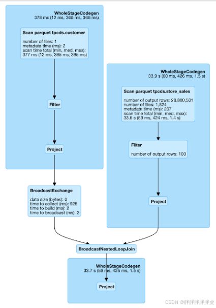

4. Broadcast Nested Loop Join (BNLJ)
Use case:
Cartesian product between a small table and large table.
Principle:
It firstly broadcast the small table to each Executor Node through Driver. And then do the local nested loop join with the partition of big table.
Since the broadcasted small table is through Driver, so the Driver’s memory should be large enough.
By default in Spark, the table/data size below 10MB(configured by spark.sql.autoBroadcastJoinThreshold) can be broadcasted.
Hints:
In Spark 2.4:
Join Selection:
The logic is explained inside : SparkStrategies.scala:
  1. * If there is no joining keys, Join implementations are chosen with the following precedence:
  2. * - BroadcastNestedLoopJoin (BNLJ):
  3. *     BNLJ supports all the join types but the impl is OPTIMIZED for the following scenarios:
  4. *     For right outer join, the left side is broadcast. For left outer, left semi, left anti
  5. *     and the internal join type ExistenceJoin, the right side is broadcast. For inner like
  6. *     joins, either side is broadcast.
  7. *
  8. *     Like BHJ, users still can specify the broadcast hint and session-based
  9. *     [[SQLConf.AUTO_BROADCASTJOIN_THRESHOLD]] threshold to impact which side is broadcast.
  10. *
  11. *     1) Broadcast the join side with the broadcast hint, even if the size is larger than

Basically it is very similar to Broadcast Hash Join, and the only difference is now we do not have any join key/condition.
Those Broadcast related hints also controls which table to be broadcasted or the smaller table will be broadcasted.
Test:
a. Broadcast Nested Loop Join is chosen and the smaller table(after Filter on “customer”) will be broadcasted.
  1. set spark.sql.crossJoin.enabled=true;
  2. explain cost select c.c_current_addr_sk,s.ss_sold_time_sk as c2 from customer c, store_sales s
  3. where  c.c_customer_id = "123"
  4. and s.ss_item_sk=456;
  2. Project [c_current_addr_sk#18, ss_sold_time_sk#32 AS c2#95], Statistics(sizeInBytes=4.6 KB, rowCount=296, hints=none)
  3. +- Join Inner, Statistics(sizeInBytes=4.6 KB, rowCount=296, hints=none)
  4.    :- Project [c_current_addr_sk#18], Statistics(sizeInBytes=12.0 B, rowCount=1, hints=none)
  5.    :  +- Filter (isnotnull(c_customer_id#15) && (c_customer_id#15 = 123)), Statistics(sizeInBytes=250.0 B, rowCount=1, hints=none)
  7.    +- Project [ss_sold_time_sk#32], Statistics(sizeInBytes=3.5 KB, rowCount=296, hints=none)
  8.       +- Filter (isnotnull(ss_item_sk#33) && (ss_item_sk#33 = 456)), Statistics(sizeInBytes=43.9 KB, rowCount=296, hints=none)
  11. *(3) Project [c_current_addr_sk#18, ss_sold_time_sk#32 AS c2#95]
  12. +- BroadcastNestedLoopJoin BuildLeft, Inner
  13.    :- BroadcastExchange IdentityBroadcastMode
  14.    :  +- *(1) Project [c_current_addr_sk#18]
  15.    :     +- *(1) Filter (isnotnull(c_customer_id#15) && (c_customer_id#15 = 123))
  16.    :        +- *(1) FileScan parquet tpcds.customer[c_customer_id#15,c_current_addr_sk#18] Batched: true, Format: Parquet, Location: InMemoryFileIndex[hdfs:///tpcds/customer], PartitionFilters: [], PushedFilters: [IsNotNull(c_customer_id), EqualTo(c_customer_id,123)], ReadSchema: struct<c_customer_id:string,c_current_addr_sk:int>
  17.    +- *(2) Project [ss_sold_time_sk#32]
  18.       +- *(2) Filter (isnotnull(ss_item_sk#33) && (ss_item_sk#33 = 456))
  19.          +- *(2) FileScan parquet tpcds.store_sales[ss_sold_time_sk#32,ss_item_sk#33,ss_sold_date_sk#54] Batched: true, Format: Parquet, Location: CatalogFileIndex[hdfs:///tpcds/store_sales], PartitionCount: 1824, PartitionFilters: [], PushedFilters: [IsNotNull(ss_item_sk), EqualTo(ss_item_sk,456)], ReadSchema: struct<ss_sold_time_sk:int,ss_item_sk:int>
Note: here we have to set spark.sql.crossJoin.enabled=true , otherwise Spark will be “smart” enough to error out:
  1. Error in query: Detected implicit cartesian product for INNER join between logical plans
  2. Join condition is missing or trivial.
  3. Either: use the CROSS JOIN syntax to allow cartesian products between these
  4. relations, or: enable implicit cartesian products by setting the configuration
  5. variable spark.sql.crossJoin.enabled=true;
b. Broadcast Nested Loop Join is chosen and the larger table(“store_sales”) will be broadcasted because we force it using hint.
In this case, the larger table size is even larger than spark.sql.autoBroadcastJoinThreshold.
  2. explain cost select /*+ BROADCAST(s) */ c.c_current_addr_sk,s.ss_sold_time_sk as c2 from customer c, store_sales s
  2. Project [c_current_addr_sk#18, ss_sold_time_sk#32 AS c2#102], Statistics(sizeInBytes=4.6 KB, rowCount=296, hints=none)
  7.    +- ResolvedHint (broadcast), Statistics(sizeInBytes=3.5 KB, rowCount=296, hints=(broadcast))
  8.       +- Project [ss_sold_time_sk#32], Statistics(sizeInBytes=3.5 KB, rowCount=296, hints=none)
  9.          +- Filter (isnotnull(ss_item_sk#33) && (ss_item_sk#33 = 456)), Statistics(sizeInBytes=43.9 KB, rowCount=296, hints=none)
  10.             +- Relation[ss_sold_time_sk#32,ss_item_sk#33,ss_customer_sk#34,ss_cdemo_sk#35,ss_hdemo_sk#36,ss_addr_sk#37,ss_store_sk#38,ss_promo_sk#39,ss_ticket_number#40L,ss_quantity#41,ss_wholesale_cost#42,ss_list_price#43,ss_sales_price#44,ss_ext_discount_amt#45,ss_ext_sales_price#46,ss_ext_wholesale_cost#47,ss_ext_list_price#48,ss_ext_tax#49,ss_coupon_amt#50,ss_net_paid#51,ss_net_paid_inc_tax#52,ss_net_profit#53,ss_sold_date_sk#54] parquet, Statistics(sizeInBytes=4.1 GB, rowCount=2.88E+7, hints=none)
  11. == Physical Plan ==
  12. *(3) Project [c_current_addr_sk#18, ss_sold_time_sk#32 AS c2#102]
  13. +- BroadcastNestedLoopJoin BuildRight, Inner
  14.    :- *(1) Project [c_current_addr_sk#18]
  17.    +- BroadcastExchange IdentityBroadcastMode
  18.       +- *(2) Project [ss_sold_time_sk#32]
  19.          +- *(2) Filter (isnotnull(ss_item_sk#33) && (ss_item_sk#33 = 456))
  20.             +- *(2) FileScan parquet tpcds.store_sales[ss_sold_time_sk#32,ss_item_sk#33,ss_sold_date_sk#54] Batched: true, Format: Parquet, Location: CatalogFileIndex[hdfs:///tpcds/store_sales], PartitionCount: 1824, PartitionFilters: [], PushedFilters: [IsNotNull(ss_item_sk), EqualTo(ss_item_sk,456)], ReadSchema: struct<ss_sold_time_sk:int,ss_item_sk:int>

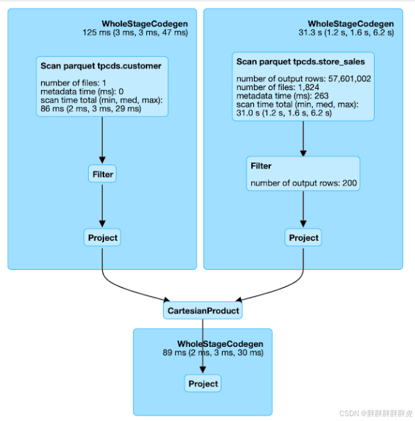

c. Cartesian Product is chosen because the there is no Broadcast related hints and both sides are larger than spark.sql.autoBroadcastJoinThreshold.
  2. set spark.sql.autoBroadcastJoinThreshold=1;
  3. explain cost select c.c_current_addr_sk,s.ss_sold_time_sk as c2 from customer c, store_sales s
  4. where  c.c_customer_id = "123"
  5. and s.ss_item_sk=456;
  2. Project [c_current_addr_sk#18, ss_sold_time_sk#32 AS c2#113], Statistics(sizeInBytes=4.6 KB, rowCount=296, hints=none)
  11. *(3) Project [c_current_addr_sk#18, ss_sold_time_sk#32 AS c2#113]
  12. +- CartesianProduct
  13.    :- *(1) Project [c_current_addr_sk#18]
  14.    :  +- *(1) Filter (isnotnull(c_customer_id#15) && (c_customer_id#15 = 123))
  15.    :     +- *(1) FileScan parquet tpcds.customer[c_customer_id#15,c_current_addr_sk#18] Batched: true, Format: Parquet, Location: InMemoryFileIndex[hdfs:///tpcds/customer], PartitionFilters: [], PushedFilters: [IsNotNull(c_customer_id), EqualTo(c_customer_id,123)], ReadSchema: struct<c_customer_id:string,c_current_addr_sk:int>
  16.    +- *(2) Project [ss_sold_time_sk#32]
  17.       +- *(2) Filter (isnotnull(ss_item_sk#33) && (ss_item_sk#33 = 456))
  18.          +- *(2) FileScan parquet tpcds.store_sales[ss_sold_time_sk#32,ss_item_sk#33,ss_sold_date_sk#54] Batched: true, Format: Parquet, Location: CatalogFileIndex[hdfs:///tpcds/store_sales], PartitionCount: 1824, PartitionFilters: [], PushedFilters: [IsNotNull(ss_item_sk), EqualTo(ss_item_sk,456)], ReadSchema: struct<ss_sold_time_sk:int,ss_item_sk:int>
