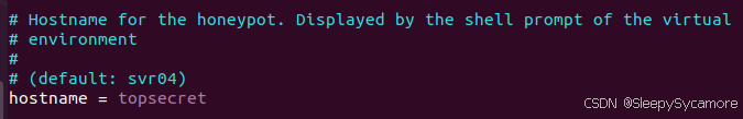

7. Edit configuration file
The configuration for Cowrie is stored in cowrie.cfg.dist and cowrie.cfg (Located in cowrie/etc). Both files are read on startup, where entries from cowrie.cfg take precedence. The .dist file can be overwritten by upgrades, cowrie.cfg will not be touched. To run with a standard configuration, there is no need to change anything.
  1. (cowrie-env):~/cowrie $ cd etc/
  2. (cowrie-env):~/cowrie/etc $ cp cowrie.cfg.dist cowrie.cfg
  3. (cowrie-env):~/cowrie/etc $ sudo vim cowrie.cfg
change the hostname first and then enable telnet using any of the editors.
