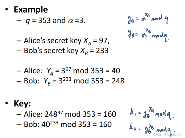

Diffie-Hellman key exchange
Based on mathematical functions and is used in confidentiality, key distribution and authentication.
The algorithm was developed to enable two users to exchange a secret key securely. The algorithm itself is limited to the exchange of keys.

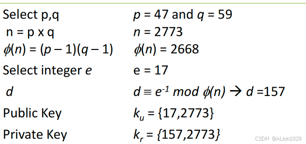

RSA public key algorithm
A trapdoor one-way function is a one-way function f, together with a secret y, such that, given f(x) and y, it is easy to compute x. The private key here is our trapdoor.
Relatively prime numbers: Relative primes are two numbers that do not have a common divisor.
Euler’s Totient function: This function gives the number of positive integers less than n and relatively prime to n. If n = pq where p and q are prime and are not equal, then ø(n) = ø(pq) =ø(p)ø(q) = (p - 1) (q - 1)

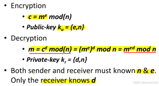

RSA algorithm
RSA is a block cipher in which the plaintext and ciphertext are integers between 0 and n-1.

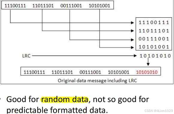

Longitudinal redundancy check (LRC)—an example for data integrity

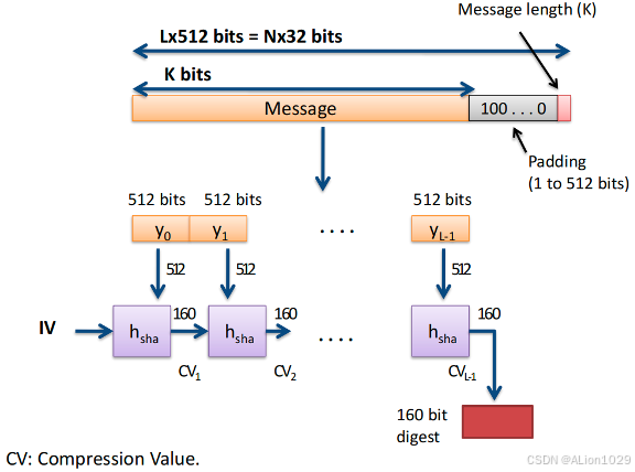

SHA1: The processing consists of: Append padding bits. Append length. Initialise MD buffer. Process message in 512-bit blocks. Output: 160 bits.
The output: Every bit of hash code is a function of every bit of the input. It is unlikely that two messages chosen at random will have the same hash code. It is infeasible to produce two different messages having the same message digest.

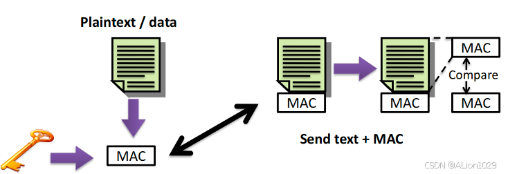

Message Authentication involves generating a small block of data (the MAC) that is appended to the message.
If the received MAC matches the calculated MAC, then the receiver is assured that the message has not been altered (integrity of the message). It is from the alleged sender (originator identity validation). If the message has a sequence number, the receiver can check it has a proper sequence.
