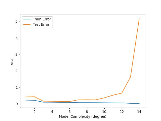

8. 可视化毛病-方差关系(效果示意)
  1. import numpy as np
  2. import matplotlib.pyplot as plt
  3. from sklearn.model_selection import train_test_split
  4. from sklearn.preprocessing import PolynomialFeatures
  5. from sklearn.linear_model import LinearRegression
  6. from sklearn.metrics import mean_squared_error
  7. # 真实函数
  8. def true_func(x):
  9.     return np.sin(2 * np.pi * x)
  10. np.random.seed(0)
  11. x = np.sort(np.random.rand(30))
  12. y = true_func(x) + np.random.normal(scale=0.3, size=x.shape)
  13. x_train, x_test, y_train, y_test = train_test_split(x, y, test_size=0.3)
  14. complexity = np.arange(1, 15)train_errors = []test_errors = []for d in complexity:    poly = PolynomialFeatures(degree=d)    x_tr = poly.fit_transform(x_train.reshape(-1, 1))    x_te = poly.transform(x_test.reshape(-1, 1))    model = LinearRegression().fit(x_tr, y_train)    train_errors.append(mean_squared_error(y_train, model.predict(x_tr)))    test_errors.append(mean_squared_error(y_test, model.predict(x_te)))plt.plot(complexity, train_errors, label='Train Error')plt.plot(complexity, test_errors, label='Test Error')plt.xlabel('Model Complexity (degree)')plt.ylabel('MSE')plt.legend()plt.show()
