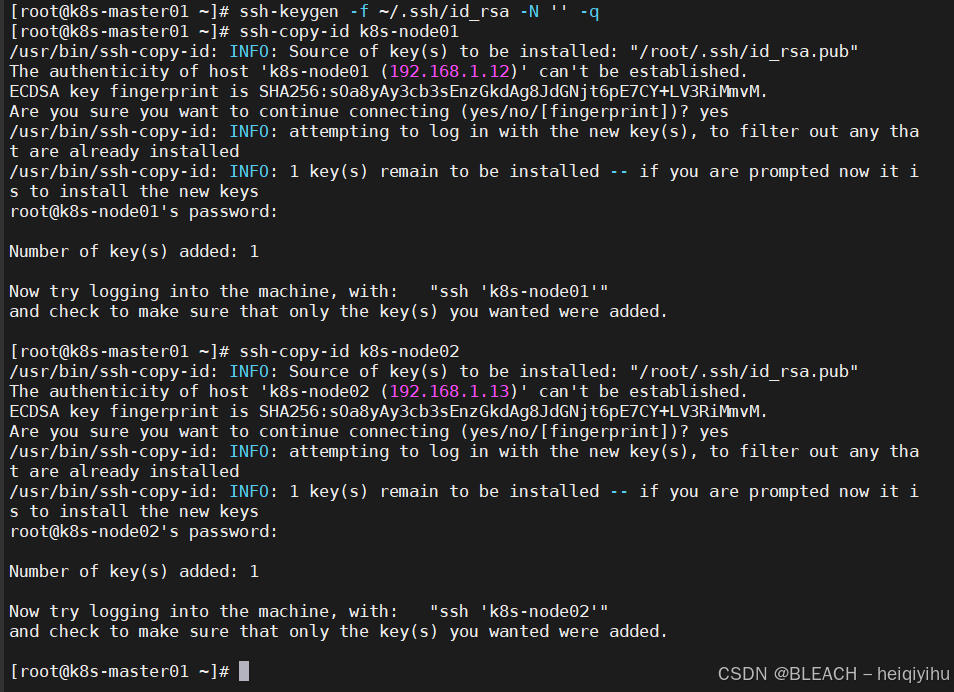

  # 设置免密登录,只在k8s-master01上操作
[root@k8s-master01 ~]# ssh-keygen -f ~/.ssh/id_rsa -N '' -q
  # 点拷贝秘钥到其他 2 台节点
[root@k8s-master01 ~]# ssh-copy-id k8s-node01
[root@k8s-master01 ~]# ssh-copy-id k8s-node02

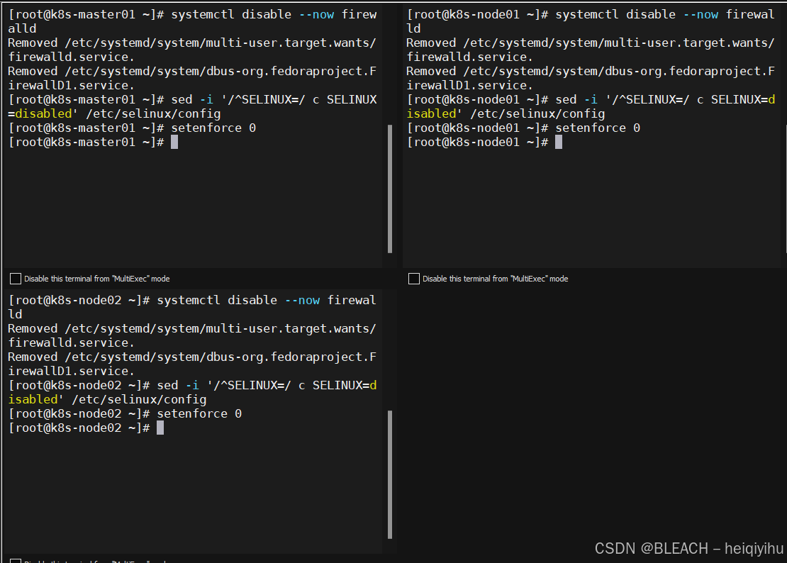

开启多执行关闭防火墙和SELinux,设置时间同步
   [root@k8s-master01 ~]#systemctl disable --now firewalld
[root@k8s-master01 ~]#sed -i '/^SELINUX=/ c SELINUX=disabled' /etc/selinux/config
[root@k8s-master01 ~]#setenforce 0
  [root@k8s-node01 ~]#systemctl disable --now firewalld
  [root@k8s-node01 ~]#sed -i '/^SELINUX=/ c SELINUX=disabled' /etc/selinux/config
  [root@k8s-node01 ~]#setenforce 0
  [root@k8s-node02 ~]#systemctl disable --now firewalld
  [root@k8s-node02 ~]#sed -i '/^SELINUX=/ c SELINUX=disabled' /etc/selinux/config
  [root@k8s-node02 ~]#setenforce 0

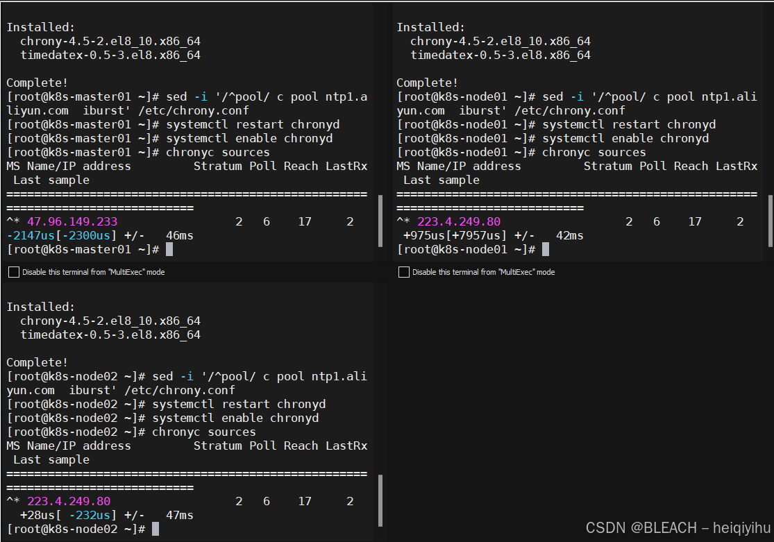

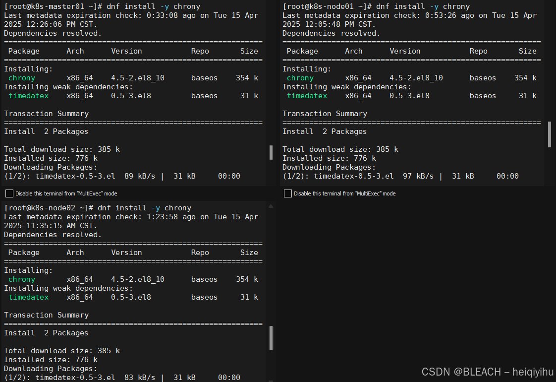

   [root@k8s-master01 ~]#dnf install -y chrony
# 修改同步服务器
[root@k8s-master01 ~]#sed -i '/^pool/ c pool ntp1.aliyun.com  iburst' /etc/chrony.conf
[root@k8s-master01 ~]#systemctl restart chronyd
[root@k8s-master01 ~]#systemctl enable chronyd
  [root@k8s-master01 ~]# chronyc sources
MS Name/IP address         Stratum Poll Reach LastRx Last sample
^* 47.96.149.233                 2   6    17     2  -2147us[-2300us] +/-   46ms

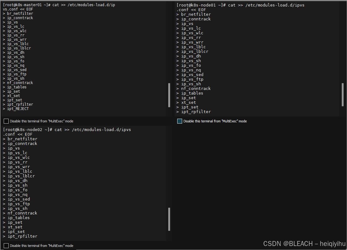

   [root@k8s-master01 ~]#cat >> /etc/modules-load.d/ipvs.conf << EOF
br_netfilter
ip_conntrack
ip_vs
ip_vs_lc
ip_vs_wlc
ip_vs_rr
ip_vs_wrr
ip_vs_lblc
ip_vs_lblcr
ip_vs_dh
ip_vs_sh
ip_vs_fo
ip_vs_nq
ip_vs_sed
ip_vs_ftp
ip_vs_sh
nf_conntrack
ip_tables
ip_set
xt_set
ipt_set
ipt_rpfilter
ipt_REJECT
ipip
EOF

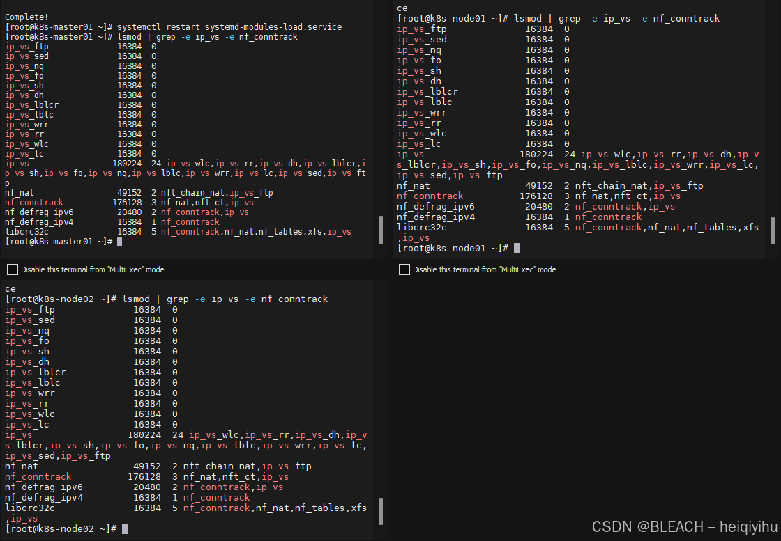

  [root@k8s-master01 ~]#dnf install ipvsadm ipset sysstat conntrack libseccomp -y
  [root@k8s-master01 ~]#systemctl restart systemd-modules-load.service

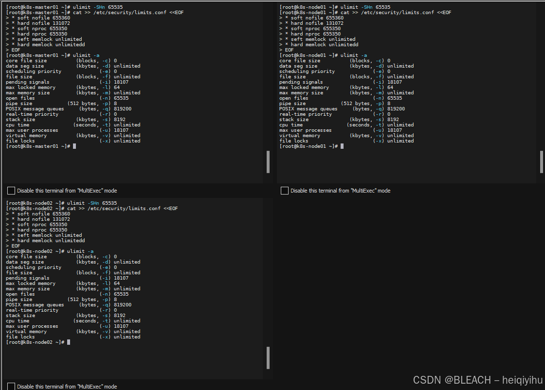

句柄数最大
   [root@k8s-master01 ~]#ulimit -SHn 65535
cat >> /etc/security/limits.conf <<EOF
* soft nofile 655360
* hard nofile 131072
* soft nproc 655350
* hard nproc 655350
* seft memlock unlimited
* hard memlock unlimitedd
EOF
查看修改结果
[root@k8s-master01 ~]#ulimit -a

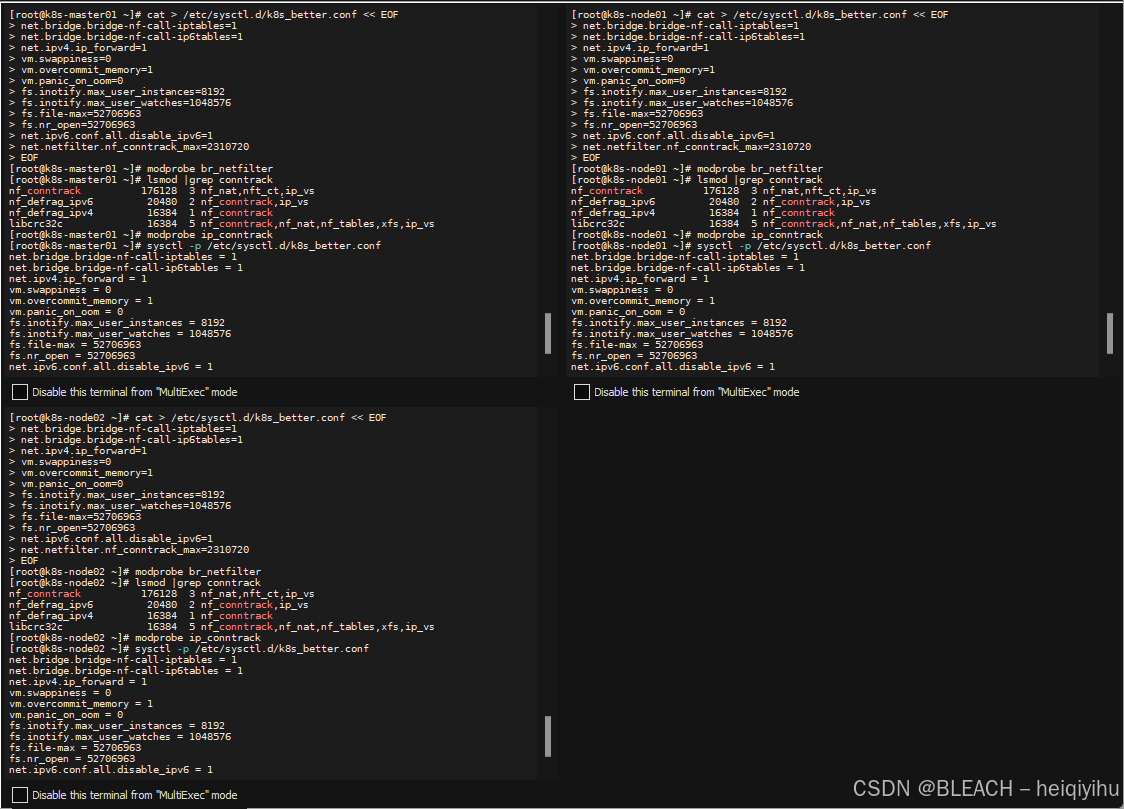

   [root@k8s-master01 ~]#cat > /etc/sysctl.d/k8s_better.conf << EOF
net.bridge.bridge-nf-call-iptables=1
net.bridge.bridge-nf-call-ip6tables=1
net.ipv4.ip_forward=1
vm.swappiness=0
vm.overcommit_memory=1
vm.panic_on_oom=0
fs.inotify.max_user_instances=8192
fs.inotify.max_user_watches=1048576
fs.file-max=52706963
fs.nr_open=52706963
net.ipv6.conf.all.disable_ipv6=1
net.netfilter.nf_conntrack_max=2310720
EOF
  [root@k8s-master01 ~]#modprobe br_netfilter
[root@k8s-master01 ~]#lsmod |grep conntrack
[root@k8s-master01 ~]#modprobe ip_conntrack
[root@k8s-master01 ~]#sysctl -p /etc/sysctl.d/k8s_better.conf

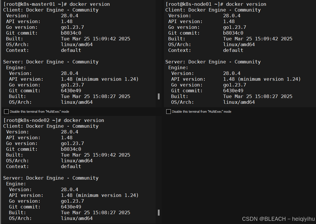

  查看docker版本
# docker version

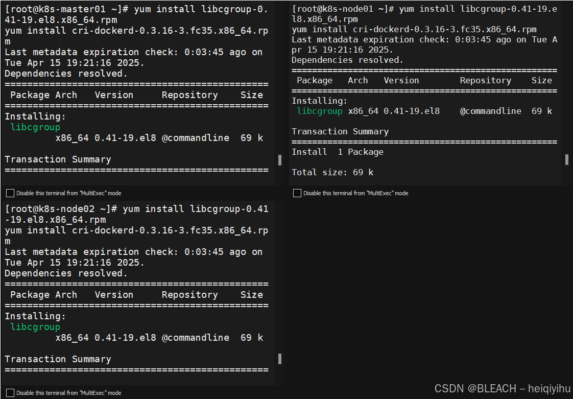

三台同时安装cri-docker
   wget -c https://github.com/Mirantis/cri-dockerd/releases/download/v0.3.16/cri-dockerd-0.3.16-3.fc35.x86_64.rpm
wget -c https://rpmfind.net/linux/almalinux/8.10/BaseOS/x86_64/os/Packages/libcgroup-0.41-19.el8.x86_64.rpm
yum install libcgroup-0.41-19.el8.x86_64.rpm
yum install cri-dockerd-0.3.16-3.fc35.x86_64.rpm

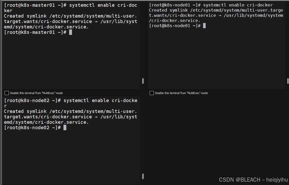

启动cri-docker服务
   systemctl enable cri-docker

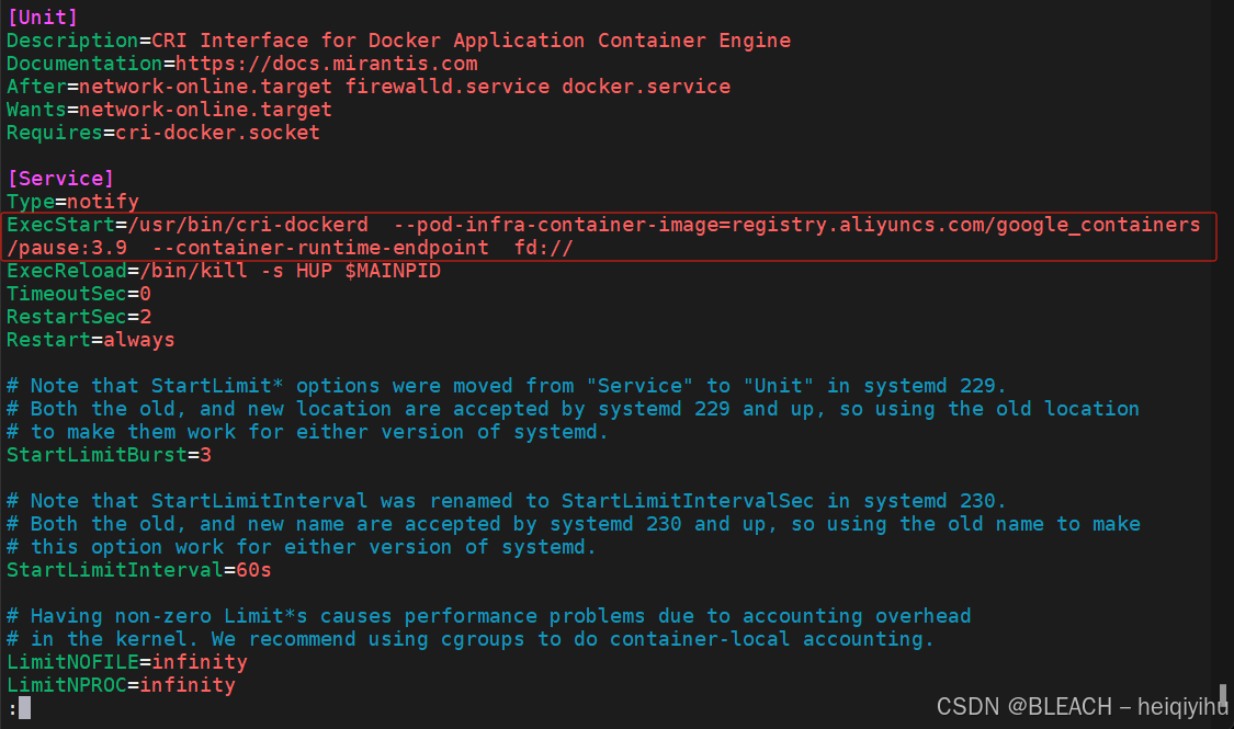

cri-dockerd设置国内镜像加速
   [root@k8s-master01 ~]#vim /usr/lib/systemd/system/cri-docker.service
  [root@k8s-node01 ~]# vim /usr/lib/systemd/system/cri-docker.service
[root@k8s-node02 ~]# vim /usr/lib/systemd/system/cri-docker.service

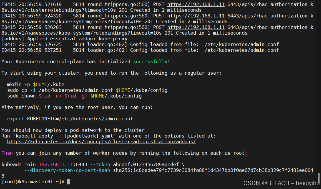

  四:K8S集群初始化
   #在master上面举行修改

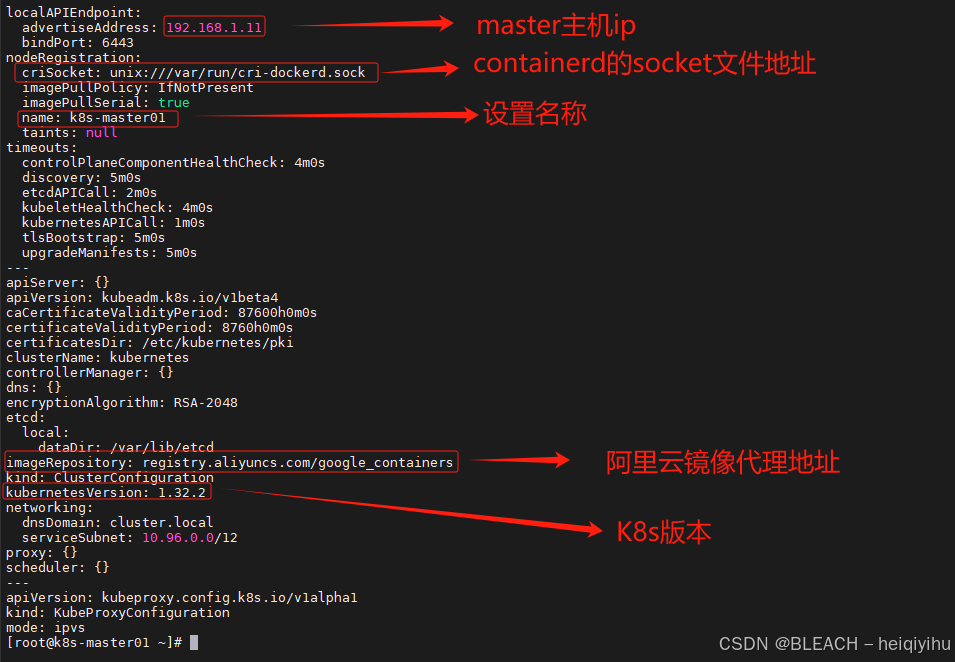

  [root@k8s-master01 ~]#kubeadm config print init-defaults > kubeadm-init.yaml
  [root@k8s-master01 ~]#vi kubeadm-init.yaml
  修改为 advertiseAddress: 192.168.1.11
  修改为 criSocket: unix:///var/run/cri-dockerd.sock
  修改为 name: k8s-master01
  修改为:imageRepository: registry.aliyuncs.com/google_containers
  修改为:kubernetesVersion: 1.32.2
    文件末尾增长启用ipvs功能
apiVersion: kubeproxy.config.k8s.io/v1alpha1
kind: KubeProxyConfiguration
mode: ipvs
   #根据设置文件启动 kubeadm 初始化 k8s
[root@k8s-master01 ~]#kubeadm init --config=kubeadm-init.yaml --upload-certs --v=6
   #master主机上
  [root@k8s-master01 ~]#mkdir -p $HOME/.kube
[root@k8s-master01 ~]#sudo cp -i /etc/kubernetes/admin.conf $HOME/.kube/config
[root@k8s-master01 ~]#sudo chown $(id -u)(id -g) $HOME/.kube/config
  [root@k8s-master01 ~]# export KUBECONFIG=/etc/kubernetes/admin.conf

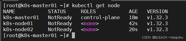

  #将node-1和node-2参加到k8s集群中
  [root@k8s-node01 ~]# kubeadm join 192.168.1.11:6443 --token abcdef.0123456789abcdef --discovery-token-ca-cert-hash sha256:1c8cadee79fc7739c3084fa08f1d4347bb0f0ae67d7cb38b329c7f2481ee0048 --cri-socket unix:///var/run/cri-dockerd.sock
  [root@k8s-node02 ~]#  kubeadm join 192.168.1.11:6443 --token abcdef.0123456789abcdef --discovery-token-ca-cert-hash sha256:1c8cadee79fc7739c3084fa08f1d4347bb0f0ae67d7cb38b329c7f2481ee0048 --cri-socket unix:///var/run/cri-dockerd.sock
    #maste查看集群
  [root@k8s-master01 ~]# kubectl get node

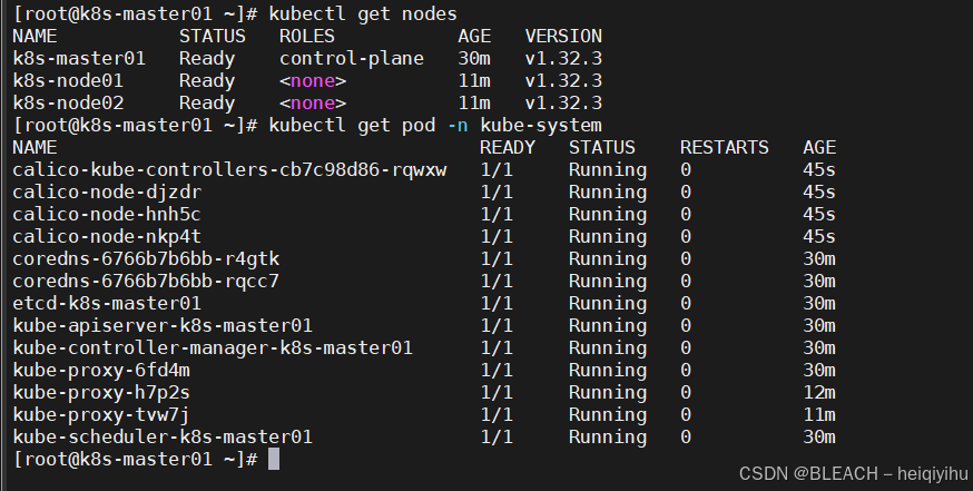

[root@k8s-master01 ~]# kubectl get pod -n kube-system
    [root@k8s-master01 ~]# kubectl get nodes
