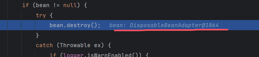

3.烧毁bean
按照先后顺序:
  1. @Component
  2. public class DestoryBeanDemo implements DisposableBean {
  3.     @Override
  4.     public void destroy() throws Exception {
  5.         System.out.println("【DisposableBean 接口】 销毁");
  6.     }
  7.     @PreDestroy
  8.     public void preDestroy(){
  9.         System.out.println("【@PreDestroy 注解】 销毁");
  10.     }
  11. }
实行容器关闭的时间,走这里
  1. public void destroy() {
  2.     if (!CollectionUtils.isEmpty(this.beanPostProcessors)) {
  3.         for (DestructionAwareBeanPostProcessor processor : this.beanPostProcessors) {
  4.             // 1.@PreDestroy 注解方法
  5.             processor.postProcessBeforeDestruction(this.bean, this.beanName);
  6.         }
  7.     }
  8.     ...
  9.     //2.DisposableBean接口
  10.     ((DisposableBean) this.bean).destroy();
  11.     ....
  12.     //3.自定义 destroy-method
  13.     invokeCustomDestroyMethod
  14. }
