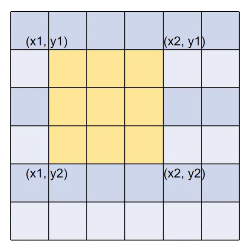

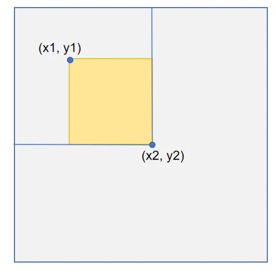

二维前缀和
S黄= S[x2,y2] - S[x1-1, y2] - S[x2, y1-1] + S[x1-1, y1-1]
  1. 如何求S[i, j]?
  2. for(i:1~n)
  3.         for(j:1~m)
  4.                 S[i, j] = a[i, j] + S[i-1, j] + S[i, j-1] - S[i-1,j-1]
