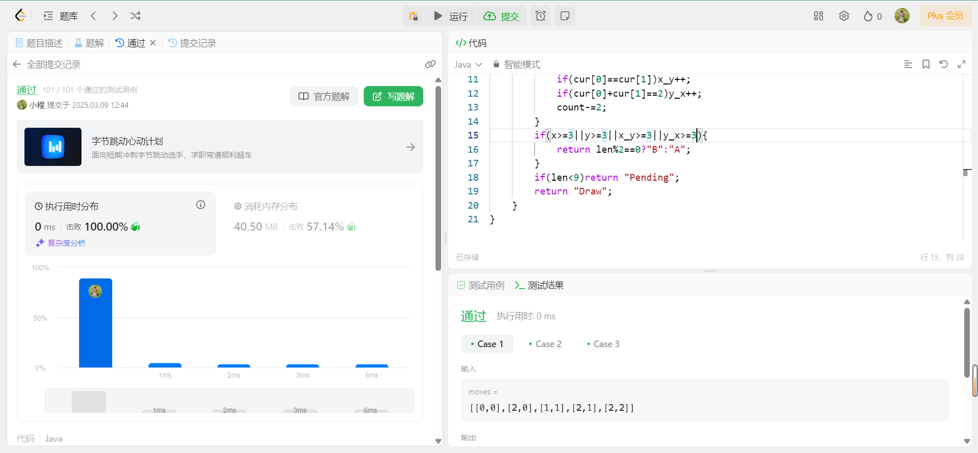

class Solution { public String tictactoe(int[][] moves) { int len = moves.length; int[] dp = moves[len - 1]; int x = 0, y = 0, x_y = 0, y_x = 0;
int count = len - 1; while (count >= 0) { int[] cur = moves[count]; if (cur[1] == dp[1]) x++; if (cur[0] == dp[0]) y++; if (cur[0] == cur[1]) x_y++; if (cur[0] + cur[1] == 2) y_x++; count -= 2; } if (x >= 3 || y >= 3 || x_y >= 3 || y_x >= 3) { return len % 2 == 0 ? "B"
: "A"
; } if (len < 9) return "Pending"; return "Draw"
: "A"
通过遍历和统计,能够高效地判断井字棋游戏的胜负环境。
