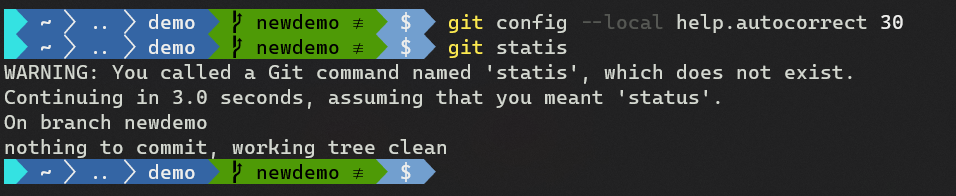

2.5.3 设置自动更正

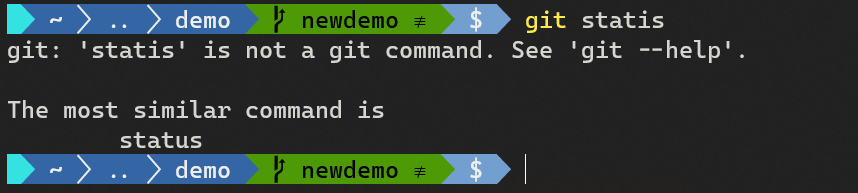

出现笔误时 git 会自动提示:
可以设置自动更正的时间隔断,单元 厘秒(0.1秒):
  1. $ git config help.autocorrect 5
  2. $ git statis
  3. WARNING: You called a Git command named 'statis', which does not exist.
  4. Continuing under the assumption that you meant 'status'
  5. in 0.5 seconds automatically...
  6. # On branch master
  7. # Changes to be committed:
  8. #   (use "git reset HEAD <file>..." to unstage)
  9. #
  10. #       modified:   another-file.txt
  11. #
实测效果:(设为 3 秒后自动更正)

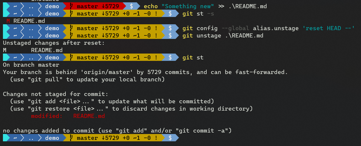

新增自定义别名:让某文件取消暂存
  1. # pattern: git unstage <FILE>...
  2. $ git config --global alias.unstage 'reset HEAD --'
  3. # Test
  4. $ echo "Something new" >> .\README.md
  5. $ git unstage .\README.md
  6. Unstaged changes after reset:
  7. M       README.md
  8. $ git unstage .\README.md
  9. Unstaged changes after reset:
  10. M       README.md
  11. $ git st
  12. On branch master
  13. Your branch is behind 'origin/master' by 5729 commits, and can be fast-forwarded.
  14.   (use "git pull" to update your local branch)
  15. Changes not staged for commit:
  16.   (use "git add <file>..." to update what will be committed)
  17.   (use "git restore <file>..." to discard changes in working directory)
  18.         modified:   README.md
  19. no changes added to commit (use "git add" and/or "git commit -a")
实测截图:

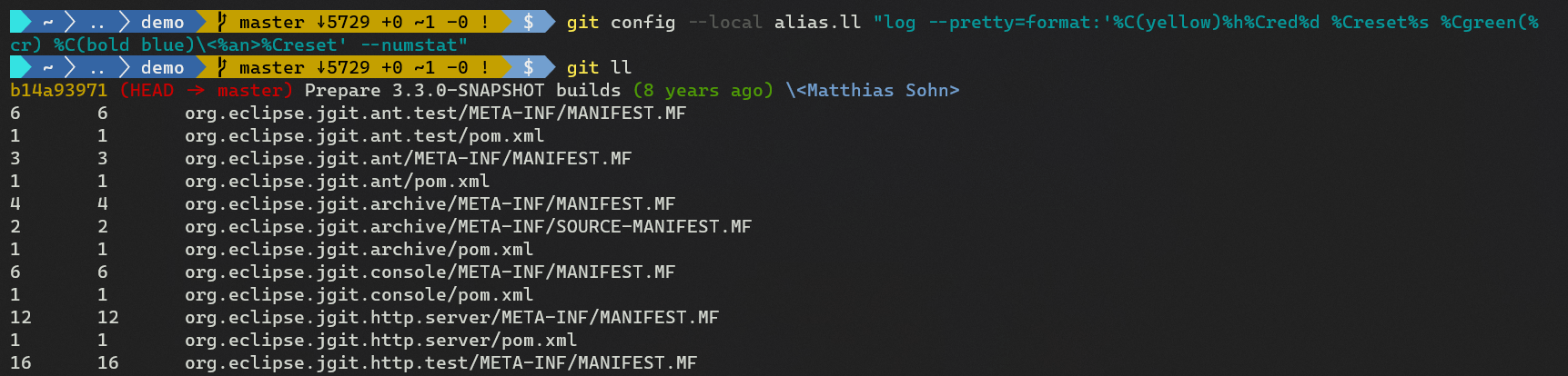

更常见的是将自定义的 git 格式化后的日志形式存为一个别名:
  1. $ git config --global alias.ll "log --pretty=format:'%C(yellow)%h%Cred%d %Creset%s %Cgreen(%cr) %C(bold blue)<%an>%Creset' --numstat"
实测效果:

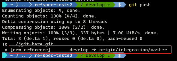

示例三:设置推送到远程堆栈的默认远程分支名称
添加默认推送名称:
  1. [remote "origin"]
  2.   url = ../jgit-bare.git
  3.   fetch = +refs/heads/master:refs/remotes/origin/master
  4.   fetch = +refs/heads/stable/*:refs/remotes/origin/stable/*
  5.   push = refs/heads/develop:refs/remotes/origin/integration/master
创建本地分支并提交一个新版本:
  1. # Create local branch 'develop', then add one commit
  2. $ git checkout -b develop
  3. Switched to a new branch 'develop'
  4. $ echo "This is the developer setup, read carefully" > readme-dev.txt
  5. $ git add readme-dev.txt
  6. $ git commit -m "adds readme file for developers"
推送到远程分支(确认是否默认推送至 integration/master 分支):
  1. $ git push
实测结果:
