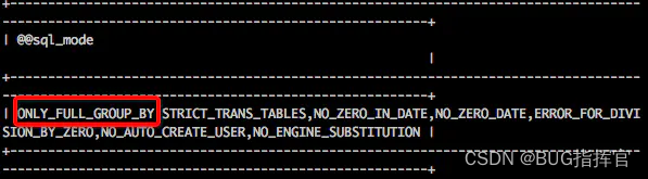

  1. mysql> SET GLOBAL sql_mode=(SELECT REPLACE(@@sql_mode,'ONLY_FULL_GROUP_BY',''));
  2. mysql> SELECT @@GLOBAL.sql_mode;
  3. +---------------------------------------------------------------+
  4. | @@GLOBAL.sql_mode                                            |
  5. +---------------------------------------------------------------+
  6. | STRICT_TRANS_TABLES,NO_ENGINE_SUBSTITUTION |
  7. +---------------------------------------------------------------+
如许上面的报错标题正常应该得到解决。
