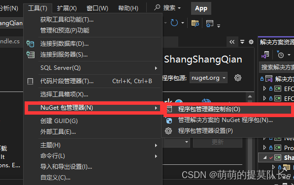

打开步伐包管理窗口
工具=>NuGet包管理器=>步伐包管理控制台

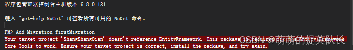

输入命令:
  1. Add-Migration firstMigration

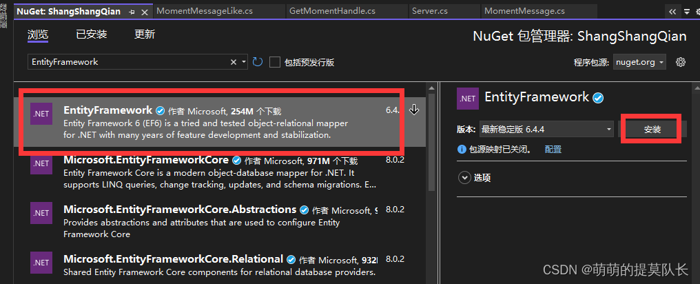

但是大概会报错,提示EntityFramework的步伐包未安装
Your target project 'ShangShangQian' doesn't reference EntityFramework. This package is required for the Entity Framework Core Tools to work. Ensure your target project is correct, install the package, and try again.

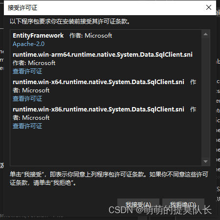

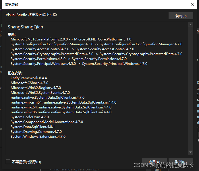

NuGet安装下
安装完毕,再实验Add-Migration firstMigration

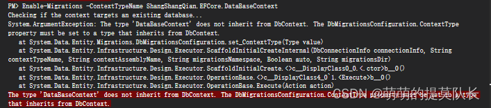

Checking if the context targets an existing database...
System.ArgumentException: The type 'DataBaseContext' does not inherit from DbContext. The DbMigrationsConfiguration.ContextType property must be set to a type that inherits from DbContext
The type 'DataBaseContext' does not inherit from DbContext. The DbMigrationsConfiguration.ContextType property must be set to a type that inherits from DbContext.
正在检查上下文是否以现有数据库为目的。。。
系统ArgumentException:范例“DataBaseContext”不是从DbContext继承的。DbMigrationsConfiguration。ContextType属性必须设置为从DbContext继承的范例。
继承了啊,奇了怪了…………

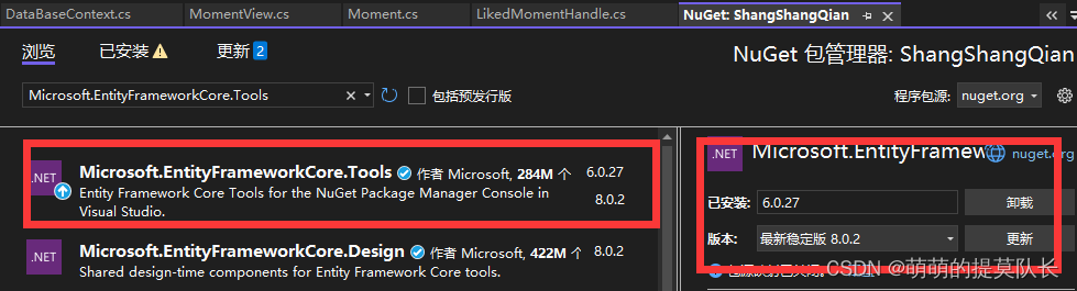

Goole下=>缺个 Microsoft.EntityFrameworkCore.Tools 装下
再实验添加启用迁徙命令:

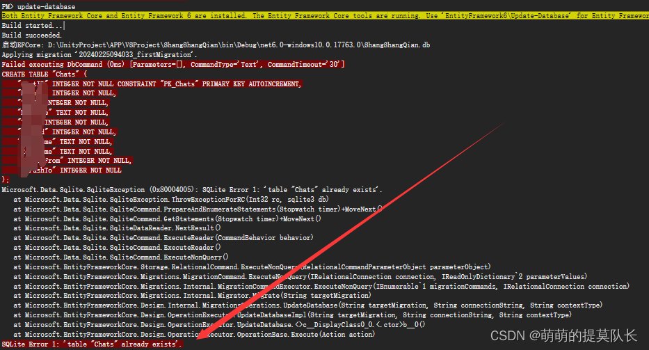

表模型变更,实验这俩行,去测试下 把表和字段增长·删除·试试,哦 报错了……
Failed executing DbCommand (0ms) [Parameters=[], CommandType='Text', CommandTimeout='30']
CREATE TABLE "Chats" (
    "ChatID" INTEGER NOT NULL CONSTRAINT "K_Chats" PRIMARY KEY AUTOINCREMENT,
    "FromID" INTEGER NOT NULL,
    "ToID" INTEGER NOT NULL,
    "Message" TEXT NOT NULL,
    "Type" INTEGER NOT NULL,
    "IsRead" INTEGER NOT NULL,
    "SendTime" TEXT NOT NULL,
    "ReadTime" TEXT NOT NULL,
    "IsPushFrom" INTEGER NOT NULL,
    "IsPushTo" INTEGER NOT NULL
 SQLite Error 1: 'table "Chats" already exists'.
为啥实验更新数据库要创建表呢,db已经存在了啊
又坑了我半天……就这样半个世纪已往了
不要悲观,猛补各种教学,原来是流程问题

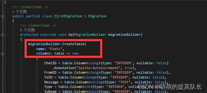

问题出在EnsureCreatedAsync这个函数上
首次实验Add-Migration firstMigration命令,天生的迁徙文件全是创建指令
再实验update-database
会实验创建表的命令,
但是之前通过EnsureCreatedAsync函数创建db数据库,已有表
所以报错,把db 与函数删除就可以了
创建数据库应由数据库迁徙命令完成 update database
再此实验就可以
