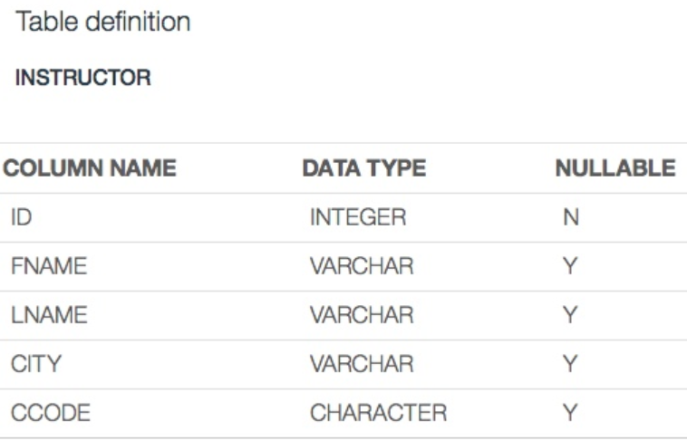

Task 2: Create a table in the database
In this step we will create a table in the database with following details:
Before creating a table, let's first check if the table already exists or not. To drop the table from a database, use the DROP query. A cursor is an object that helps execute the query and fetch the records from the database.

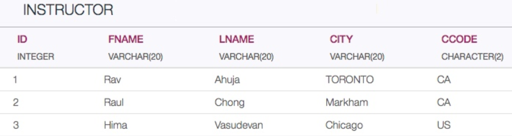

Task 3: Insert data into the table
In this step we will insert some rows of data into the table.
The INSTRUCTOR table we created in the previous step contains 3 rows of data:
We will start by inserting just the first row of data, i.e. for instructor Rav Ahuja
