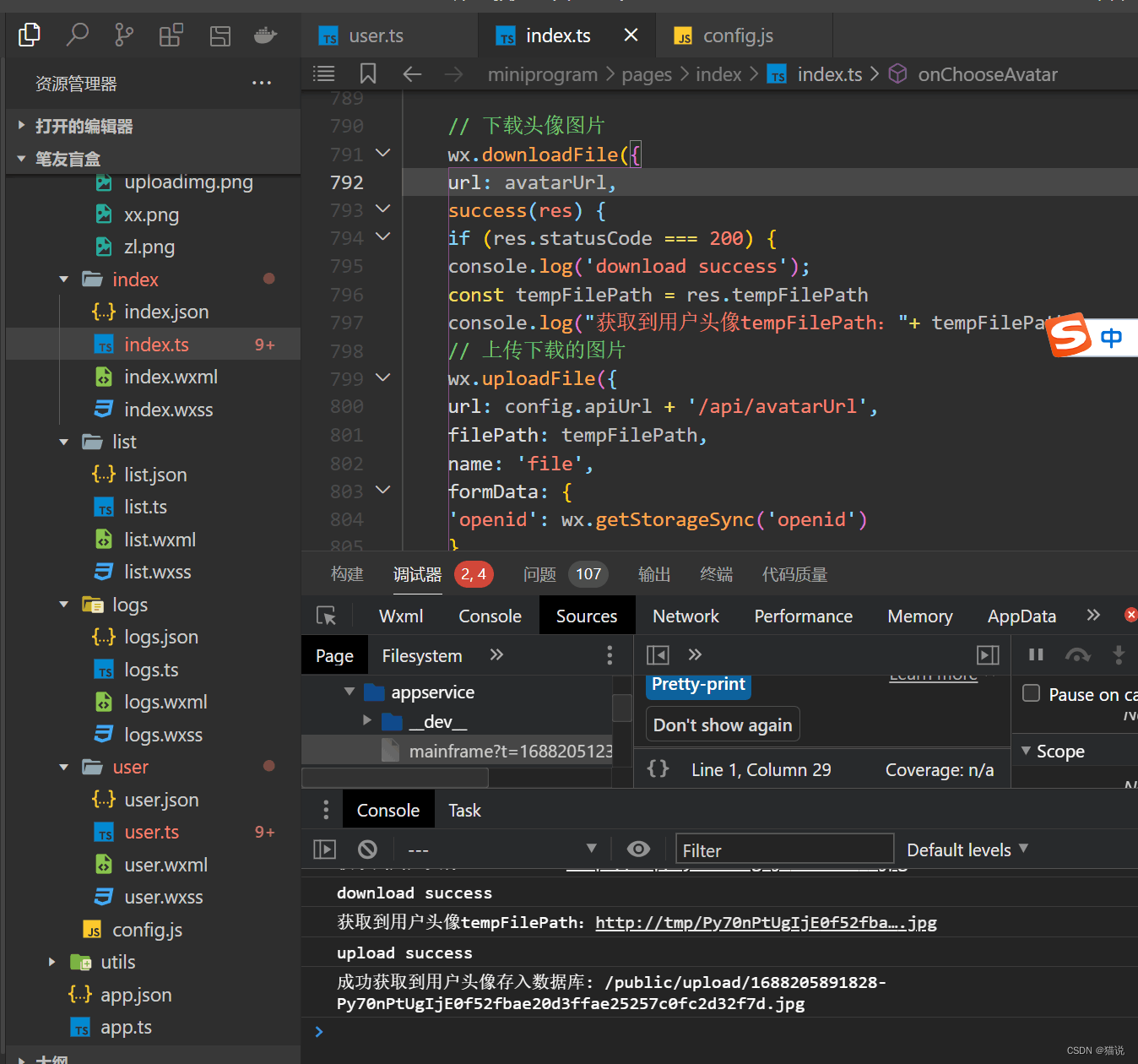

接下来是第二次修改的,微信开发者工具在本地测试没有问题:
微信小程序通过授权获取用户头像的wxml代码如下:
  1.     <view data-weui-theme="{{theme}}" class="view-2">
  2.    <button class="avatar-wrapper" open-type="chooseAvatar" bind:chooseavatar="onChooseAvatar"  value='{{avatarUrl}}'>
  3.    <view>
  4.     <image class="avatar" src="{{avatarUrl}}"></image>
  5.    </view>
  6.   </button>
对应的微信小程序TS代码如下:
  1. onChooseAvatar(e) {
  2.     const { avatarUrl } = e.detail
  3.     this.setData({
  4.     avatarUrl,
  5.     })
  6.     console.log("获取到用户头像avatarUrl:"+ avatarUrl)
  7.     // 下载头像图片
  8.     wx.downloadFile({
  9.     url: avatarUrl,
  10.     success(res) {
  11.     if (res.statusCode === 200) {
  12.     console.log('download success');
  13.     const tempFilePath = res.tempFilePath
  14.     console.log("获取到用户头像tempFilePath:"+ tempFilePath)
  15.     // 上传下载的图片
  16.     wx.uploadFile({
  17.     url: config.apiUrl + '/api/avatarUrl',
  18.     filePath: tempFilePath,
  19.     name: 'file',
  20.     formData: {
  21.     'openid': wx.getStorageSync('openid')
  22.     },
  23.     success(res) {
  24.     const data = JSON.parse(res.data)
  25.     console.log('upload success');
  26.     console.log("成功获取到用户头像存入数据库:", data.path);
  27.     },
  28.     fail(res) {
  29.     console.log('upload fail');
  30.     }
  31.     })
  32.     }
  33.     }
  34.     })
  35.     },
以nodejs为配景生存头像到mysql数据库的路由代码如下:
  1. const express = require('express');
  2. const router = express.Router();
  3. const sql = require('../sql');
  4. const multer = require('multer');
  5. // 设置文件上传的目录
  6. const storage = multer.diskStorage({
  7.     destination: function(req, file, cb) {
  8.         cb(null, './public/upload')
  9.     },
  10.     filename: function(req, file, cb) {
  11.         cb(null, Date.now() + '-' + file.originalname)
  12.     }
  13. })
  14. const upload = multer({ storage: storage })
  15. router.post('/avatarUrl', upload.single('file'), (req, res) => {
  16.     const openid = req.body.openid;
  17.     const avatarUrl = '/upload/' + req.file.filename;
  18. // 创建MySQL查询
  19.     const sqlStr = 'SELECT * FROM wxusers WHERE openid = ?';
  20. // 查询数据库
  21.     sql.query(sqlStr, [openid], function(err, result) {
  22.         if (err) {
  23.             console.error(err);
  24.             res.status(500).send('Database error');
  25.         } else {
  26. // 检查是否有匹配的openId
  27.             if (result.length > 0) {
  28.                 const sqlStr = `UPDATE wxusers SET avatarUrl = '${avatarUrl}' WHERE openid = '${openid}'`;
  29.                 sql.query(sqlStr, (err, result) => {
  30.                     if (err) throw err;
  31.                     res.json({ path: avatarUrl });
  32.                 });
  33.                 console.log("更新新路径", avatarUrl);
  34.             } else {
  35.                 const sqlStr = `INSERT INTO wxusers (openid, avatarUrl) VALUES ('${openid}','${avatarUrl}')`;
  36.                 sql.query(sqlStr, [openid, avatarUrl], (err, result) => {
  37.                     if (err) throw err;
  38.                     res.json({ path: avatarUrl });
  39.                 });
  40.                 console.log("插入新路径", avatarUrl);
  41.             }
  42.         }
  43.     });
  44. });
  45. module.exports = router;
本地运行后微信开发者表现下面的内容:
