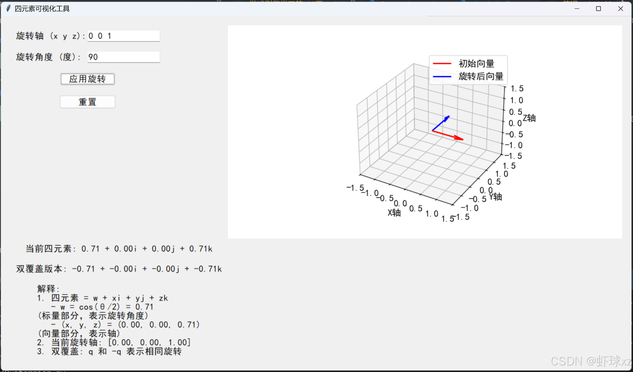

  1. import numpy as np
  2. import tkinter as tk
  3. from tkinter import ttk
  4. import matplotlib.pyplot as plt
  5. from mpl_toolkits.mplot3d import Axes3D
  6. from matplotlib.backends.backend_tkagg import FigureCanvasTkAgg
  7. # 设置支持中文的字体并放大
  8. plt.rcParams['font.sans-serif'] = ['SimHei']
  9. plt.rcParams['axes.unicode_minus'] = False
  10. plt.rcParams['font.size'] = 14
  11. # 四元素类
  12. class Quaternion:
  13.     def __init__(self, w, x, y, z):
  14.         self.w = w
  15.         self.x = x
  16.         self.y = y
  17.         self.z = z
  18.
  19.     def __str__(self):
  20.         return f"{self.w:.2f} + {self.x:.2f}i + {self.y:.2f}j + {self.z:.2f}k"
  21.
  22.     def multiply(self, other):
  23.         w1, x1, y1, z1 = self.w, self.x, self.y, self.z
  24.         w2, x2, y2, z2 = other.w, other.x, other.y, other.z
  25.         w = w1 * w2 - x1 * x2 - y1 * y2 - z1 * z2
  26.         x = w1 * x2 + x1 * w2 + y1 * z2 - z1 * y2
  27.         y = w1 * y2 - x1 * z2 + y1 * w2 + z1 * x2
  28.         z = w1 * z2 + x1 * y2 - y1 * x2 + z1 * w2
  29.         return Quaternion(w, x, y, z)
  30.
  31.     def conjugate(self):
  32.         return Quaternion(self.w, -self.x, -self.y, -self.z)
  33.
  34.     def rotate_vector(self, vector):
  35.         p = Quaternion(0, vector[0], vector[1], vector[2])
  36.         q_conj = self.conjugate()
  37.         result = self.multiply(p).multiply(q_conj)
  38.         return np.array([result.x, result.y, result.z])
  39. # 创建四元素
  40. def create_quaternion(axis, angle_deg):
  41.     angle_rad = np.radians(angle_deg)
  42.     w = np.cos(angle_rad / 2)
  43.     s = np.sin(angle_rad / 2)
  44.     norm = np.sqrt(sum(a**2 for a in axis))
  45.     if norm == 0:
  46.         return Quaternion(1, 0, 0, 0)
  47.     x, y, z = [a / norm * s for a in axis]
  48.     return Quaternion(w, x, y, z)
  49. # 可视化工具类
  50. class QuaternionVisualizer:
  51.     def __init__(self, root):
  52.         self.root = root
  53.         self.root.title("四元素可视化工具")
  54.         self.root.geometry("900x700")
  55.
  56.         # 设置全局字体
  57.         self.font_large = ('SimHei', 14)
  58.
  59.         # 初始向量
  60.         self.initial_vector = np.array([1, 0, 0])
  61.         self.rotated_vector = self.initial_vector.copy()
  62.         self.current_q = Quaternion(1, 0, 0, 0)
  63.
  64.         # 主框架
  65.         self.frame = ttk.Frame(root, padding="20")
  66.         self.frame.grid(row=0, column=0, sticky=(tk.W, tk.E, tk.N, tk.S))
  67.
  68.         # 设置行列权重
  69.         self.root.grid_rowconfigure(0, weight=1)
  70.         self.root.grid_columnconfigure(0, weight=1)
  71.         self.frame.grid_rowconfigure(0, weight=1)
  72.         self.frame.grid_columnconfigure(2, weight=1)
  73.         # 输入区域(左侧)
  74.         self.input_frame = ttk.Frame(self.frame)
  75.         self.input_frame.grid(row=0, column=0, sticky=(tk.W, tk.N, tk.S), padx=10)
  76.
  77.         ttk.Label(self.input_frame, text="旋转轴 (x y z):", font=self.font_large).grid(row=0, column=0, sticky=tk.W, pady=10)
  78.         self.axis_entry = ttk.Entry(self.input_frame, width=15, font=self.font_large)
  79.         self.axis_entry.grid(row=0, column=1, sticky=(tk.W, tk.E), pady=10)
  80.         self.axis_entry.insert(0, "0 0 1")
  81.         ttk.Label(self.input_frame, text="旋转角度 (度):", font=self.font_large).grid(row=1, column=0, sticky=tk.W, pady=10)
  82.         self.angle_entry = ttk.Entry(self.input_frame, width=15, font=self.font_large)
  83.         self.angle_entry.grid(row=1, column=1, sticky=(tk.W, tk.E), pady=10)
  84.         self.angle_entry.insert(0, "90")
  85.         ttk.Button(self.input_frame, text="应用旋转", command=self.apply_rotation, style='Large.TButton').grid(row=2, column=0, columnspan=2, pady=10)
  86.         ttk.Button(self.input_frame, text="重置", command=self.reset, style='Large.TButton').grid(row=3, column=0, columnspan=2, pady=10)
  87.         # 四元素信息(中部)
  88.         self.info_frame = ttk.Frame(self.frame)
  89.         self.info_frame.grid(row=3, column=0, sticky=(tk.W, tk.N, tk.S), padx=10)
  90.
  91.         self.q_label = ttk.Label(self.info_frame, text="当前四元素: 1.00 + 0.00i + 0.00j + 0.00k", font=self.font_large)
  92.         self.q_label.grid(row=4, column=0, pady=10)
  93.
  94.         self.double_cover_label = ttk.Label(self.info_frame, text="双覆盖版本: -1.00 + 0.00i + 0.00j + 0.00k", font=self.font_large)
  95.         self.double_cover_label.grid(row=5, column=0, pady=10)
  96.
  97.         self.explain_label = ttk.Label(self.info_frame, text="解释: 未旋转状态", font=self.font_large, wraplength=400)
  98.         self.explain_label.grid(row=6, column=0, pady=10)
  99.         # Matplotlib 嵌入(右侧)
  100.         self.fig = plt.Figure(figsize=(7, 7))
  101.         self.ax = self.fig.add_subplot(111, projection='3d')
  102.         self.canvas = FigureCanvasTkAgg(self.fig, master=self.frame)
  103.         self.canvas.get_tk_widget().grid(row=0, column=2, sticky=(tk.W, tk.E, tk.N, tk.S))
  104.         # 绑定窗口大小变化事件
  105.         self.root.bind("<Configure>", self.on_resize)
  106.
  107.         # 自定义按钮样式
  108.         style = ttk.Style()
  109.         style.configure('Large.TButton', font=self.font_large)
  110.
  111.         # 初次绘制
  112.         self.update_plot()
  113.         self.last_width = self.root.winfo_width()
  114.         self.last_height = self.root.winfo_height()
  115.     def update_plot(self):
  116.         self.ax.clear()
  117.         self.ax.quiver(0, 0, 0, self.initial_vector[0], self.initial_vector[1], self.initial_vector[2],
  118.                        color='r', label='初始向量', linewidth=2)
  119.         self.ax.quiver(0, 0, 0, self.rotated_vector[0], self.rotated_vector[1], self.rotated_vector[2],
  120.                        color='b', label='旋转后向量', linewidth=2)
  121.         self.ax.set_xlim([-1.5, 1.5])
  122.         self.ax.set_ylim([-1.5, 1.5])
  123.         self.ax.set_zlim([-1.5, 1.5])
  124.         self.ax.set_xlabel('X轴')
  125.         self.ax.set_ylabel('Y轴')
  126.         self.ax.set_zlabel('Z轴')
  127.         self.ax.legend()
  128.         self.canvas.draw()
  129.     def on_resize(self, event):
  130.         # 避免初始调整和重复绘制
  131.         if event.widget == self.root:
  132.             new_width = event.width
  133.             new_height = event.height
  134.             if new_width != self.last_width or new_height != self.last_height:
  135.                 # 只调整图形大小,不重绘内容
  136.                 dpi = self.fig.dpi
  137.                 self.fig.set_size_inches((new_width * 0.5) / dpi, (new_height * 0.8) / dpi)
  138.                 self.canvas.draw()  # 只更新画布,不重新生成视图
  139.                 self.last_width = new_width
  140.                 self.last_height = new_height
  141.     def apply_rotation(self):
  142.         try:
  143.             axis = [float(x) for x in self.axis_entry.get().split()]
  144.             if len(axis) != 3:
  145.                 raise ValueError("轴必须是3个数字")
  146.             angle = float(self.angle_entry.get())
  147.         except ValueError as e:
  148.             tk.messagebox.showerror("输入错误", f"无效输入: {e}")
  149.             return
  150.
  151.         q = create_quaternion(axis, angle)
  152.         self.current_q = q.multiply(self.current_q)
  153.         self.rotated_vector = self.current_q.rotate_vector(self.initial_vector)
  154.
  155.         self.q_label.config(text=f"当前四元素: {self.current_q}")
  156.         self.double_cover_label.config(text=f"双覆盖版本: {Quaternion(-self.current_q.w, -self.current_q.x, -self.current_q.y, -self.current_q.z)}")
  157.
  158.         norm_axis = np.array(axis) / np.sqrt(sum(a**2 for a in axis))
  159.         explain_text = (
  160.             f"解释:\n"
  161.             f"1. 四元素 = w + xi + yj + zk\n"
  162.             f"   - w = cos(θ/2) = {self.current_q.w:.2f} (标量部分,表示旋转角度)\n"
  163.             f"   - (x, y, z) = ({self.current_q.x:.2f}, {self.current_q.y:.2f}, {self.current_q.z:.2f}) (向量部分,表示轴)\n"
  164.             f"2. 当前旋转轴: [{norm_axis[0]:.2f}, {norm_axis[1]:.2f}, {norm_axis[2]:.2f}]\n"
  165.             f"3. 双覆盖: q 和 -q 表示相同旋转"
  166.         )
  167.         self.explain_label.config(text=explain_text)
  168.
  169.         self.update_plot()
  170.     def reset(self):
  171.         self.current_q = Quaternion(1, 0, 0, 0)
  172.         self.rotated_vector = self.initial_vector.copy()
  173.
  174.         self.axis_entry.delete(0, tk.END)
  175.         self.axis_entry.insert(0, "0 0 1")
  176.         self.angle_entry.delete(0, tk.END)
  177.         self.angle_entry.insert(0, "90")
  178.
  179.         self.q_label.config(text="当前四元素: 1.00 + 0.00i + 0.00j + 0.00k")
  180.         self.double_cover_label.config(text="双覆盖版本: -1.00 + 0.00i + 0.00j + 0.00k")
  181.         self.explain_label.config(text="解释: 未旋转状态")
  182.
  183.         self.update_plot()
  184. # 启动工具
