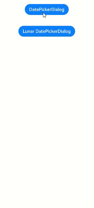

示例
  1. // xxx.ets
  2. @Entry
  3. @Component
  4. struct DatePickerDialogExample {
  5.   selectedDate: Date = new Date("2010-1-1")
  6.   build() {
  7.     Column() {
  8.       Button("DatePickerDialog")
  9.         .margin(20)
  10.         .onClick(() => {
  11.           DatePickerDialog.show({
  12.             start: new Date("2000-1-1"),
  13.             end: new Date("2100-12-31"),
  14.             selected: this.selectedDate,
  15.             showTime:true,
  16.             useMilitaryTime:false,
  17.             disappearTextStyle: {color: Color.Pink, font: {size: '22fp', weight: FontWeight.Bold}},
  18.             textStyle: {color: '#ff00ff00', font: {size: '18fp', weight: FontWeight.Normal}},
  19.             selectedTextStyle: {color: '#ff182431', font: {size: '14fp', weight: FontWeight.Regular}},
  20.             onDateAccept: (value: Date) => {
  21.               // 通过Date的setFullYear方法设置按下确定按钮时的日期,这样当弹窗再次弹出时显示选中的是上一次确定的日期
  22.               this.selectedDate = value
  23.               console.info("DatePickerDialog:onDateAccept()" + value.toString())
  24.             },
  25.             onCancel: () => {
  26.               console.info("DatePickerDialog:onCancel()")
  27.             },
  28.             onDateChange: (value: Date) => {
  29.               console.info("DatePickerDialog:onDateChange()" + value.toString())
  30.             }
  31.           })
  32.         })
  33.       Button("Lunar DatePickerDialog")
  34.         .margin(20)
  35.         .onClick(() => {
  36.           DatePickerDialog.show({
  37.             start: new Date("2000-1-1"),
  38.             end: new Date("2100-12-31"),
  39.             selected: this.selectedDate,
  40.             lunar: true,
  41.             disappearTextStyle: {color: Color.Pink, font: {size: '22fp', weight: FontWeight.Bold}},
  42.             textStyle: {color: '#ff00ff00', font: {size: '18fp', weight: FontWeight.Normal}},
  43.             selectedTextStyle: {color: '#ff182431', font: {size: '14fp', weight: FontWeight.Regular}},
  44.             onDateAccept: (value: Date) => {
  45.               this.selectedDate = value
  46.               console.info("DatePickerDialog:onDateAccept()" + value.toString())
  47.             },
  48.             onCancel: () => {
  49.               console.info("DatePickerDialog:onCancel()")
  50.             },
  51.             onDateChange: (value: Date) => {
  52.               console.info("DatePickerDialog:onDateChange()" + value.toString())
  53.             }
  54.           })
  55.         })
  56.     }.width('100%')
  57.   }
  58. }
