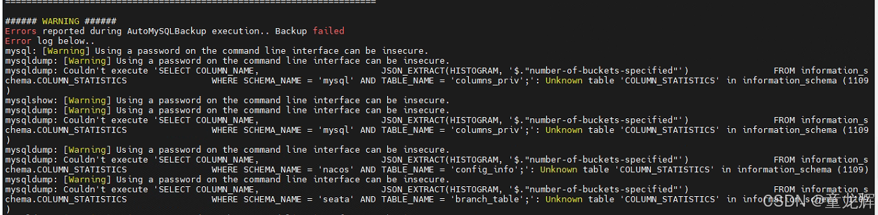

during AutoMySQLBackup execution.. Backup failed
Error log below..
mysql: [Warning] Using a password on the command line interface can be insecure.
mysqldump: [Warning] Using a password on the command line interface can be insecure.
mysqldump: Couldn't execute 'SELECT COLUMN_NAME,                       JSON_EXTRACT(HISTOGRAM, '$."number-of-buckets-specified"')                FROM information_schema.COLUMN_STATISTICS                WHERE SCHEMA_NAME = 'mysql' AND TABLE_NAME = 'columns_priv';': Unknown table 'COLUMN_STATISTICS' in information_schema (1109)
网上大部分的回答都是版本5.7导致没办法查到COLUMN_STATISTICS 表;COLUMN_STATISTICS是 MySQL 8.0 引入的,通常用于存储有关列统计信息的元数据。
