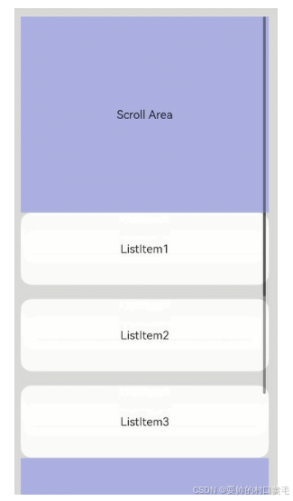

示例2
该示例利用onScrollFrameBegin变乱实现了内层List组件和外层Scroll组件的嵌套滚动。
  1. import { LengthMetrics } from '@kit.ArkUI'
  2. @Entry
  3. @Component
  4. struct NestedScroll {
  5.   @State listPosition: number = 0; // 0代表滚动到List顶部,1代表中间值,2代表滚动到List底部。
  6.   private arr: number[] = [1, 2, 3, 4, 5, 6, 7, 8, 9, 10]
  7.   private scrollerForScroll: Scroller = new Scroller()
  8.   private scrollerForList: Scroller = new Scroller()
  9.   build() {
  10.     Flex() {
  11.       Scroll(this.scrollerForScroll) {
  12.         Column() {
  13.           Text("Scroll Area")
  14.             .width("100%")
  15.             .height("40%")
  16.             .backgroundColor(0X330000FF)
  17.             .fontSize(16)
  18.             .textAlign(TextAlign.Center)
  19.             .onClick(() => {
  20.               this.scrollerForList.scrollToIndex(5, false, ScrollAlign.START, { extraOffset: LengthMetrics.vp(5) })
  21.             })
  22.           List({ space: 20, scroller: this.scrollerForList }) {
  23.             ForEach(this.arr, (item: number) => {
  24.               ListItem() {
  25.                 Text("ListItem" + item)
  26.                   .width("100%")
  27.                   .height("100%")
  28.                   .borderRadius(15)
  29.                   .fontSize(16)
  30.                   .textAlign(TextAlign.Center)
  31.                   .backgroundColor(Color.White)
  32.               }.width("100%").height(100)
  33.             }, (item: string) => item)
  34.           }
  35.           .width("100%")
  36.           .height("50%")
  37.           .edgeEffect(EdgeEffect.None)
  38.           .friction(0.6)
  39.           .onReachStart(() => {
  40.             this.listPosition = 0
  41.           })
  42.           .onReachEnd(() => {
  43.             this.listPosition = 2
  44.           })
  45.           .onScrollFrameBegin((offset: number) => {
  46.             if ((this.listPosition == 0 && offset <= 0) || (this.listPosition == 2 && offset >= 0)) {
  47.               this.scrollerForScroll.scrollBy(0, offset)
  48.               return { offsetRemain: 0 }
  49.             }
  50.             this.listPosition = 1
  51.             return { offsetRemain: offset };
  52.           })
  53.           Text("Scroll Area")
  54.             .width("100%")
  55.             .height("40%")
  56.             .backgroundColor(0X330000FF)
  57.             .fontSize(16)
  58.             .textAlign(TextAlign.Center)
  59.         }
  60.       }
  61.       .width("100%").height("100%")
  62.     }.width('100%').height('100%').backgroundColor(0xDCDCDC).padding(20)
  63.   }
  64. }

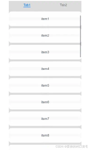

示例3
该示例利用nestedScroll属性实现了内层List组件和外层Scroll组件的嵌套滚动。
  1. @Entry
  2. @Component
  3. struct StickyNestedScroll {
  4.   @State arr: number[] = []
  5.   @Styles
  6.   listCard() {
  7.     .backgroundColor(Color.White)
  8.     .height(72)
  9.     .width("100%")
  10.     .borderRadius(12)
  11.   }
  12.   build() {
  13.     Scroll() {
  14.       Column() {
  15.         Text("Scroll Area")
  16.           .width("100%")
  17.           .height("40%")
  18.           .backgroundColor('#0080DC')
  19.           .textAlign(TextAlign.Center)
  20.         Tabs({ barPosition: BarPosition.Start }) {
  21.           TabContent() {
  22.             List({ space: 10 }) {
  24.                 ListItem() {
  25.                   Text("item" + item)
  26.                     .fontSize(16)
  27.                 }.listCard()
  28.               }, (item: string) => item)
  29.             }.width("100%")
  30.             .edgeEffect(EdgeEffect.Spring)
  31.             .nestedScroll({
  32.               scrollForward: NestedScrollMode.PARENT_FIRST,
  33.               scrollBackward: NestedScrollMode.SELF_FIRST
  34.             })
  35.           }.tabBar("Tab1")
  36.           TabContent() {
  37.           }.tabBar("Tab2")
  38.         }
  39.         .vertical(false)
  40.         .height("100%")
  41.       }.width("100%")
  42.     }
  43.     .edgeEffect(EdgeEffect.Spring)
  44.     .friction(0.6)
  45.     .backgroundColor('#DCDCDC')
  46.     .scrollBar(BarState.Off)
  47.     .width('100%')
  48.     .height('100%')
  49.   }
  50.   aboutToAppear() {
  51.     for (let i = 0; i < 30; i++) {
  52.       this.arr.push(i)
  53.     }
  54.   }
  55. }

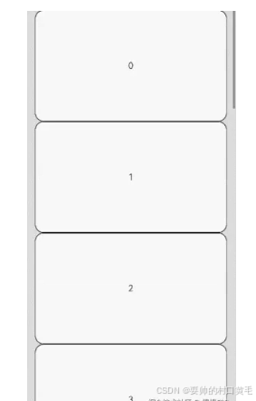

示例4
该示例实现了Scroll组件的限位滚动。
  1. @Entry
  2. @Component
  3. struct Index {
  4.   scroller: Scroller = new Scroller;
  5.   private arr: number[] = [0, 1, 2, 3, 4, 5, 6, 7, 8, 9, 10, 11, 12, 13, 14, 15]
  6.   build() {
  7.     Scroll(this.scroller) {
  8.       Column() {
  9.         ForEach(this.arr, (item: number) => {
  10.           Text(item.toString())
  11.             .width('90%')
  12.             .height(200)
  13.             .backgroundColor(0xFFFFFF)
  14.             .borderWidth(1)
  15.             .borderColor(Color.Black)
  16.             .borderRadius(15)
  17.             .fontSize(16)
  19.         }, (item: string) => item)
  20.       }.width('100%').backgroundColor(0xDCDCDC)
  21.     }
  22.     .backgroundColor(Color.Yellow)
  23.     .height('100%')
  24.     .edgeEffect(EdgeEffect.Spring)
  25.     .scrollSnap({snapAlign:ScrollSnapAlign.START, snapPagination:400, enableSnapToStart:true, enableSnapToEnd:true})
  26.   }
  27. }

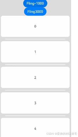

示例5
该示例通过scroller控制器的Fling接口触发Scroll组件的惯性滚动。
  1. @Entry
  2. @Component
  3. //滚动控制器新增按给定速度执行惯性滚动的函数fling
  4. struct ListExample {
  5.   private arr: number[] = [0, 1, 2, 3, 4, 5, 6, 7, 8, 9, 10, 11]
  6.   scrollerForList: Scroller = new Scroller()
  7.   build() {
  8.     Column() {
  9.       Button('Fling-1000')
  10.         .height('5%')
  11.         .onClick(() => {
  12.           this.scrollerForList.fling(-1000)
  13.         })
  14.       Button('Fling3000')
  15.         .height('5%')
  16.         .onClick(() => {
  17.           this.scrollerForList.fling(3000)
  18.         })
  19.       List({ space: 20, initialIndex: 0, scroller: this.scrollerForList }) {
  20.         ForEach(this.arr, (item: number) => {
  21.           ListItem() {
  22.             Text('' + item)
  23.               .width('100%').height(100).fontSize(16)
  24.               .textAlign(TextAlign.Center).borderRadius(10).backgroundColor(0xFFFFFF)
  25.           }
  26.         }, (item: string) => item)
  27.       }
  28.       .listDirection(Axis.Vertical) // 排列方向
  29.       .scrollBar(BarState.Off)
  30.       .friction(0.9)
  31.       .divider({ strokeWidth: 2, color: 0xFFFFFF, startMargin: 20, endMargin: 20 }) // 每行之间的分界线
  32.       .edgeEffect(EdgeEffect.Spring) // 边缘效果设置为Spring
  33.       .width('90%')
  34.     }
  35.     .width('100%')
  36.     .height('100%')
  37.     .backgroundColor(0xDCDCDC)
  38.     .padding({ top: 5 })
  39.   }
  40. }

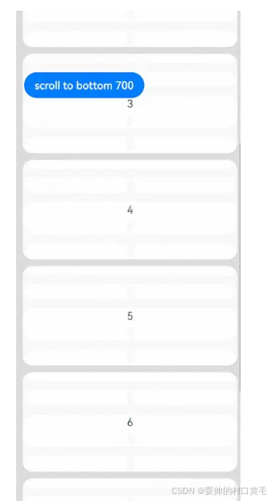

示例6
该示例实现了按速率700vp/s向Scroll下边缘滚动。
  1. // xxx.ets@Entry@Componentstruct ScrollExample {  scroller: Scroller = new Scroller()
  2.   private arr: number[] = [0, 1, 2, 3, 4, 5, 6, 7, 8, 9]  build() {    Stack({ alignContent: Alignment.TopStart }) {      Scroll(this.scroller) {        Column() {          ForEach(this.arr, (item: number) => {            Text(item.toString())              .width('90%')              .height(150)              .backgroundColor(0xFFFFFF)              .borderRadius(15)              .fontSize(16)              .textAlign(TextAlign.Center)              .margin({ top: 10 })          }, (item: string) => item)        }.width('100%')      }      .scrollable(ScrollDirection.Vertical) // 滚动方向纵向      .scrollBar(BarState.On) // 滚动条常驻显示      .scrollBarColor(Color.Gray) // 滚动条颜色      .scrollBarWidth(10) // 滚动条宽度      .friction(0.6)      .edgeEffect(EdgeEffect.None)      .onWillScroll((xOffset: number, yOffset: number, scrollState: ScrollState) => {        console.info(xOffset + ' ' + yOffset)      })      .onScrollEdge((side: Edge) => {        console.info('To the edge')      })      .onScrollStop(() => {        console.info('Scroll Stop')      })      Button('scroll to bottom 700')        .height('5%')        .onClick(() => { // 点击后滑到下边缘,速率值是700vp/s          this.scroller.scrollEdge(Edge.Bottom, { velocity: 700 })        })        .margin({ top: 100, left: 20 })    }.width('100%').height('100%').backgroundColor(0xDCDCDC)  }}
