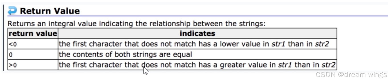

1.4 strcmp - 字符串比较
int strcmp ( const char * str1 , const char * str2 );
- This function starts comparing the first character of each string. If they are equal to each other, it continues with the following pairs until the characters differ or until a terminating null-character is reached.
标准规定:
- 第一个字符串大于第二个字符串,则返回大于0的数字 //>0
- 第一个字符串即是第二个字符串,则返回0 //=0
- 第一个字符串小于第二个字符串,则返回小于0的数字 //<0
- 那么如何判定两个字符串?

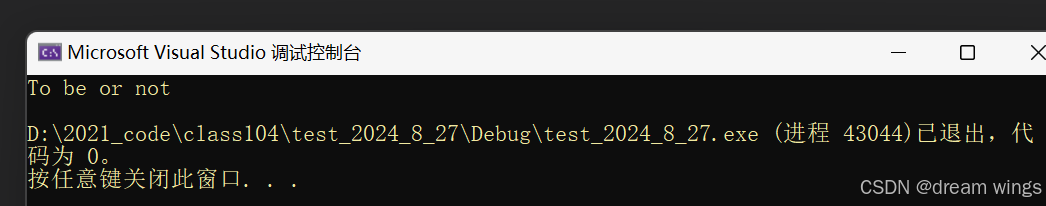

- /* strncat example */
- #include <stdio.h>
- #include <string.h>
- int main ()
- char str1[20];
- char str2[20];
- strcpy (str1,"To be ");
- strcpy (str2,"or not to be");
- strncat (str1, str2, 6);
- puts (str1);
- return 0;
复制代码 结果: 1.7 strncmp - 受限定比较字符串

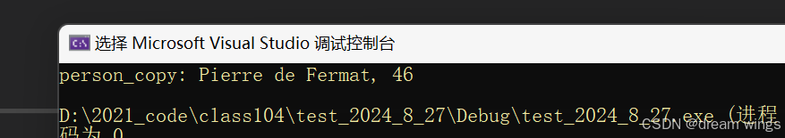

- /* memcpy example */
- struct {
- char name[40];
- int age;
- } person, person_copy;
- int main ()
- char myname[] = "Pierre de Fermat";
- /* using memcpy to copy string: */
- memcpy ( person.name, myname, strlen(myname)+1 );
- person.age = 46;
- /* using memcpy to copy structure: */
- memcpy ( &person_copy, &person, sizeof(person) );
- printf ("person_copy: %s, %d \n", person_copy.name, person_copy.age );
- return 0;
复制代码 结果:

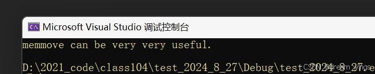

- /* memmove example */
- int main ()
- char str[] = "memmove can be very useful......";
- memmove (str+20,str+15,11);
- puts (str);
- return 0;
复制代码 结果:

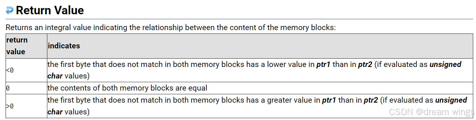

1.13 memcmp - 比较两个内存块
int memcmp ( const void * ptr1 , const void * ptr2 , size_t num ); 比较两个内存块
比较第一个数字指向的内存块的字节数ptr1到第一个数字指向的字节数ptr2,如果它们都匹配,则返回零;如果不匹配,则返回一个不同于零的值,表示哪个值更大。
留意,不像strcmp,函数在找到空字符后不会制止比较。
- 比较从ptr1和ptr2指针开始的num个字节
- 返回值如下:
- /* memcmp example */
- int main ()
- char buffer1[] = "DWgaOtP12df0";
- char buffer2[] = "DWGAOTP12DF0";
- int n;
- n=memcmp ( buffer1, buffer2, sizeof(buffer1) );
- if (n>0) printf ("'%s' is greater than '%s'.\n",buffer1,buffer2);
- else if (n<0) printf ("'%s' is less than '%s'.\n",buffer1,buffer2);
- else printf ("'%s' is the same as '%s'.\n",buffer1,buffer2);
- return 0;
复制代码 输出:
- 'DWgaOtP12df0' is greater than 'DWGAOTP12DF0'.
复制代码 | DWgAOtp12Df0大于DWGAOTP12DF0因为两个单词中第一个不匹配的字符是' g '和' G '分别为,和' g '(103)评估为大于' G ' (71). 2. 库函数的模拟实现
