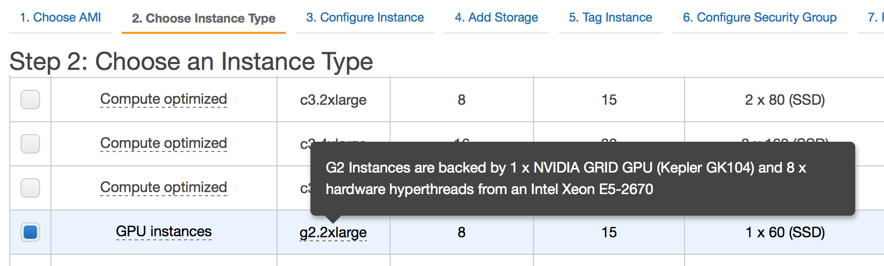

Provision Machine
  • AMI
    Ubuntu Server 14.04 LTS (HVM), SSD Volume Type
  • Select Instance Type
http://docs.aws.amazon.com/AWSEC2/latest/UserGuide/using_cluster_computing.html
  • Deploy it

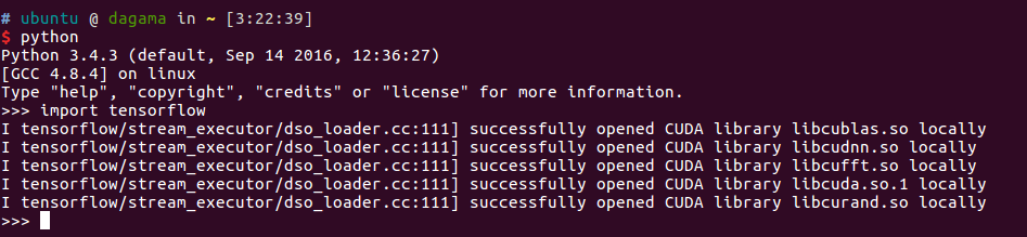

Install tensorflow0.9.0(python3.4)
  1. # Ubuntu/Linux 64-bit, GPU enabled, Python 3.4
  2. # Requires CUDA toolkit 7.5 and CuDNN v4. For other versions, see "Install from sources" below.
  3. $ export TF_BINARY_URL=https://storage.googleapis.com/tensorflow/linux/gpu/tensorflow-0.9.0-cp34-cp34m-linux_x86_64.whl
  4. # Python3
  5. $ sudo pip3 install --upgrade $TF_BINARY_UR

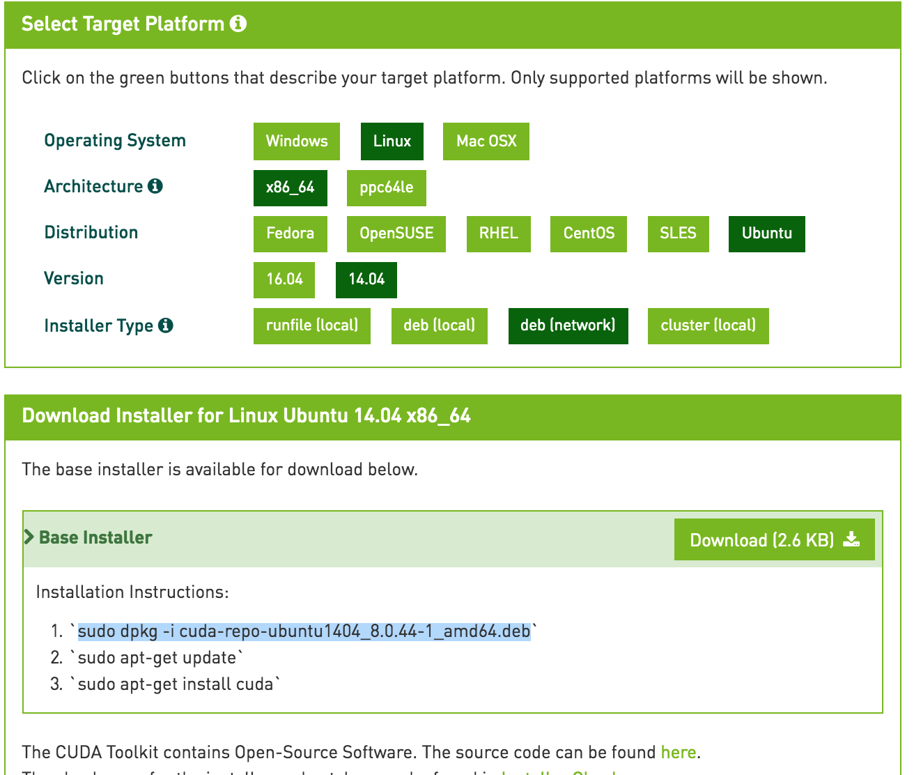

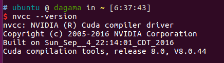

manual
  1. sudo dpkg -i cuda-repo-ubuntu1404_8.0.44-1_amd64.deb
  2. sudo apt-get update
  3. sudo apt-get install cuda
Setup CUDA_HOME in PATH
