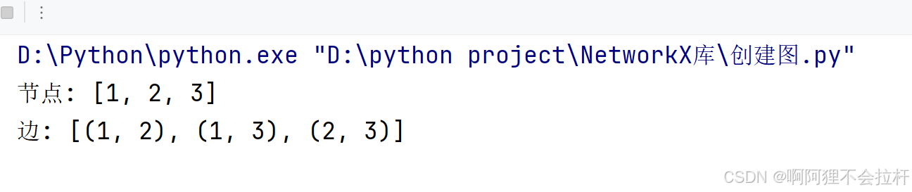

1. 创建图
Python示例代码
  1. import networkx as nx
  2. # 创建一个空的无向图
  3. G = nx.Graph()
  4. # 添加节点
  5. G.add_node(1)
  6. G.add_nodes_from([2, 3])
  7. # 添加边
  8. G.add_edge(1, 2)
  9. G.add_edges_from([(2, 3), (3, 1)])
  10. # 查看节点和边
  11. print("节点:", G.nodes())
  12. print("边:", G.edges())
结果展示

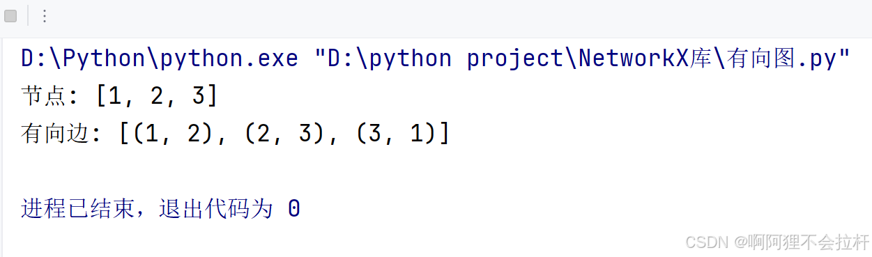

2. 创建有向图
Python示例代码
  2. # 创建一个有向图
  3. DG = nx.DiGraph()
  4. # 添加节点和边
  5. DG.add_edges_from([(1, 2), (2, 3), (3, 1)])
  6. # 打印有向图的节点和边
  7. print("节点:", DG.nodes())
  8. print("有向边:", DG.edges())
结果展示

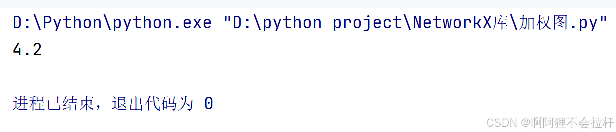

3. 创建加权图
Python示例代码
  2. # 创建一个加权无向图
  3. WG = nx.Graph()
  4. # 添加带权重的边
  5. WG.add_edge(1, 2, weight=4.2)
  6. WG.add_edge(2, 3, weight=3.1)
  7. # 获取边的权重
  8. print(WG[1][2]['weight'])
结果展示

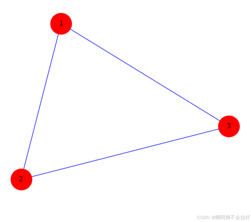

4. 图的可视化
Python示例代码
  1. import matplotlib.pyplot as plt
  2. import networkx as nx
  3. # 创建一个空的无向图
  4. G = nx.Graph()
  5. # 添加节点
  6. G.add_node(1)
  7. G.add_nodes_from([2, 3])
  8. # 添加边
  9. G.add_edge(1, 2)
  10. G.add_edges_from([(2, 3), (3, 1)])
  11. # 绘制图
  12. nx.draw(G, with_labels=True, node_color='red', node_size=1500, edge_color='blue')
  13. plt.show()
结果展示

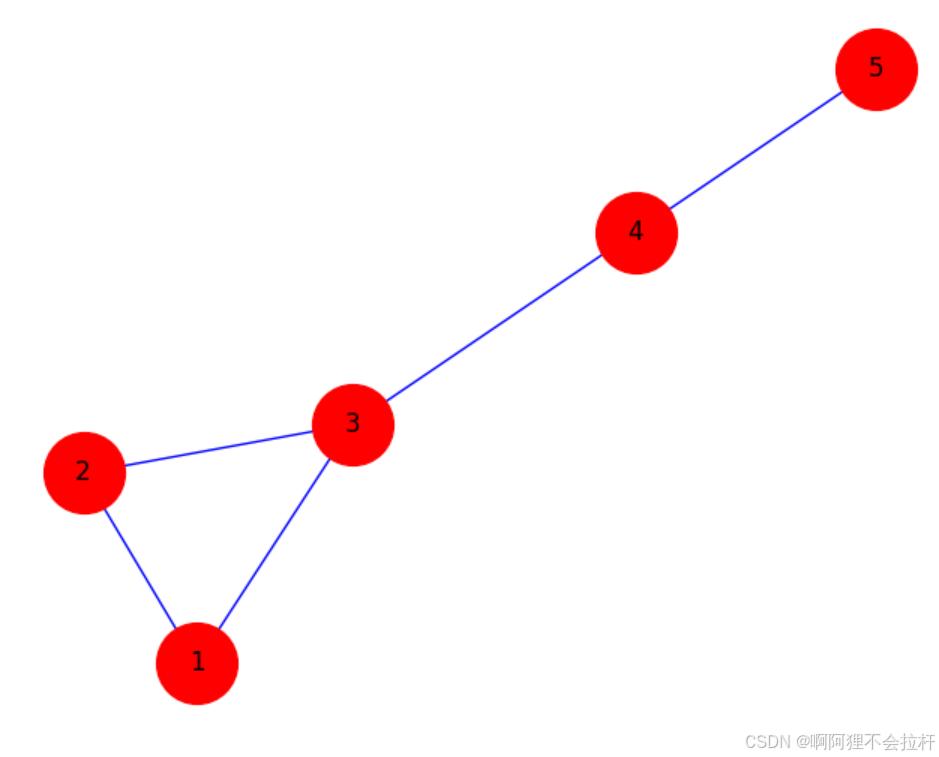

三、高级利用示例
1. 盘算最短路径
Python示例代码
  3. # 创建一个空的无向图
  4. G = nx.Graph()
  5. # 添加节点
  6. G.add_node(1)
  7. G.add_nodes_from([2, 3,4,5])
  8. # 添加边
  9. G.add_edge(1, 2)
  10. G.add_edges_from([(2, 3), (3, 1),(3,4),(5,4)])
  11. # 绘制图
  13. plt.show()
  14. # 计算最短路径
  15. path = nx.shortest_path(G, source=1, target=3)
  16. print("最短路径:", path)
结果展示

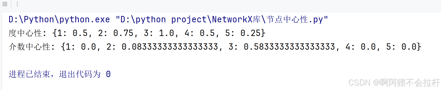

2. 盘算节点中央性
Python示例代码
  3. # 创建一个空的无向图
  4. G = nx.Graph()
  5. # 添加节点
  6. G.add_node(1)
  8. # 添加边
  9. G.add_edge(1, 2)
  10. G.add_edges_from([(2, 3), (3, 1),(3,4),(2,4),(5,3)])
  11. # 绘制图
  12. nx.draw(G, with_labels=True, node_color='red', node_size=1500, edge_color='yellow')
  13. plt.show()
  14. # 计算节点的度中心性
  15. degree_centrality = nx.degree_centrality(G)
  16. print("度中心性:", degree_centrality)
  17. # 计算节点的介数中心性
  18. betweenness_centrality = nx.betweenness_centrality(G)
  19. print("介数中心性:", betweenness_centrality)
结果展示

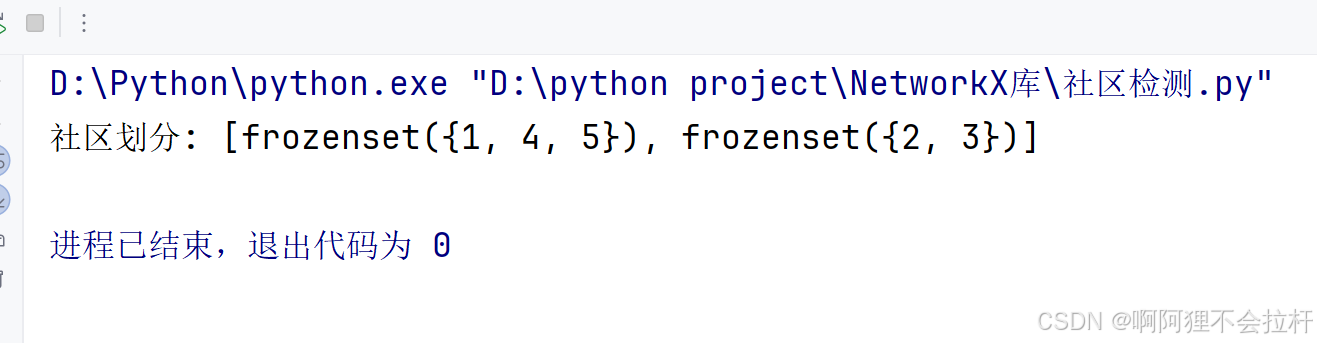

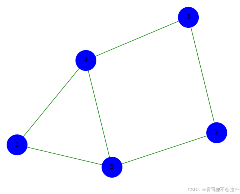

3. 社区检测
Python示例代码
  1. from networkx.algorithms.community import greedy_modularity_communities
  2. import matplotlib.pyplot as plt
  3. import networkx as nx
  4. # 创建一个空的无向图
  5. G = nx.Graph()
  6. # 添加节点
  7. G.add_node(1)
  8. G.add_nodes_from([2,3,4,5])
  9. # 添加边
  10. G.add_edge(1, 4)
  11. G.add_edges_from([(4,3), (3, 2),(2,5),(5,1),(4,5)])
  12. # 绘制图
  13. nx.draw(G, with_labels=True, node_color='blue', node_size=1500, edge_color='green')
  14. plt.show()
  15. # 检测社区
  16. communities = greedy_modularity_communities(G)
  17. print("社区划分:", communities)
结果展示
