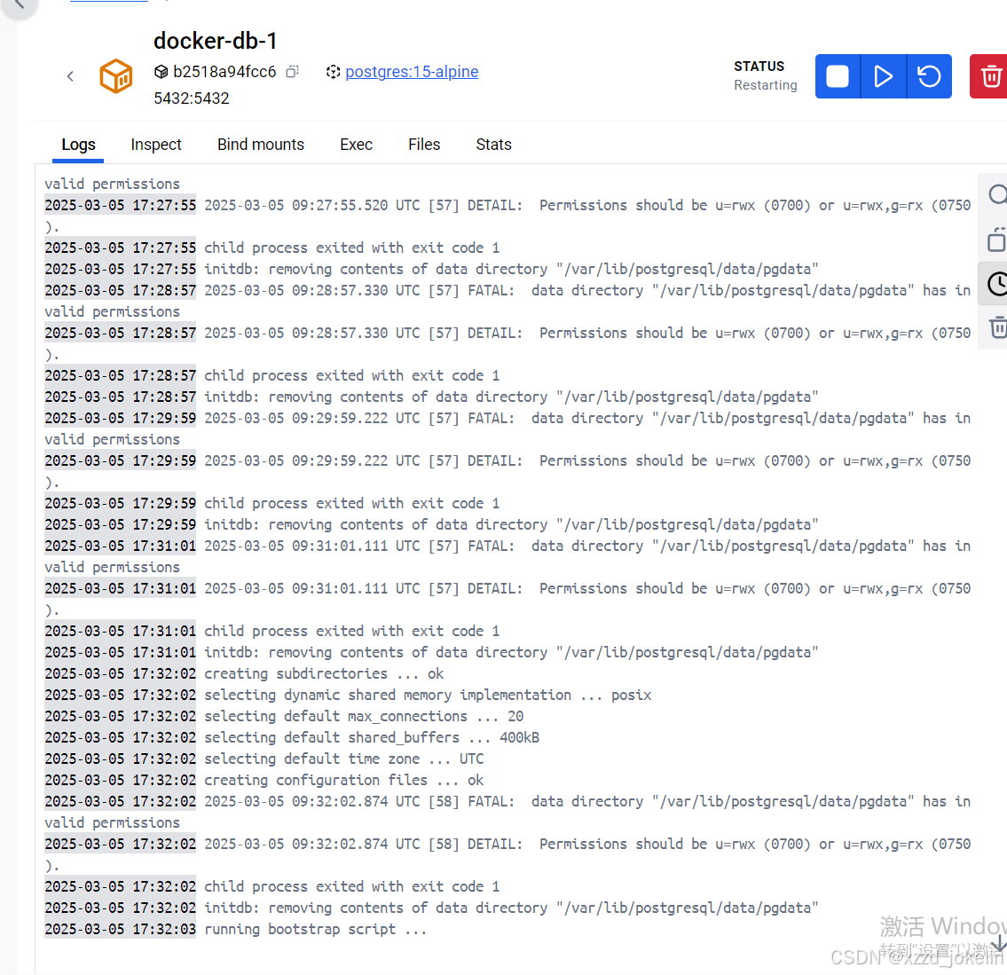

FATAL:  data directory "/var/lib/postgresql/data/pgdata" has invalid permissions

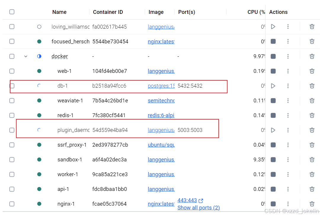

两个容器没有起来,看一下日记:
2025-03-05 17:29:59 initdb: removing contents of data directory "/var/lib/postgresql/data/pgdata"
2025-03-05 17:31:01 2025-03-05 09:31:01.111 UTC [57] FATAL:  data directory "/var/lib/postgresql/data/pgdata" has invalid permissions
2025-03-05 17:31:01 2025-03-05 09:31:01.111 UTC [57] DETAIL:  Permissions should be u=rwx (0700) or u=rwx,g=rx (0750).
2025-03-05 17:31:01 child process exited with exit code 1
2025-03-05 17:31:01 initdb: removing contents of data directory "/var/lib/postgresql/data/pgdata"
2025-03-05 17:32:02 creating subdirectories ... ok
2025-03-05 17:32:02 selecting dynamic shared memory implementation ... posix
2025-03-05 17:32:02 selecting default max_connections ... 20
2025-03-05 17:32:02 selecting default shared_buffers ... 400kB
2025-03-05 17:32:02 selecting default time zone ... UTC
2025-03-05 17:32:02 creating configuration files ... ok
2025-03-05 17:32:02 2025-03-05 09:32:02.874 UTC [58] FATAL:  data directory "/var/lib/postgresql/data/pgdata" has invalid permissions
2025-03-05 17:32:02 2025-03-05 09:32:02.874 UTC [58] DETAIL:  Permissions should be u=rwx (0700) or u=rwx,g=rx (0750).
2025-03-05 17:32:02 child process exited with exit code 1
2025-03-05 17:32:02 initdb: removing contents of data directory "/var/lib/postgresql/data/pgdata"
2025-03-05 17:32:03 running bootstrap script ...

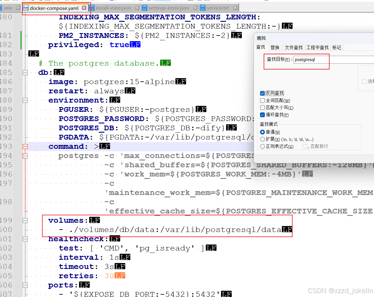

发现目次权限问题;
目次的当前权限设置
PostgreSQL 对其数据目次有严格的权限要求。通常,数据目次应该归 postgres 用户和组所有,并且权限应该设置为 700(即只有所有者有读、写和执行权限)。
假如权限设置不正确,你需要进行调整。
1.修改dify/docker/docker-compose.yaml配置文件
  • 改成:
  • volumes:
    - /volumes/db/data:/var/lib/postgresql/data
然后继续执行:

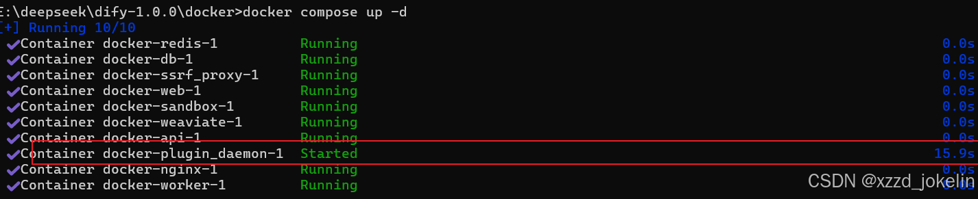

E:\deepseek\dify-1.0.0\docker>docker compose up -d

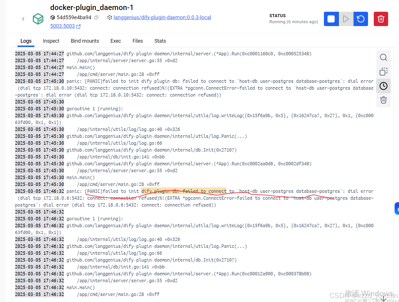

docker-plugin_daemon-1 也在报错
修改 docker-compose.yaml 中  docker-plugin_daemon-1 的配置
   - ./volumes/plugin_daemon:/app/storage
  修改为:
  - /volumes/plugin_daemon:/app/storage

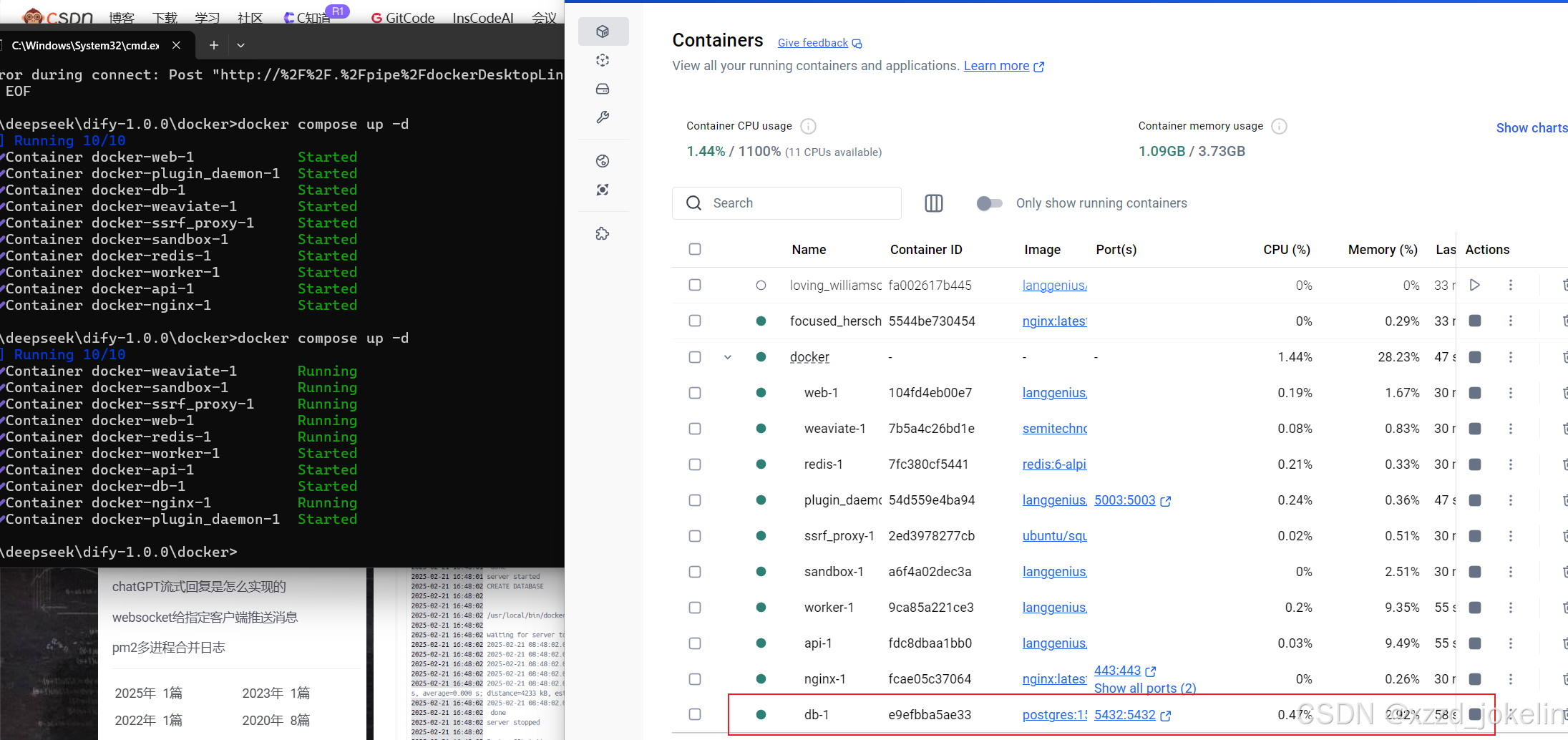

  然后再执行下令跟新
已经没有了报错日记

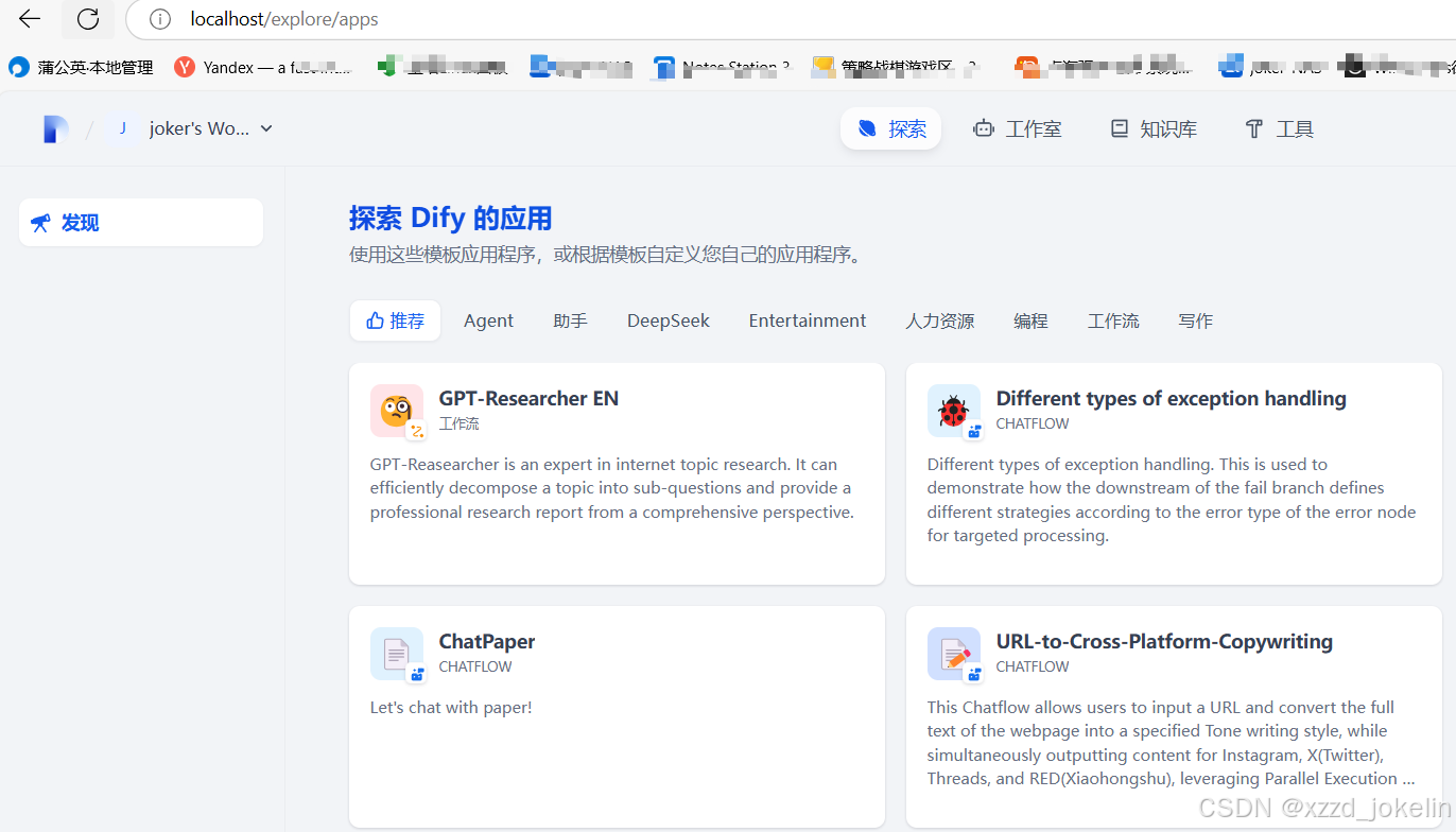

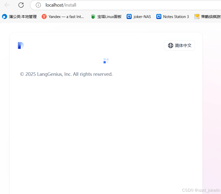

这时候再访问:发现已经好了Dify

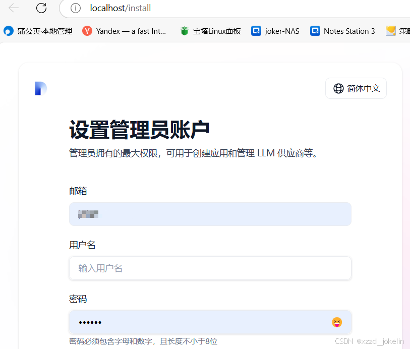

http://localhost/install
注册之后发现已经好了
