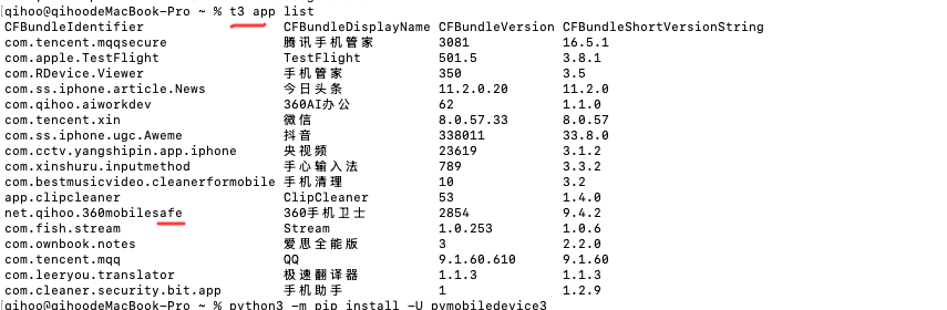

二、查看应用的 Bundle Identifier(包标识符)
t3 app list
或者 pymobiledevice3 apps list |grep xxx

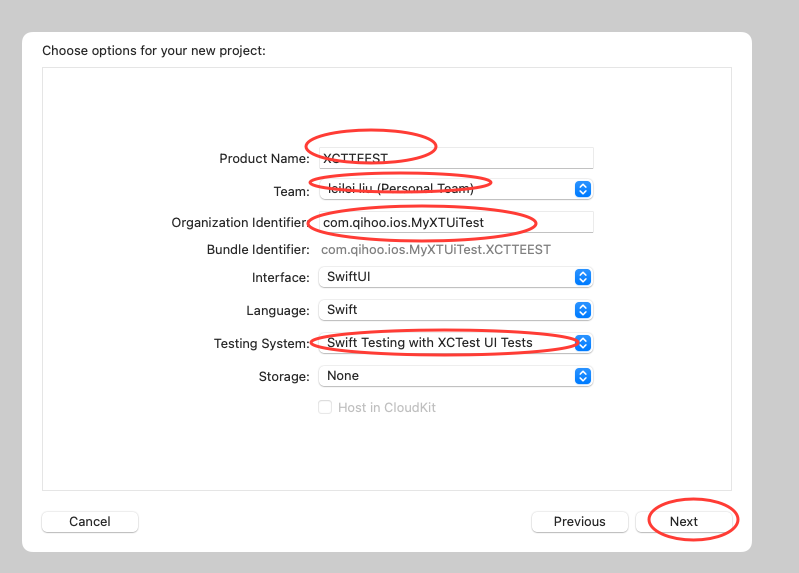

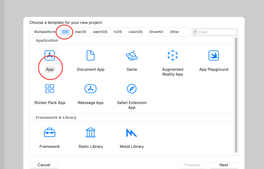

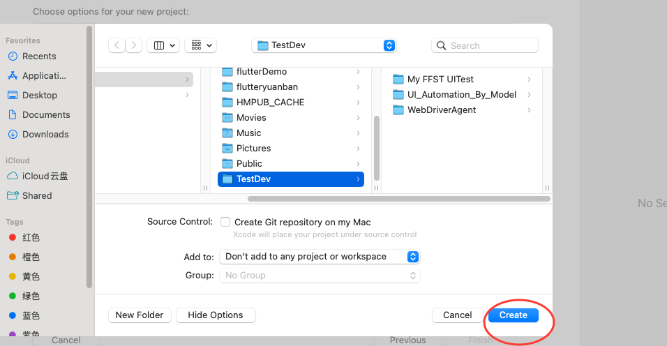

三、创建项目
Xcode->File->New→Project...
起一个名字
选择位置 后点击 Create
创建后如下:

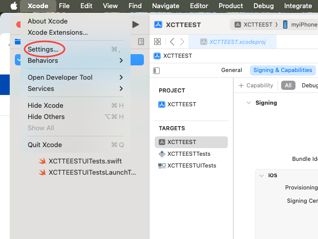

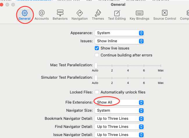

四、授权:
左侧不显示文件后缀:

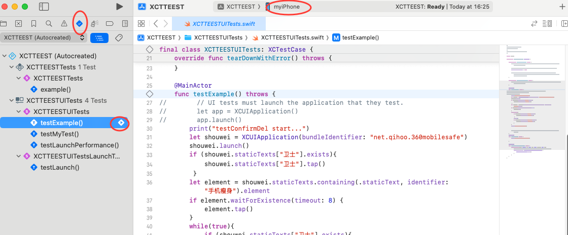

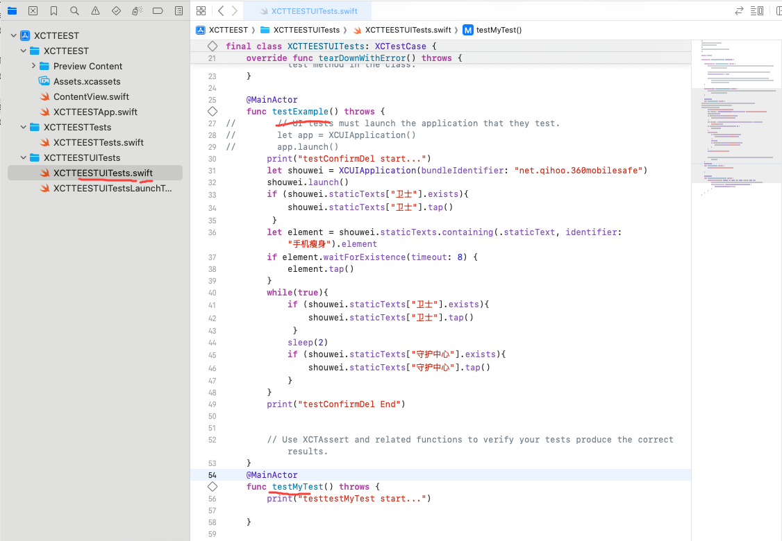

执行 代码:
func testExample() throws {
// // UI tests must launch the application that they test.
// let app = XCUIApplication()
// app.launch()
print("testConfirmDel start...")
let shouwei = XCUIApplication(bundleIdentifier: "net.qihoo.360mobilesafe")
shouwei.launch()
if (shouwei.staticTexts["卫士"].exists){
shouwei.staticTexts["卫士"].tap()
let element = shouwei.staticTexts.containing(.staticText, identifier: "手机瘦身").element
if element.waitForExistence(timeout: 8) {
element.tap()
while(true){
sleep(2)
if (shouwei.staticTexts["守护中心"].exists){
shouwei.staticTexts["守护中心"].tap()
print("testConfirmDel End")
// Use XCTAssert and related functions to verify your tests produce the correct results.
@MainActor
func testMyTest() throws {
print("testtestMyTest start...")
连接iphone设备后执行:
