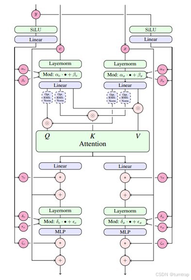

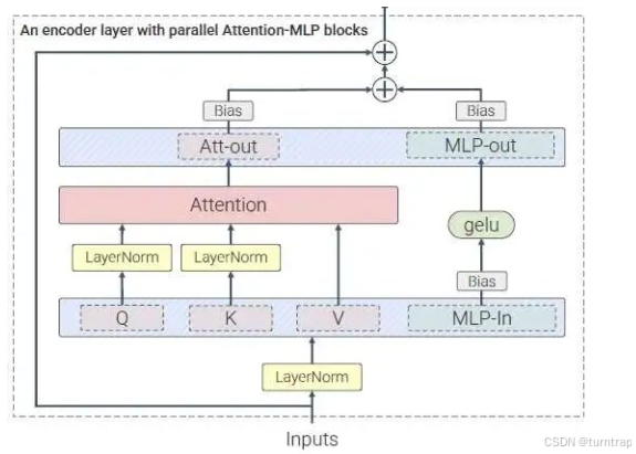

2.4 FluxTransformer2DModel:
    "_class_name": "FluxTransformer2DModel",
    "_diffusers_version": "0.30.0.dev0",
    "_name_or_path": "../checkpoints/flux-dev/transformer",
    "attention_head_dim": 128,
    "guidance_embeds": true,
    "in_channels": 64,
    "joint_attention_dim": 4096,(联合注意力维度)
    "num_attention_heads": 24,
    "num_layers": 19,
    "num_single_layers": 38,
    "patch_size": 1,
    "pooled_projection_dim": 768(池化投影维度)
          该模块重要负责融合时间步、引导强度、池化文本嵌入、高维文本嵌入和潜在图像,在去噪过程中猜测每一步的噪音图像,对潜在图像举行更新:
        在该模块须要注意位置嵌入、时间-引导强度-池化文本融合嵌入和模态融合。

MMDiT模块实行流程
       此中,y是时间步-引导嵌入-池化文本嵌入,c是高维文本嵌入,x是潜入图像,具体为:潜在图像hidden_states和高维文本嵌入encoder_hidden_states分别举行(归一化->注意力模块(模态融合)->残差连接->归一化->前馈网络->残差连接),循环后将二者在第二维拼接为hidden_states:[batch_size, (h//2) * (w// 2)+ sequence_length,inner_dim],这是新的hidden_states。
        在MMDiT中,须要注意的是自顺应归一化AdaLayerNormZero和归一化后利用天生的门控和偏移调整注意力权重:
  1. class AdaLayerNormZero(nn.Module):
  2.        def __init__(self, embedding_dim: int, num_embeddings: Optional[int] = None, norm_type="layer_norm", bias=True):
  3.         super().__init__()
  4.         if num_embeddings is not None:
  5.             self.emb = CombinedTimestepLabelEmbeddings(num_embeddings, embedding_dim)
  6.         else:
  7.             self.emb = None
  8.         self.silu = nn.SiLU()
  9.         self.linear = nn.Linear(embedding_dim, 6 * embedding_dim, bias=bias)
  10.         if norm_type == "layer_norm":
  11.             self.norm = nn.LayerNorm(embedding_dim, elementwise_affine=False, eps=1e-6)
  12.         elif norm_type == "fp32_layer_norm":
  13.             self.norm = FP32LayerNorm(embedding_dim, elementwise_affine=False, bias=False)
  14.         else:
  15.             raise ValueError(
  16.                 f"Unsupported `norm_type` ({norm_type}) provided. Supported ones are: 'layer_norm', 'fp32_layer_norm'."
  17.             )
  18.     def forward(
  19.         self,
  20.         x: torch.Tensor,
  21.         timestep: Optional[torch.Tensor] = None,
  22.         class_labels: Optional[torch.LongTensor] = None,
  23.         hidden_dtype: Optional[torch.dtype] = None,
  24.         emb: Optional[torch.Tensor] = None,
  25.     ) -> Tuple[torch.Tensor, torch.Tensor, torch.Tensor, torch.Tensor, torch.Tensor]:
  26.         if self.emb is not None:
  27.             emb = self.emb(timestep, class_labels, hidden_dtype=hidden_dtype)
  28.         emb = self.linear(self.silu(emb))
  29.         # 分割成6块:每一块形状【batch_size,embedding_dim(也就是inner_dim)】
  30.         #shift_msa:调整多头自注意力输出的偏移量(用法:+)
  31.         #scale_msa:缩放多头自注意力输出(用法:扩展维度后,*)
  32.         #gate_msa:控制多头自注意力输出的激活程度(用法:扩展维度后,*)
  33.         #shift_mlp:用于调整前馈网络(MLP)输出的偏移量
  34.         #scale_mlp:用于缩放前馈网络输出
  35.         #gate_mlp:用于控制前馈网络输出的激活程度
  36.         shift_msa, scale_msa, gate_msa, shift_mlp, scale_mlp, gate_mlp = emb.chunk(6, dim=1)
  37.         #scale_msa[:, None]形状【batch_size,1,embedding_dim】,*操作在第一维广播(即重复4096次变成【batch_size,4096,inner_dim】)
  38.         x = self.norm(x) * (1 + scale_msa[:, None]) + shift_msa[:, None]
  39.         return x, gate_msa, shift_mlp, scale_mlp, gate_mlp
        在AdaLayerNormZero类中,flux模子须要将输入的emb(即融合的时间步、引导嵌入、文本池化嵌入)和x(即潜在图像)举行处理,创建输出维度为6倍输入维度的线性层用于天生shift_msa, scale_msa, gate_msa, shift_mlp, scale_mlp, gate_mlp,其功能在代码中均有描述。
       在MMDiT模块中,当举行多头自注意力计算后,会天生attn_output和 context_attn_output,之后举行如下操纵(二者同理,可看图MMDiT模块实行流程):
  1. #gate_msa表示一个门控信号,用于控制attn_output中的信息流。
  2. attn_output = gate_msa.unsqueeze(1) * attn_output
  3. #残差连接
  4. hidden_states = hidden_states + attn_output
  5. #归一化,以后进行放缩与平移
  6. norm_hidden_states = self.norm2(hidden_states)
  7. norm_hidden_states = norm_hidden_states * (1 + scale_mlp[:, None]) + shift_mlp[:, None]
  8. #通过前馈网络并使用门控信号控制信息流
  9. ff_output = self.ff(norm_hidden_states)
  10. ff_output = gate_mlp.unsqueeze(1) * ff_output
  11. #残差连接
  12. hidden_states = hidden_states + ff_output

并行自注意层( 来自Stable Diffusion 3「精神续作」FLUX.1 源码深度前瞻解读_flowmatcheulerdiscretescheduler-CSDN博客 )
         可以看代码发现注意力层和多层感知机的输入同等,可看作并行,对比MMDiT先辈入注意力层后进入多层感知机,是串行的:
  1. #用于后续残差连接
  2. residual = hidden_states
  3. #自适应归一化
  4. norm_hidden_states, gate = self.norm(hidden_states, emb=temb)
  5. #输入norm_hidden_states进入多层感知机
  6. mlp_hidden_states = self.act_mlp(self.proj_mlp(norm_hidden_states))
  7. joint_attention_kwargs = joint_attention_kwargs or {}
  8. #输入norm_hidden_states进行多头自主力计算,体现并行性
  9. attn_output = self.attn(
  10.     hidden_states=norm_hidden_states,
  11.     image_rotary_emb=image_rotary_emb,
  12.     **joint_attention_kwargs,
  13. )
  14. #拼接
  15. hidden_states = torch.cat([attn_output, mlp_hidden_states], dim=2)
  16. gate = gate.unsqueeze(1)
  17. #使用门控信号控制信息流
  18. hidden_states = gate * self.proj_out(hidden_states)
  19. #残差连接
  20. hidden_states = residual + hidden_states
        最后取hidden_states第一维的后(h//2) * (w// 2)部门举行归一化,之后颠末线性层作为本模块的输出noise_pred:[batch_size,(h//2) * (w// 2),patch_size * patch_size * out_channels](与一开始潜在图像hidden_states形状完全同等)
