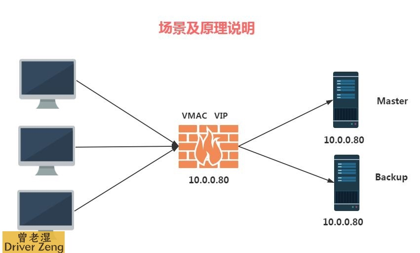

keepailved实现原理
  1. # keepalived底层协议:VRRP(虚拟路由冗余协议)
keepailved核心概念
  1. 1.通过选举投票,决定谁是主节点谁是备节点(选举)
  2. 2.如果Master故障,Backup自动接管,那么Master恢复后会夺权吗(抢占试、非抢占式)
  3. 3.两台服务器都认为自己是master,那么会出现一个故障(脑裂)
keepailved安装配置
环境准备

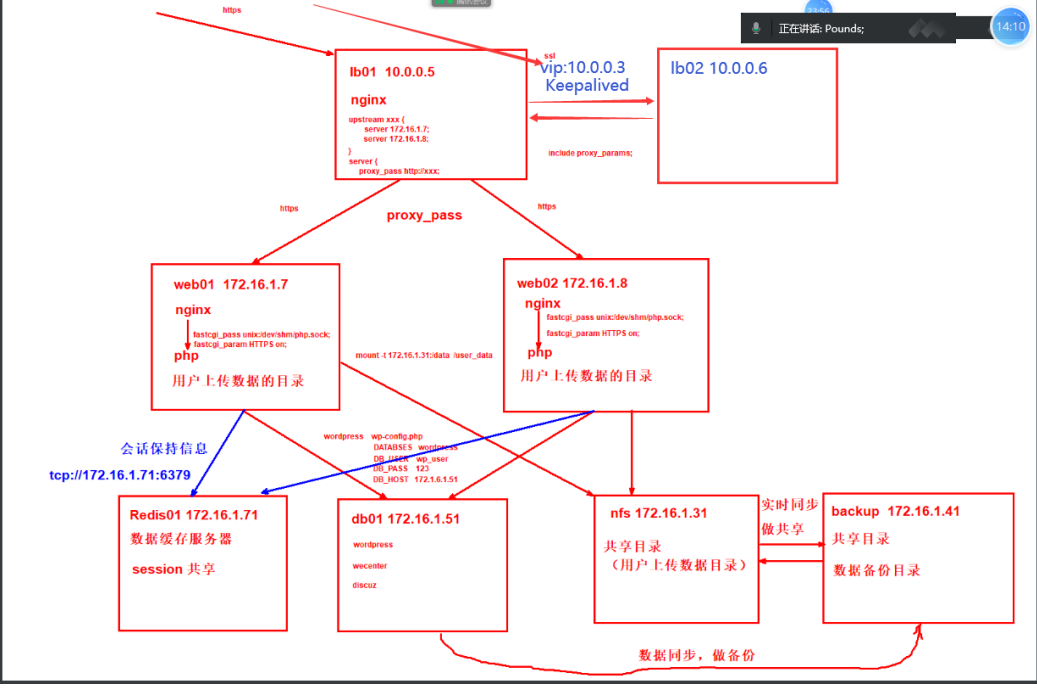

Keepalived结合nginx做高可用
环境准备
主机名waniplanip角色应用lb0110.0.0.5172.16.1.5Master keepalived主节点keepalived、nginxlb0210.0.0.6172.16.1.6Backup keepalived备节点keepalived、nginxweb0110.0.0.7172.16.1.7web网站nginx、phpweb0210.0.0.8172.16.1.8web网站nginx、php关联nginx
