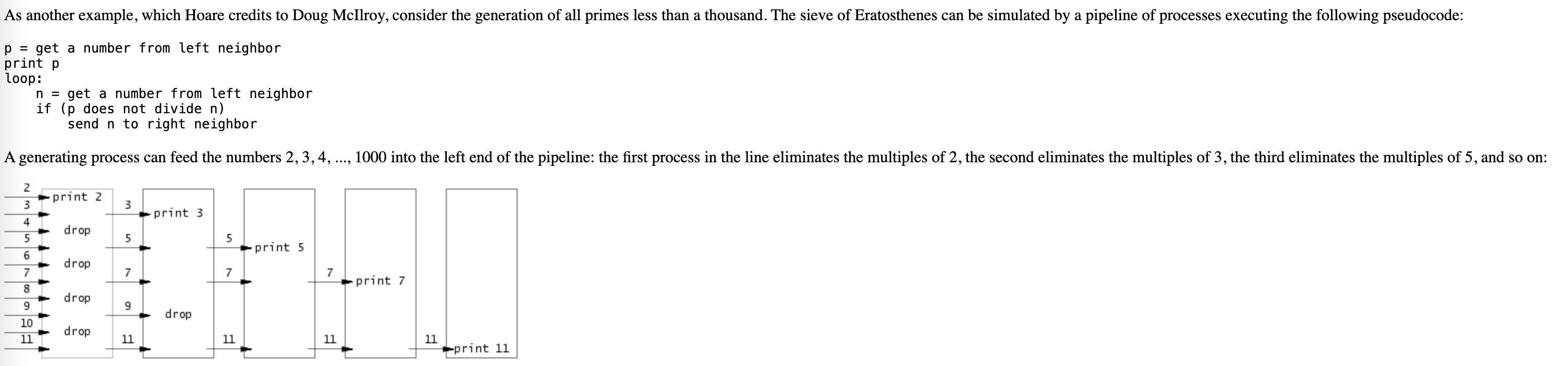

   Write a concurrent prime sieve program for xv6 using pipes and the design illustrated in the picture halfway down this page and the surrounding text. This idea is due to Doug McIlroy, inventor of Unix pipes. Your solution should be in the file user/primes.c.
    Your goal is to use pipe and fork to set up the pipeline. The first process feeds the numbers 2 through 35 into the pipeline. For each prime number, you will arrange to create one process that reads from its left neighbor over a pipe and writes to its right neighbor over another pipe. Since xv6 has limited number of file descriptors and processes, the first process can stop at 35.
    Some hints:
  • Be careful to close file descriptors that a process doesn’t need, because otherwise your program will run xv6 out of resources before the first process reaches 35.
  • Once the first process reaches 35, it should wait until the entire pipeline terminates, including all children, grandchildren, &c. Thus the main primes process should only exit after all the output has been printed, and after all the other primes processes have exited.
  • Hint: read returns zero when the write-side of a pipe is closed.
  • It’s simplest to directly write 32-bit (4-byte) ints to the pipes, rather than using formatted ASCII I/O.
  • You should create the processes in the pipeline only as they are needed.
  • Add the program to UPROGS in Makefile.
  大致意思呢,参考 Unix pipes的创造者,大佬Doug McIlroy的 Bell Labs and CSP Threads,基于多历程和管道来筛选一定范围内的素数.
什么意思呢,每个历程呢就像一个过滤器,把自己处理不了的数据扔给下一级,我是这么理解的啊,这样可能更符合这个实行?
