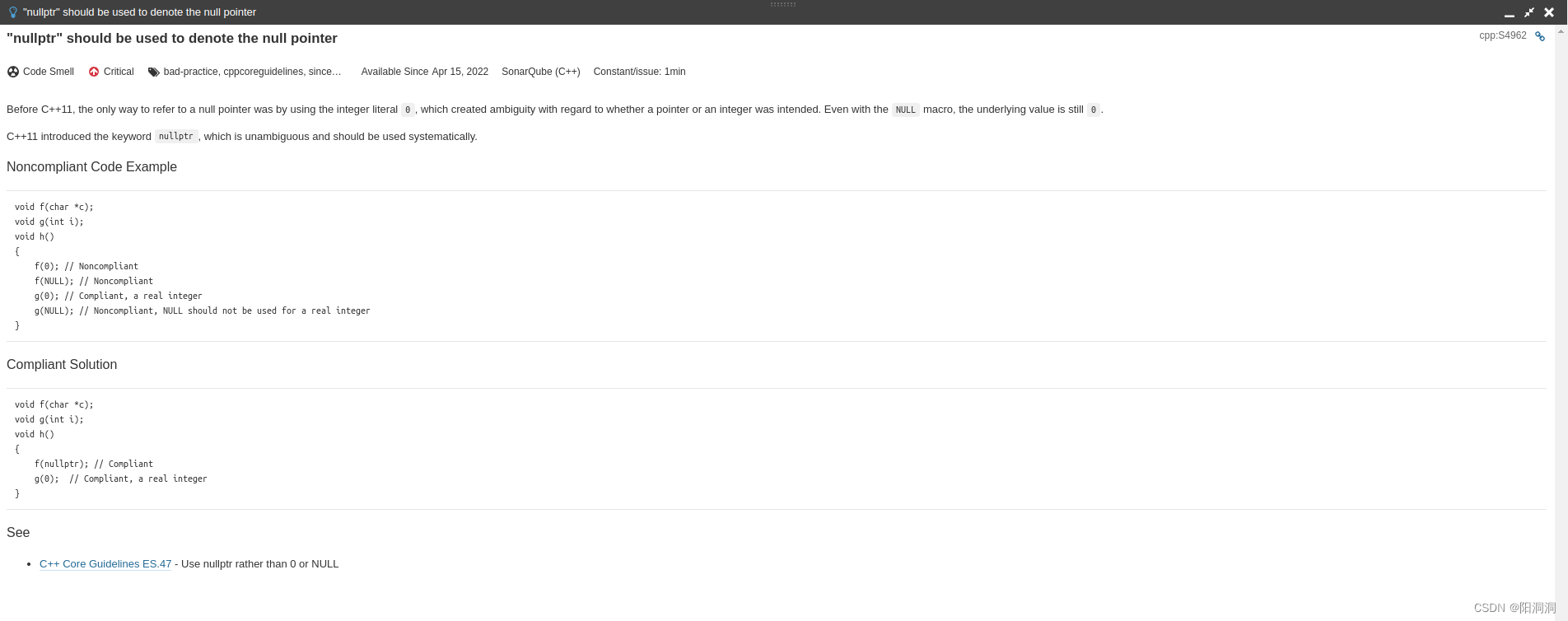

“nullptr“ should be used to denote the null pointer
发表于 2025-10-21 02:32:54 | 显示全部楼层 |阅读模式
Before C++11, the only way to refer to a null pointer was by using the integer literal
 0, which created ambiguity with regard to whether a pointer or an integer was intended. Even with the
 NULL
 macro, the underlying value is still
 0.
C++11 introduced the keyword
 nullptr, which is unambiguous and should be used systematically.
Noncompliant Code Example
  1. void f(char *c);
  2. void g(int i);
  3. void h()
  4. {
  5.     f(0); // Noncompliant
  6.     f(NULL); // Noncompliant
  7.     g(0); // Compliant, a real integer
  8.     g(NULL); // Noncompliant, NULL should not be used for a real integer
  9. }
  1.
Compliant Solution
  1. void f(char *c);
  2. void g(int i);
  3. void h()
  4. {
  5.     f(nullptr); // Compliant
  6.     g(0);  // Compliant, a real integer
  7. }
See
  • C++ Core Guidelines ES.47
     - Use nullptr rather than 0 or NULL
For example
