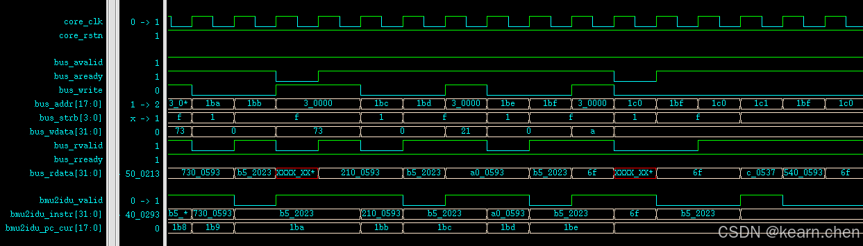

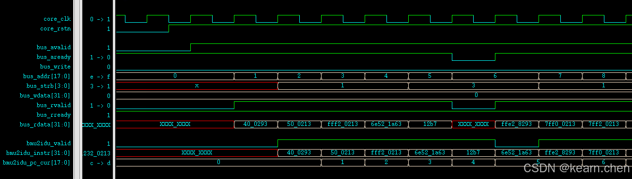

6.仿真效果
6.1 复位竣事
6.2 运行乐成
6.3 终端打印
  1. *Verdi* : Create FSDB file 'novas.fsdb'
  2. *Verdi* : Begin traversing the scopes, layer (0).
  3. *Verdi* : End of traversing.
  4. [MCU_INFO] : Test pass!
  5. $finish called from file "../env/test_top.v", line 78.
  6. $finish at simulation time              1001000
