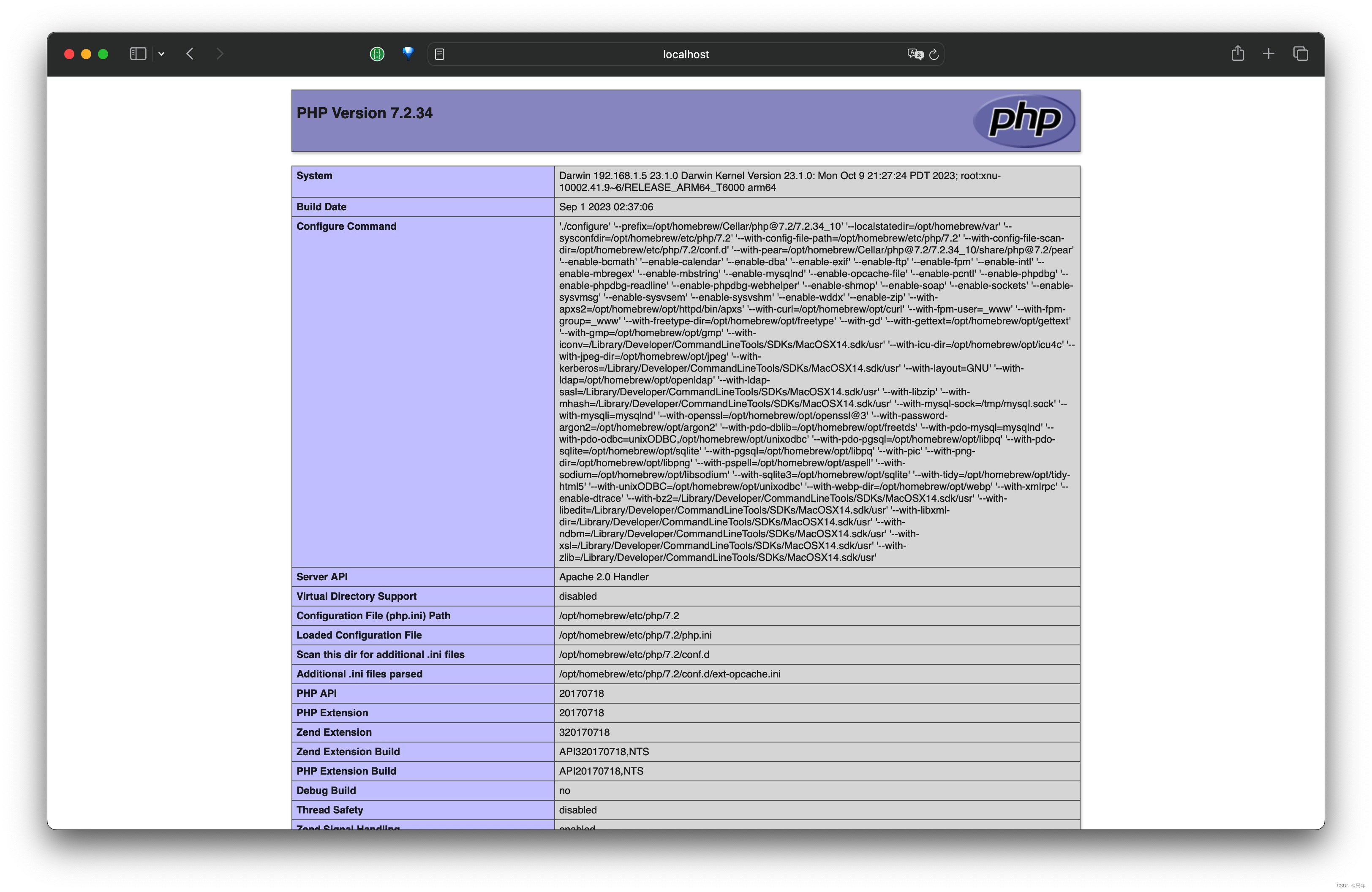

现在可以在浏览器中输入 http://127.0.0.1/info.php,如果一切正常将会出现 PHP 信息的页面。
到此为止,你已经乐成设置了 PHP 环境,并可以开始 PHP 开发了。

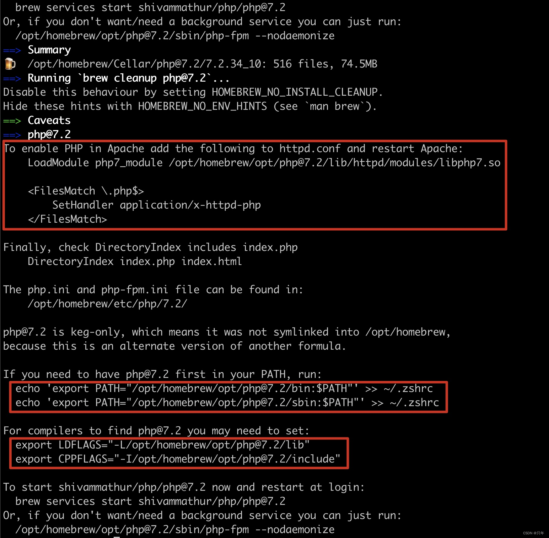

  1. brew tap shivammathur/php
  2. brew install shivammathur/php/php@7.2
安装完成提示
  1. The php.ini and php-fpm.ini file can be found in:
  2.     /opt/homebrew/etc/php/7.2/
  3. php@7.2 is keg-only, which means it was not symlinked into /opt/homebrew,
  4. because this is an alternate version of another formula.
  5. If you need to have php@7.2 first in your PATH, run:
  6.   echo 'export PATH="/opt/homebrew/opt/php@7.2/bin:$PATH"' >> ~/.zshrc
  7.   echo 'export PATH="/opt/homebrew/opt/php@7.2/sbin:$PATH"' >> ~/.zshrc
  8. For compilers to find php@7.2 you may need to set:
  9.   export LDFLAGS="-L/opt/homebrew/php@7.2/lib"
  10.   export CPPFLAGS="-I/opt/homebrew/php@7.2/include"
  11. To restart shivammathur/php/php@7.2 after an upgrade:
  12.   brew services restart shivammathur/php/php@7.2
  13. Or, if you don't want/need a background service you can just run:
  14.   /usr/local/opt/php@7.2/sbin/php-fpm --nodaemonize

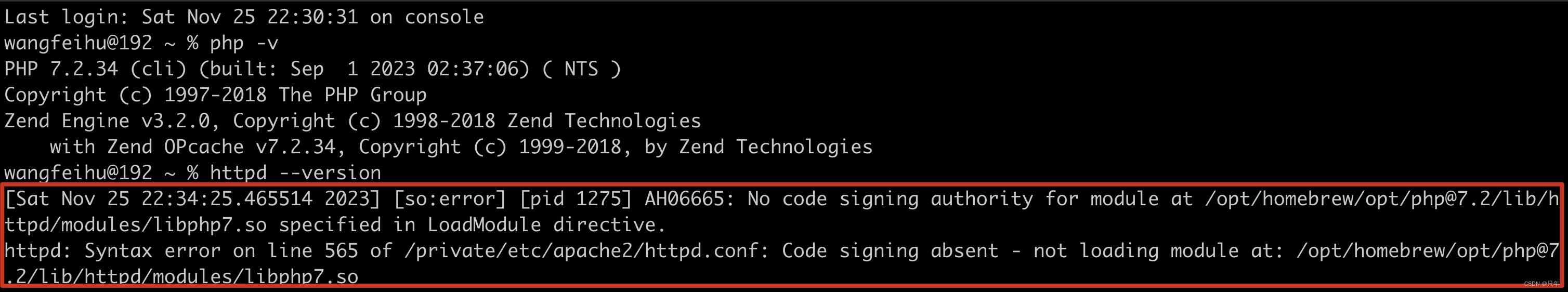

Q2、No code signing authority for module at /opt/homebrew/opt/php@7.2/lib/httpd/modules/libphp7.so specified in LoadModule directive.
答:MacOS 12版本不再自带php,利用brew安装php8.0 之后设置httpd.conf遇到以上标题错误,必要重新签名

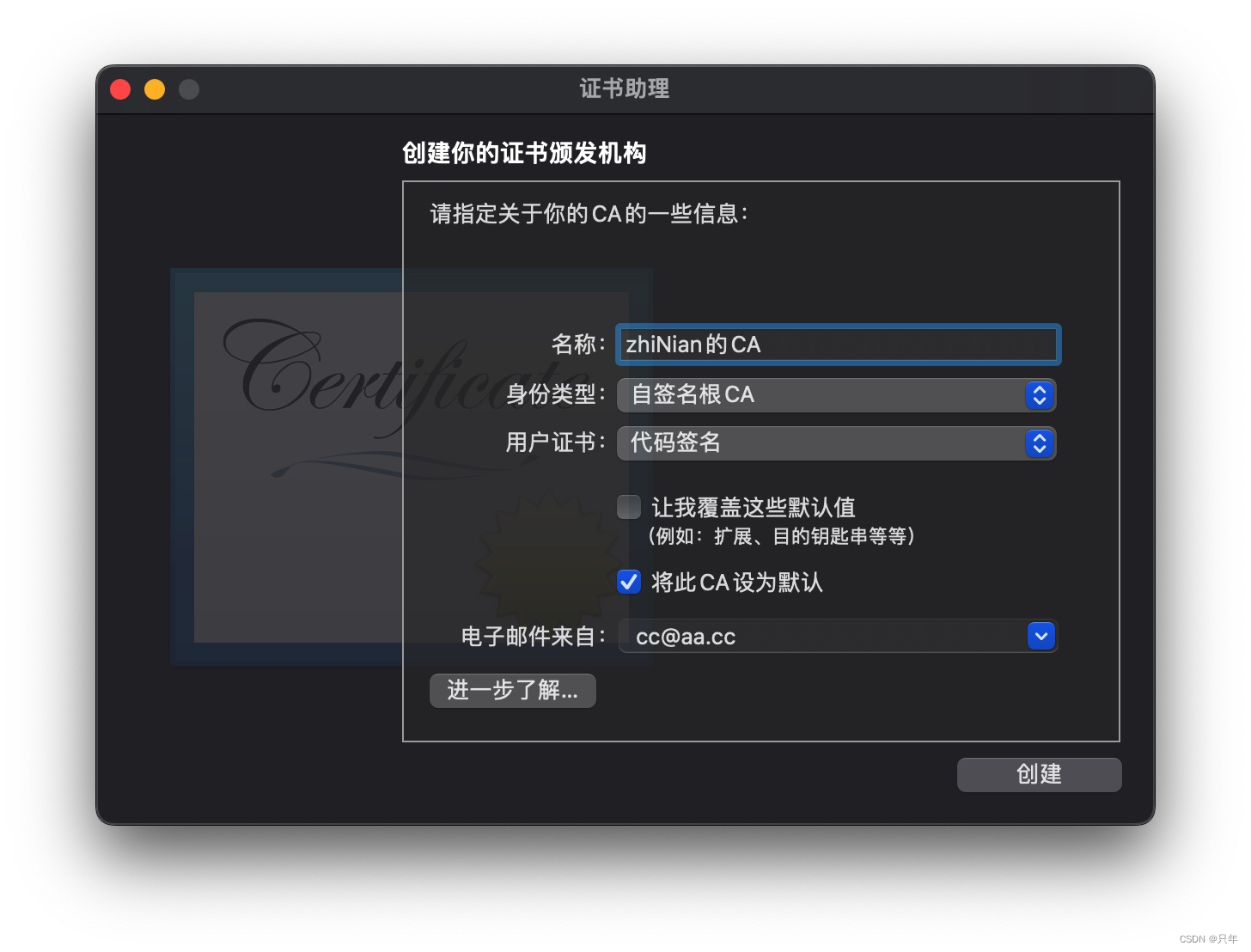

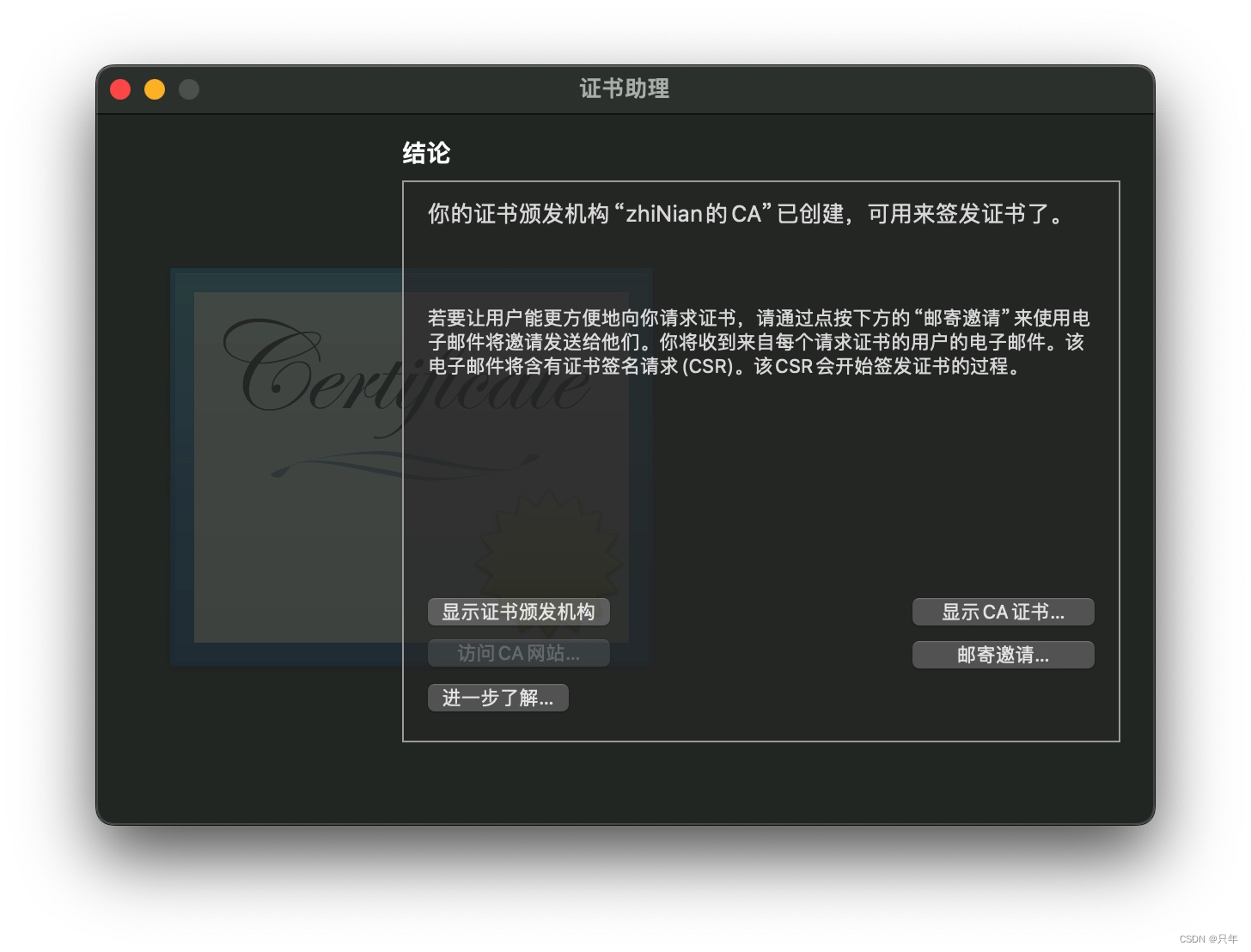

Q2.1 起首在·钥匙串访问· -> 证书助理 -> 创建证书颁布机构(代码签名)

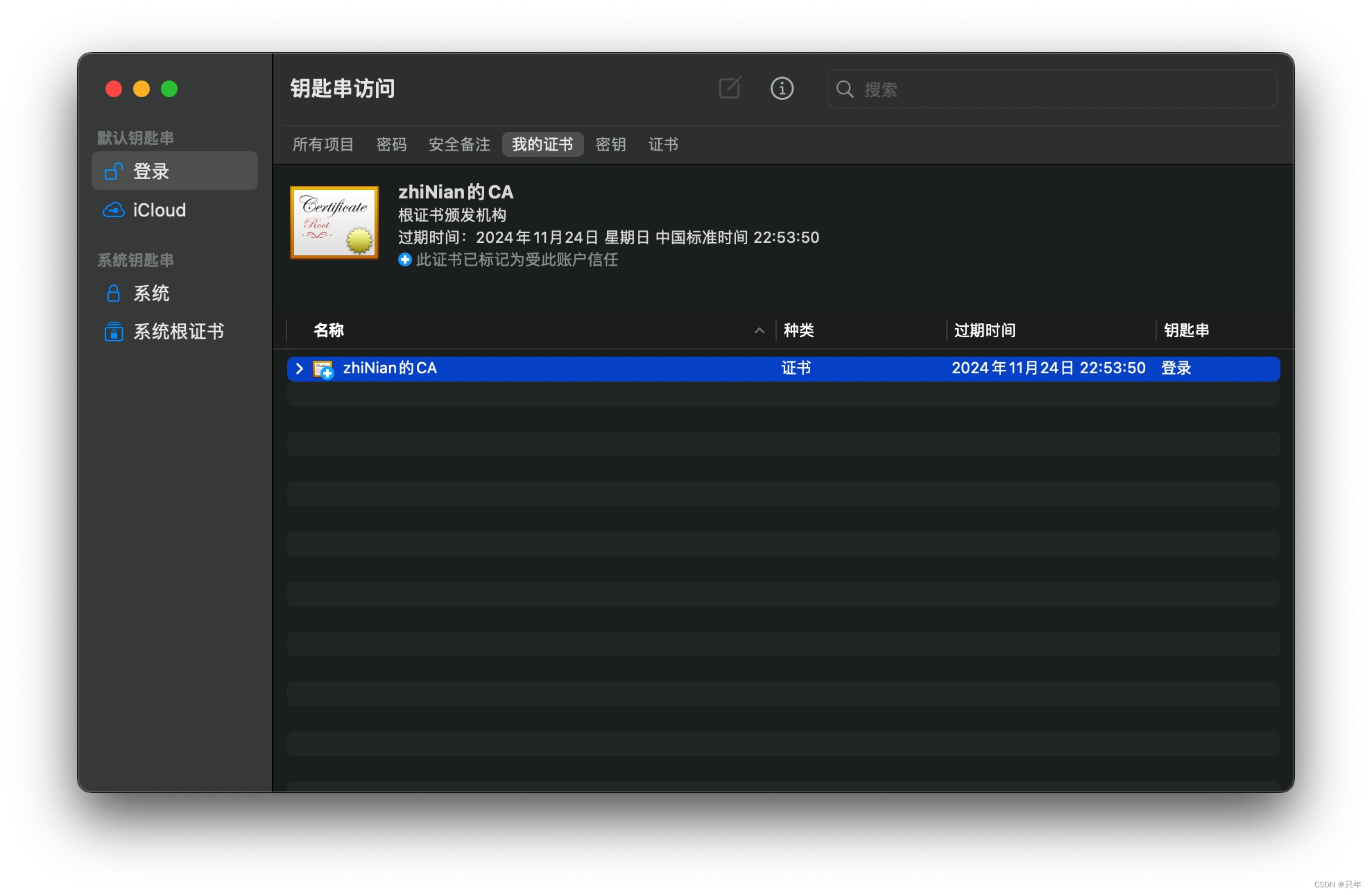

Q2.2 再回到·钥匙串访问· 找到 Ls RootCA

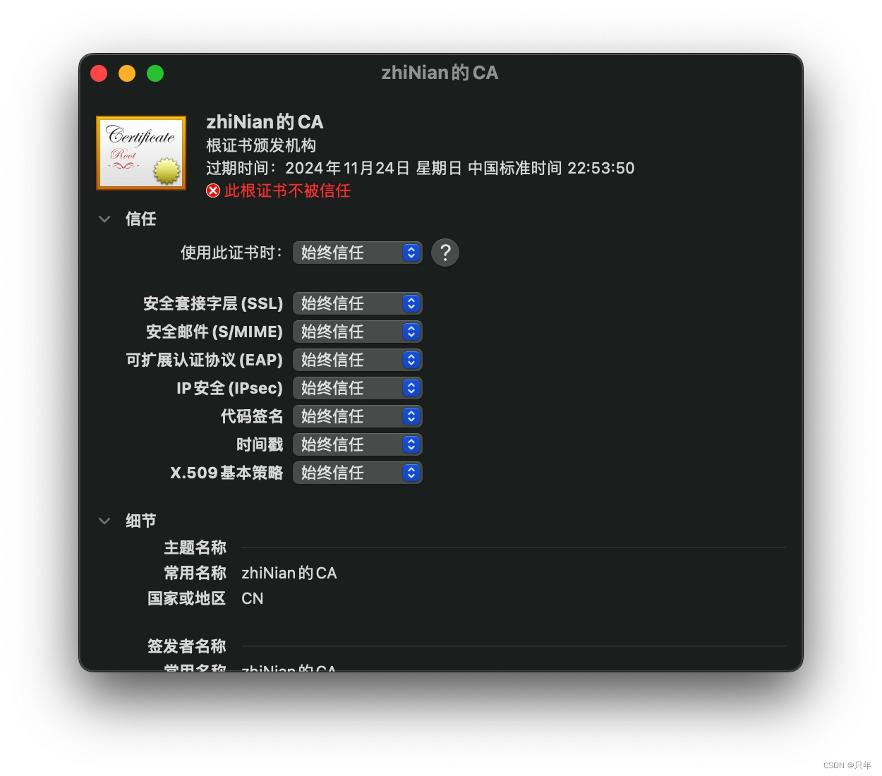

Q2.3 选择右键简介始终信托
Q2.4 在终端 给php动态库签名
  1. sudo codesign --sign "zhiNian的CA" --force --keychain  ~/Library/Keychains/login.keychain-db /opt/homebrew/opt/php@7.2/lib/httpd/modules/libphp7.so

访问 http://127.0.0.1/index.php
