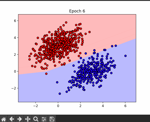

动态显示训练过程中的数据和模子的决策边界
安装
  1. pip install tensorflow==2.13.1
  2. pip install matplotlib==3.7.5
  3. pip install numpy==1.24.3
源码
  1. import numpy as np
  2. import tensorflow as tf
  3. from tensorflow.keras.models import Sequential
  4. from tensorflow.keras.layers import Dense
  5. import matplotlib.pyplot as plt
  6. from matplotlib.colors import ListedColormap
  7. # 生成数据
  8. np.random.seed(0)
  9. num_samples_per_class = 500
  10. negative_samples = np.random.multivariate_normal(
  11.     mean=[0, 3],
  12.     cov=[[1, 0.5], [0.5, 1]],
  13.     size=num_samples_per_class
  14. )
  15. positive_samples = np.random.multivariate_normal(
  16.     mean=[3, 0],
  17.     cov=[[1, 0.5], [0.5, 1]],
  18.     size=num_samples_per_class
  19. )
  20. inputs = np.vstack((negative_samples, positive_samples)).astype(np.float32)
  21. targets = np.vstack((np.zeros((num_samples_per_class, 1)), np.ones((num_samples_per_class, 1)))).astype(np.float32)
  22. # 将数据分为训练集和测试集
  23. train_size = int(0.8 * len(inputs))
  24. X_train, X_test = inputs[:train_size], inputs[train_size:]
  25. y_train, y_test = targets[:train_size], targets[train_size:]
  26. # 构建二分类模型
  27. model = Sequential([
  28.     # 输入层:输入形状为 (2,)
  29.     # 第一个隐藏层:包含 4 个节点,激活函数使用 ReLU
  30.     Dense(4, activation='relu', input_shape=(2,)),
  31.
  32.     # 输出层:包含 1 个节点,激活函数使用 Sigmoid(因为是二分类问题)
  33.     Dense(1, activation='sigmoid')
  34. ])
  35. # 编译模型
  36. # 指定优化器为 Adam,损失函数为二分类交叉熵,评估指标为准确率
  37. model.compile(optimizer='adam', loss='binary_crossentropy', metrics=['accuracy'])
  38. # 准备绘图
  39. fig, ax = plt.subplots()
  40. cmap_light = ListedColormap(['#FFAAAA', '#AAAAFF'])
  41. cmap_bold = ListedColormap(['#FF0000', '#0000FF'])
  42. # 动态绘制函数
  43. def plot_decision_boundary(epoch, logs):
  44.     ax.clear()
  45.     x_min, x_max = X_train[:, 0].min() - 1, X_train[:, 0].max() + 1
  46.     y_min, y_max = X_train[:, 1].min() - 1, X_train[:, 1].max() + 1
  47.     xx, yy = np.meshgrid(np.arange(x_min, x_max, 0.1),
  48.                          np.arange(y_min, y_max, 0.1))
  49.     grid = np.c_[xx.ravel(), yy.ravel()]
  50.     probs = model.predict(grid).reshape(xx.shape)
  51.     ax.contourf(xx, yy, probs, alpha=0.8, cmap=cmap_light)
  52.     ax.scatter(X_train[:, 0], X_train[:, 1], c=y_train[:, 0], edgecolor='k', cmap=cmap_bold)
  53.     ax.set_title(f'Epoch {epoch+1}')
  54.     plt.draw()
  55.     plt.pause(0.01)
  56. # 自定义回调函数
  57. class PlotCallback(tf.keras.callbacks.Callback):
  58.     def on_epoch_end(self, epoch, logs=None):
  59.         plot_decision_boundary(epoch, logs)
  60. # 训练模型并动态显示
  61. plot_callback = PlotCallback()
  62. model.fit(X_train, y_train, epochs=50, batch_size=16, callbacks=[plot_callback])
  63. # 评估模型
  64. loss, accuracy = model.evaluate(X_test, y_test)
  65. print(f"Test Loss: {loss}")
  66. print(f"Test Accuracy: {accuracy}")
  67. plt.show()
