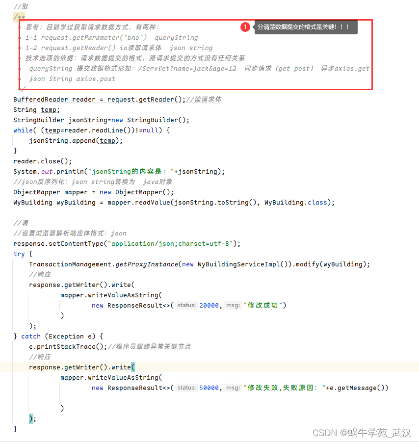

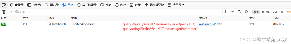

axios.get和axios.post发送参数区别
axios.get(url,{params:{}}),这种参数传递时,按照querystring【格式:?key=value&key=value】向控制器发送的,所以controller里面就可以利用request.getParameter();

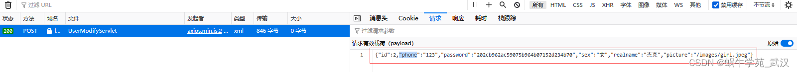

axios.post(url,对象)这种情况传递参数是,按照jsonstring【格式:{“key”:value,“key”:value}】,控制器 里面对于jsonstring格式无法利用传统request.getParameter()获取中。控制器只能利用jackson的反序列方案解析请求参数。
  1.                 //1-1 获取请求体
  2.         BufferedReader reader = request.getReader();//读取请求体
  3.         //1-2 从reader读取字符串
  4.         StringBuilder requestBody=new StringBuilder();
  5.         String temp;
  6.         while((temp=reader.readLine())!=null){
  7.             requestBody.append(temp);
  8.         }
  9.         System.out.println("请求协议发送来的数据有:"+requestBody);
  10.                 //1-3 依靠ObjectMapper将请求体传递来的jsonstring反序列化成java对象User
  11.         ObjectMapper mapper=new ObjectMapper();
  12.         Users users = mapper.readValue(requestBody.toString(), Users.class);
细节:axios.post发送参数的方式是:jsonstring,所以控制器处理jsonstring的方式是json字符串的反序列化

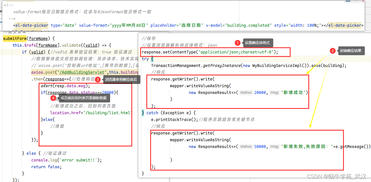

building/add.html发送新增请求请求
AddBuildingServlet处理新增楼栋的请求
  1. @WebServlet(name = "AddBuildingServlet", value = "/AddBuildingServlet")
  2. public class AddBuildingServlet extends HttpServlet {
  3.     @Override
  4.     protected void service(HttpServletRequest request, HttpServletResponse response) throws ServletException, IOException {
  5.         System.out.println("新增楼栋的请求以接收到");
  6.         //1. axios.post提交的json string数据获取:
  7.         // 获取请求协议提交的json String
  8.         BufferedReader reader = request.getReader();//读请求体
  9.         String temp;
  10.         StringBuilder jsonString=new StringBuilder();
  11.         while( (temp=reader.readLine())!=null) {
  12.             jsonString.append(temp);
  13.         }
  14.         reader.close();
  15.         System.out.println("jsonString的内容是:"+jsonString);
  16.         //1-1 json String ----> java对象  json反序列化
  17.         ObjectMapper mapper=new ObjectMapper();
  18.         WyBuilding building = mapper.readValue(jsonString.toString(), WyBuilding.class);
  19.         System.out.println("提交楼栋信息时:"+building);
  20.         //保存
  21.         //设置浏览器解析响应体格式:json
  22.         response.setContentType("application/json;charset=utf-8");
  23.         try {
  24.             TransactionManagement.getProxyInstance(new WyBuildingServiceImpl()).save(building);
  25.             //响应
  26.             response.getWriter().write(
  27.                 mapper.writeValueAsString(
  28.                     new ResponseResult<>(20000,"新增成功")
  29.                 )
  30.             );
  31.         } catch (Exception e) {
  32.             e.printStackTrace();//程序员跟踪异常关键节点
  33.             //响应
  34.             response.getWriter().write(
  35.                 mapper.writeValueAsString(
  36.                     new ResponseResult<>(50000,"新增失败,失败原因:"+e.getMessage())
  37.                 )
  38.             );
  39.         }
  40.     }
  41. }
细节

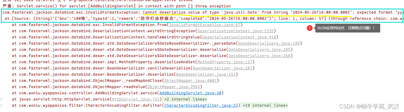

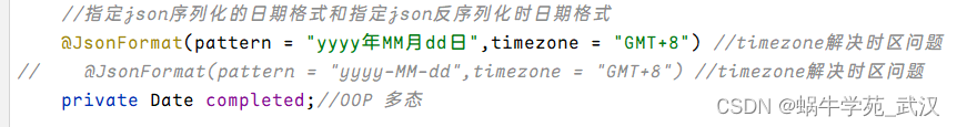

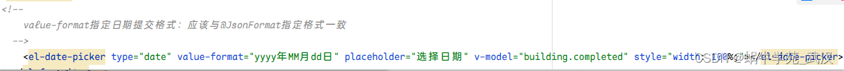

添加楼栋时,楼栋的建成时间在Servlet中处理时会抛出非常:
这个非常发生的根本原因是:jackson在处理JSON反序列化时,因为请求提交的日期格式和jackson用来转换的格式不一致造成的,怎么办理呢?我们通太过析可以发现:Jackson处理日期时,是根据我们在Building实体类的completed属性的@JsonFormat指定的日期格式举行转换的,
所以我们只有将请求提交的日期格式设置为“yyyy年MM月dd日”的格式才可以,el-date-picker组件中“value-format”属性就可以设置数据提交时的格式。详细代码如下所示:

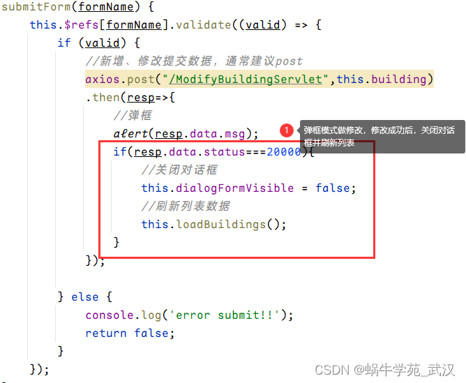

    //修改按钮单击事件
    handleEdit(index, row) {
    //修改用的对话框弹出
    this.dialogFormVisible = true;
    console.log("index: ",index);
    //row本身就是要修改的数据对象,ElementUI修改不用id查询数据库了
    console.log("row: ",row);
    //表现修改的楼栋信息
    this.building={…row};//地址
  • 保存修改后的楼栋信息,修改成功的情况下,关闭修改对话框并革新列表页面

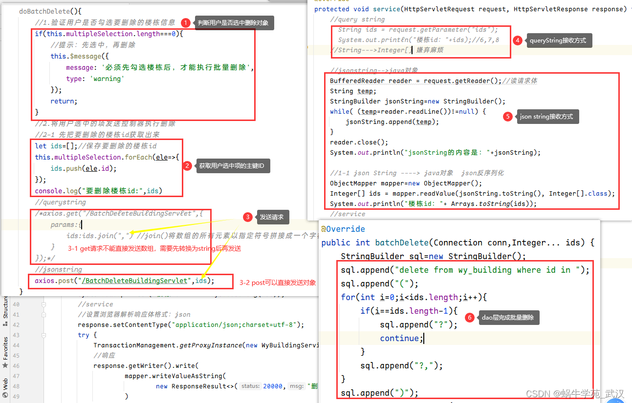

批量删除楼栋
需求分析:
批量删除楼栋信息时,我们先要判定用户是否勾选“删除楼栋”,假如没有勾选给出提示消息,勾选了楼栋信息就给控制器发送请求完成删除。
代码实现
  • BuildingDao.java
    @Override
    public int batchDelete(Connection conn,Integer… ids) {
    StringBuilder sql=new StringBuilder();
    sql.append(“delete from wy_building where id in “);
    sql.append(”(”);
    for(int i=0;i<ids.length;i++){
    if(i==ids.length-1){
    sql.append(“?”);
    continue;
    sql.append(“?,”);
    sql.append(“)”);
    return Dbutils.noQuary(
    conn,
    sql.toString(),
    ids);
  • BuildingService.java代码略

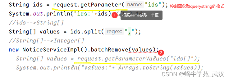

  • list.html发送批量删除的请求axios.get发送,servlet处理批量删除请求的querystring参数
axios.get发送批量删除请求,控制器吸取数据后的处理思路,参考代码如下:

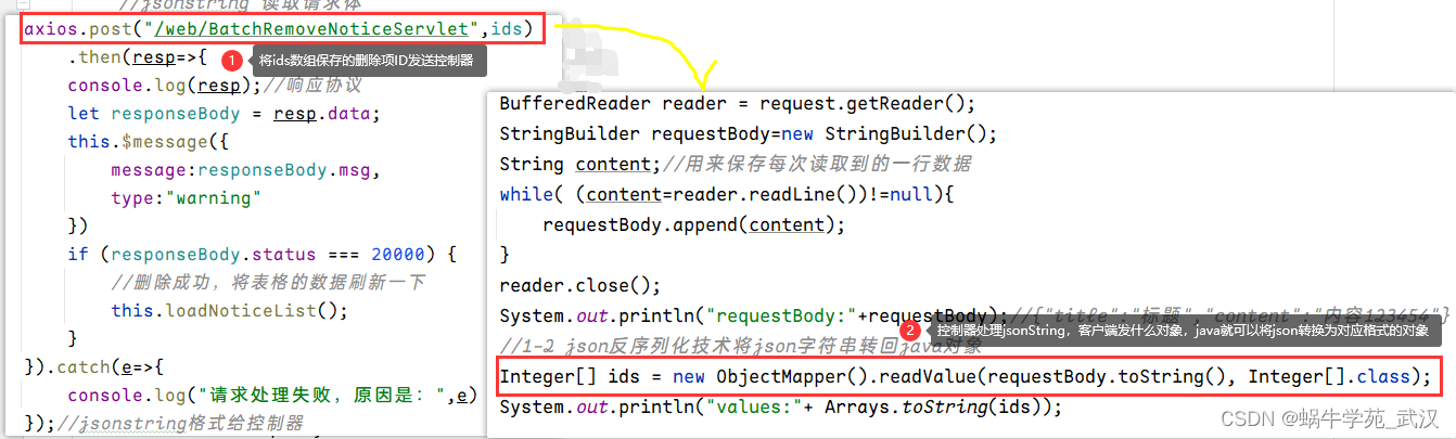

  • list.html发送批量删除的请求axios.post发送,servlet处理批量删除请求的jsonstring参数
通过axios.post和axios.get分别处理批量删除案例得出心得:queryString格式和jsonString格式在控制器中处理方式是不一样的
QueryString的请求参数,控制器吸取:
String value=request.getParameter(“name”);
根据参数传递时的name吸取对应的value,且value一定是String范例
request.getReader()读取请求体,再通过ObjectMapper的readValue将读取的请求体(着实就是json字符串)转换为java程序必要的java对象,完成后续的数据处理

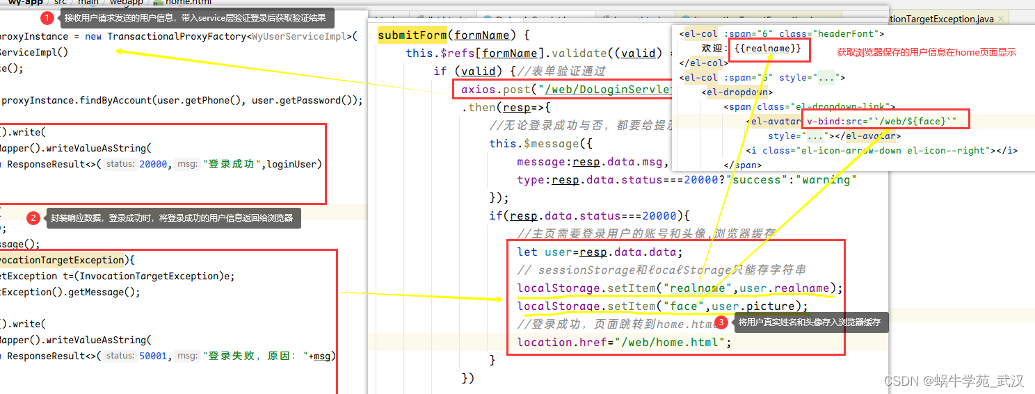

DoLoginServlet处理登录请求
  1. @Override
  2. protected void service(HttpServletRequest request, HttpServletResponse response) throws ServletException, IOException {
  3.     response.setContentType("application/json;charset=utf-8");
  4.     try {
  5.         BufferedReader reader = request.getReader();
  6.         StringBuilder requestBody=new StringBuilder();
  7.         String content;//用来保存每次读取到的一行数据
  8.         while( (content=reader.readLine())!=null){
  9.             requestBody.append(content);
  10.         }
  11.         reader.close();
  12.         System.out.println("requestBody:"+requestBody);
  13.         //1-2 json反序列化技术将json字符串转回java对象
  14.         WyUser user = new ObjectMapper().readValue(requestBody.toString(), WyUser.class);
  15.         //2.调
  16.         WyUserServiceImpl proxyInstance = new TransactionalProxyFactory<WyUserServiceImpl>(
  17.             new WyUserServiceImpl()
  18.         ).getTxProxyInstance();
  19.         WyUser loginUser = proxyInstance.findByAccount(user.getPhone(), user.getPassword());
  20.         response.getWriter().write(
  21.             new ObjectMapper().writeValueAsString(
  22.                 new ResponseResult<>(20000,"登录成功",loginUser)
  23.             )
  24.         );
  25.     } catch (Exception e) {
  26.         e.printStackTrace();
  27.         String msg=e.getMessage();
  28.         if(e instanceof InvocationTargetException){
  29.             InvocationTargetException t=(InvocationTargetException)e;
  30.             msg=t.getTargetException().getMessage();
  31.         }
  32.         response.getWriter().write(
  33.             new ObjectMapper().writeValueAsString(
  34.                 new ResponseResult<>(50001,"登录失败,原因:"+msg)
  35.             )
  36.         );
  37.     }
  38. }
细节:
用户登录成功后,必要将登任命户的真实姓名和头像存入欣赏器缓存,页面跳转到home.html后,在home页面表现欢迎消息

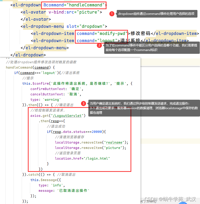

登出系统

JSON反序列化时 日期范例转换问题
