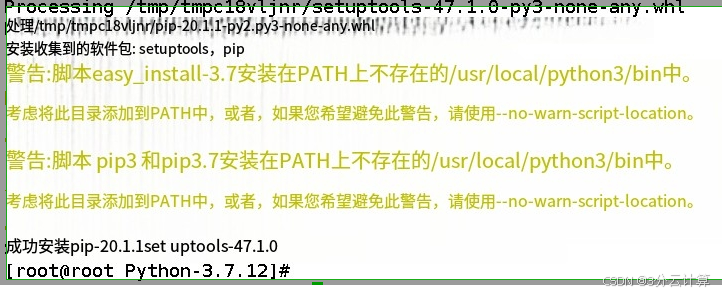

   Processing /tmp/tmpc18vljnr/pip-20.1.1-py2.py3-none-any.whl
Installing collected packages: setuptools, pip
  WARNING: The script easy_install-3.7 is installed in '/usr/local/python3/bin' which is not on PATH.
  Consider adding this directory to PATH or, if you prefer to suppress this warning, use --no-warn-script-location.
  WARNING: The scripts pip3 and pip3.7 are installed in '/usr/local/python3/bin' which is not on PATH.
Successfully installed pip-20.1.1 setuptools-47.1.0
[root@root Python-3.7.12]#
根据提示 :
警告:脚本easy_install-3.7安装在PATH上不存在的/usr/local/python3/bin中。
考虑将此目录添加到PATH中,大概,如果您渴望制止此警告,请使用--no-warn-script-location。
警告:脚本 pip3和pip3.7安装在PATH上不存在的/usr/local/python3/bin中。

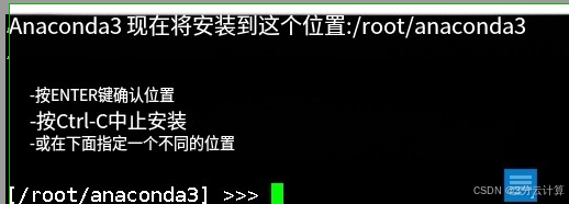

    Anaconda3 will now be installed into this location:
/root/anaconda3
    - Press ENTER to confirm the location
  - Press CTRL-C to abort the installation
  - Or specify a different location below
  [/root/anaconda3] >>>
  以上翻译如下:
按Enter确认位置:按下Enter键确认安装Anaconda3到/root/anaconda3
等待安装完成:安装步调会开始复制文件和安装Anaconda3到指定位置。请耐心等待安装完成,过程可能需要一些时间取决于体系性能和文件大小

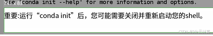

Do you wish the installer to initialize Anaconda3
by running conda init? [yes|no]
[no] >>> yes
  Do you wish the installer to initialize Anaconda3 的意思是 您渴望安装步调初始化 Anaconda3 吗?
安装完成后,你需要配置Anaconda3的环境变量,就是步骤5

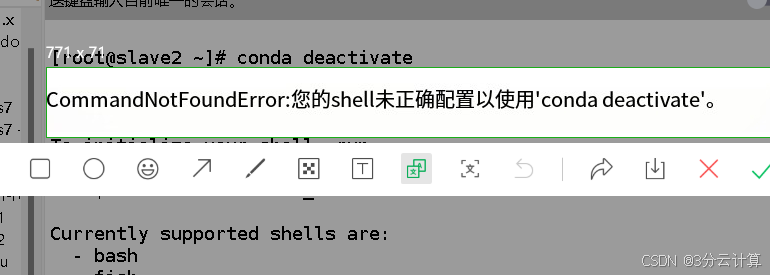

    1. [root@slave2 ~]# conda activate myenv
    2. <strong>CommandNotFoundError: Your shell has not been properly configured to use 'conda activate'.
    3. To initialize your shell, run
    4.     $ conda init <SHELL_NAME>
    5. Currently supported shells are:
    6.   - bash

    12. See 'conda init --help' for more information and options.
    13. IMPORTANT: You may need to close and restart your shell after running 'conda init'.
    14. </strong>

6.退出当前环境:
  1. <strong>Copyconda deactivater</strong>
退出当前环境,如果退出环境报错那么 ,如下
   [root@slave2 ~]# conda deactivate
  CommandNotFoundError: Your shell has not been properly configured to use 'conda deactivate'.
  - bash
根据提供的错误信息,使用 conda deactivate 命令时出现问题
错误提示中提到:
您的 shell 尚未精确配置以使用 ‘conda deactivate’ 命令
运行“conda init”后,您可能需要关闭并重新启动您的shell。
根据提示,运行以下命令来初始化shell:
conda init shell名称
   conda init bash
  运行完上述命令后,可能需要关闭并重新启动 shell,以使更改生效。然后,应该能够成功使用 ‘conda deactivate’ 命令
