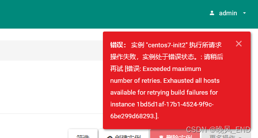

  1. 错误: 实例 "centos7-init2" 执行所请求操作失败,实例处于错误状态。: 请稍后再试 [错误: Exceeded maximum number of retries. Exhausted all hosts available for retrying build failures for instance 1bd5d1af-17b1-4524-9f9c-6be299d68293.].
在dashboard内,查看实例详情,可以看到错误日志:
  1. 消息
  2.     Exceeded maximum number of retries. Exhausted all hosts available for retrying build failures for instance 17fe6f00-4560-476a-a79b-e6f62d866155.
  3. 编码
  4.     500
  5. 详情
  6.     Traceback (most recent call last): File "/usr/lib/python2.7/site-packages/nova/conductor/manager.py", line 624, in build_instances raise exception.MaxRetriesExceeded(reason=msg) MaxRetriesExceeded: Exceeded maximum number of retries. Exhausted all hosts available for retrying build failures for instance 17fe6f00-4560-476a-a79b-e6f62d866155.

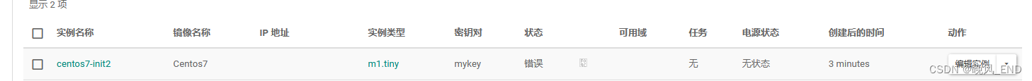

虚拟机实例状态是:
解析:
错误代码是500,并且虚拟机没有获取到fix ip地址,上面末了一图IP地址那是空缺的
以上表明错误发生在网络层面,错误提示是在尝试N次后,虚拟机实例仍无法调度,因此,错误日志必定在nova这个服务内有所体现
