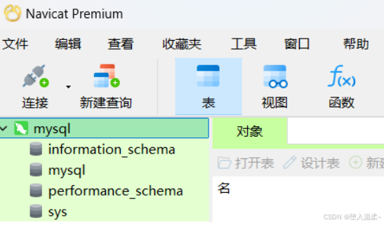

11.长途登录查看库,发现脚色不生效
12.脚色不生效的处置惩罚
  1. #在配置文件中添加activate_all_roles_on_login=on
  2. [root@004 mysql]# vim /usr/local/mysql/my.cnf
  3. [mysqld]
  4. basedir=/usr/local/mysql
  5. datadir=/usr/local/mysql/data
  6. socket=/tmp/mysql.sock
  7. activate_all_roles_on_login=on
glibc安装,my.cnf在项目目次之下;
rpm安装,my.cnf文件在/etc/my.cnf下;
13.长途登录工具刷新,就能看到库了

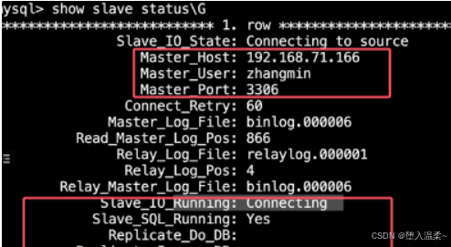

11.查看从服务器的状态信息
  1. mysql> show slave status\G

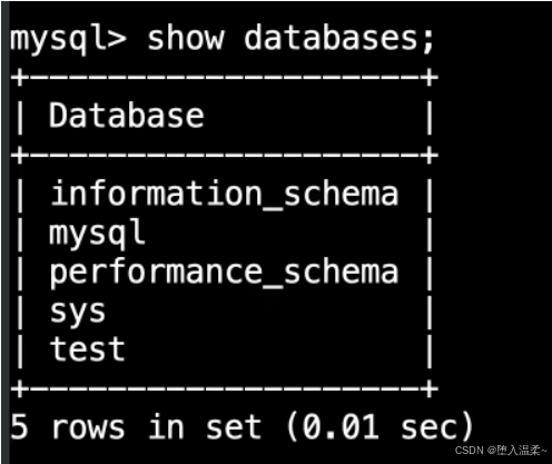

  26. 1 row in set (0.01 sec)
  27. #查看数据库
  28. mysql> show databases;
  29. +--------------------+
  30. | Database           |
  31. +--------------------+
  32. | information_schema |
  33. | mysql              |
  34. | performance_schema |
  35. | sys                |
  36. | test               |
  37. +--------------------+
  38. 5 rows in set (0.00 sec)
从数据库就会同步
