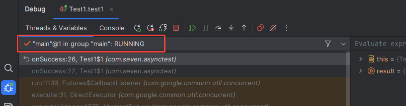

执行 callback 的线程池这里指定为 MoreExecutors#directExecutor ,那么这里执行打印 result 的线程是主线程
在 MoreExecutors#directExecutor 中,可以看到界说是如许的:
  1. public final class MoreExecutors {
  2.     // 省略了类内其他成员
  3.     public static Executor directExecutor() {
  4.         return DirectExecutor.INSTANCE;
  5.   }
  6. }

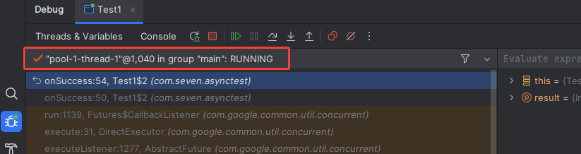

再看下面这个例子:
  1. ExecutorService executor = Executors.newSingleThreadExecutor();
  2. SettableFuture<Integer> future = SettableFuture.create();
  3. // 使用其他线程去 set 对应的结果。
  4. executor.submit(() -> {
  5.     // 增加线程 sleep 的逻辑。
  6.     try {
  7.         Thread.sleep(1000);
  8.     } catch (InterruptedException e) {
  9.         e.printStackTrace();
  10.     }
  11.     future.set(1);
  12. });
  13. Futures.addCallback(future, new FutureCallback<>() {
  14.     @Override
  15.     public void onSuccess(Integer result) {
  16.         // 此时就会被 executor 的线程执行
  17.         System.out.println("result=" + result + "线程名:" + Thread.currentThread().getName());//此时还未打印出来,主线程就结束了
  18.     }
  19.     @Override
  20.     public void onFailure(Throwable t) {
  21.     }
  22. }, MoreExecutors.directExecutor());
那么这里清晰了:
  • 如果 future 已经完成,那么 MoreExecutor#directExecutor 表示当前线程;
  • 如果 future 未完成,那么 MoreExecutor#directExecutor 就是将来完成 future 的线程。
因此其实详细执行回调的线程某种水平上是不确定的

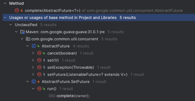

那哪些方法会来调用这个complete方法呢?

  23.          */
  24.         Runnable task = requireNonNull(curr.task);
  25.         if (task instanceof SetFuture) {
  26.           SetFuture<?> setFuture = (SetFuture<?>) task;
  27.           // We unwind setFuture specifically to avoid StackOverflowErrors in the case of long
  28.           // chains of SetFutures
  29.           // Handling this special case is important because there is no way to pass an executor to
  30.           // setFuture, so a user couldn't break the chain by doing this themselves.  It is also
  31.           // potentially common if someone writes a recursive Futures.transformAsync transformer.
  32.           future = setFuture.owner;
  33.           if (future.value == setFuture) {
  34.             Object valueToSet = getFutureValue(setFuture.future);
  35.             if (ATOMIC_HELPER.casValue(future, setFuture, valueToSet)) {
  36.               continue outer;
  37.             }
  38.           }
  39.           // other wise the future we were trying to set is already done.
  40.         } else {
  41.           /*
  42.            * requireNonNull is safe because the listener stack never contains TOMBSTONE until after
  43.            * clearListeners.
  44.            */
  45.           executeListener(task, requireNonNull(curr.executor));// 交给listener拥有的线程池进行处理
  46.         }
  47.       }
  48.       break;
  49.     }
  50.   }
