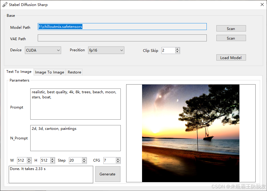

拉取完成后,就可以调用了。为了更直观,本文使用了Winform作为演示。需要使用.Net 8.0以上的环境支持。如果想要使用低版本的.net,请自行修改StableDiffusionSharp源码编译。
作为演示,主界面绘制得较为简单。
主要功能会合在Load Model 和 Generate两个按钮中。全部的功能代码均贴在下面了。此中Sd_StepProgress这个变乱可以看到正在进行的步数和去噪的图像结果。
  1. using StableDiffusionSharp;
  2. using System.Diagnostics;
  3. namespace StableDiffusionDemo_Winform
  4. {
  5.         public partial class FormMain : Form
  6.         {
  7.                 string modelPath = string.Empty;
  8.                 string vaeModelPath = string.Empty;
  9.                 StableDiffusionSharp.StableDiffusion sd;
  10.                 public FormMain()
  11.                 {
  12.                         InitializeComponent();
  13.                 }
  14.                 private void FormMain_Load(object sender, EventArgs e)
  15.                 {
  16.                         ComboBox_Device.SelectedIndex = 0;
  17.                         ComboBox_Precition.SelectedIndex = 0;
  18.                 }
  19.                 private void Button_ModelScan_Click(object sender, EventArgs e)
  20.                 {
  21.                         FileDialog fileDialog = new OpenFileDialog();
  22.                         fileDialog.Filter = "Model files|*.safetensors;*.ckpt;*.pt;*.pth|All files|*.*";
  23.                         if (fileDialog.ShowDialog() == DialogResult.OK)
  24.                         {
  25.                                 TextBox_ModelPath.Text = fileDialog.FileName;
  26.                                 modelPath = fileDialog.FileName;
  27.                         }
  28.                 }
  29.                 private void Button_ModelLoad_Click(object sender, EventArgs e)
  30.                 {
  31.                         if (File.Exists(modelPath))
  32.                         {
  33.                                 SDDeviceType deviceType = ComboBox_Device.SelectedIndex == 0 ? SDDeviceType.CUDA : SDDeviceType.CPU;
  34.                                 SDScalarType scalarType = ComboBox_Precition.SelectedIndex == 0 ? SDScalarType.Float16 : SDScalarType.Float32;
  35.                                 Task.Run(() =>
  36.                                 {
  37.                                         base.Invoke(() => Button_ModelLoad.Enabled = false);
  38.                                         sd = new StableDiffusionSharp.StableDiffusion(deviceType, scalarType);
  39.                                         sd.StepProgress += Sd_StepProgress;
  40.                                         sd.LoadModel(modelPath, vaeModelPath);
  41.                                         base.Invoke(() =>
  42.                                         {
  43.                                                 Button_ModelLoad.Enabled = true;
  44.                                                 Button_Generate.Enabled = true;
  45.                                                 Label_State.Text = "Model loaded.";
  46.                                         });
  47.                                 });
  48.                         }
  49.                 }
  50.                 private void Button_VAEModelScan_Click(object sender, EventArgs e)
  51.                 {
  52.                         FileDialog fileDialog = new OpenFileDialog();
  53.                         fileDialog.Filter = "Model files|*.safetensors;*.ckpt;*.pt;*.pth|All files|*.*";
  54.                         if (fileDialog.ShowDialog() == DialogResult.OK)
  55.                         {
  56.                                 TextBox_VaePath.Text = fileDialog.FileName;
  57.                                 vaeModelPath = fileDialog.FileName;
  58.                         }
  59.                 }
  60.                 private void Sd_StepProgress(object? sender, StableDiffusionSharp.StableDiffusion.StepEventArgs e)
  61.                 {
  62.                         base.Invoke(() =>
  63.                         {
  64.                                 Label_State.Text = $"Progress: {e.CurrentStep}/{e.TotalSteps}";
  65.                                 if (e.VaeApproxImg != null)
  66.                                 {
  67.                                         MemoryStream memoryStream = new MemoryStream();
  68.                                         e.VaeApproxImg.Write(memoryStream, ImageMagick.MagickFormat.Jpg);
  69.                                         base.Invoke(() =>
  70.                                         {
  71.                                                 PictureBox_Output.Image = Image.FromStream(memoryStream);
  72.                                         });
  73.                                 }
  74.                         });
  75.                 }
  76.                 private void Button_Generate_Click(object sender, EventArgs e)
  77.                 {
  78.                         string prompt = TextBox_Prompt.Text;
  79.                         string nprompt = TextBox_NPrompt.Text;
  80.                         int step = (int)NumericUpDown_Step.Value;
  81.                         float cfg = (float)NumericUpDown_CFG.Value;
  82.                         long seed = 0;
  83.                         int width = (int)NumericUpDown_Width.Value;
  84.                         int height = (int)NumericUpDown_Height.Value;
  85.                         int clipSkip = (int)NumericUpDown_ClipSkip.Value;
  86.                         Task.Run(() =>
  87.                         {
  88.                                 Stopwatch stopwatch = Stopwatch.StartNew();
  89.                                 base.Invoke(() =>
  90.                                 {
  91.                                         Button_ModelLoad.Enabled = false;
  92.                                         Button_Generate.Enabled = false;
  93.                                         Label_State.Text = "Generating...";
  94.                                 });
  95.                                 ImageMagick.MagickImage image = sd.TextToImage(prompt, nprompt, clipSkip, width, height, step, seed, cfg);
  96.                                 MemoryStream memoryStream = new MemoryStream();
  97.                                 image.Write(memoryStream, ImageMagick.MagickFormat.Jpg);
  98.                                 base.Invoke(() =>
  99.                                 {
  100.                                         PictureBox_Output.Image = Image.FromStream(memoryStream);
  101.                                         Button_ModelLoad.Enabled = true;
  102.                                         Button_Generate.Enabled = true;
  103.                                         Label_State.Text = $"Done. It takes {stopwatch.Elapsed.TotalSeconds.ToString("f2")} s";
  104.                                 });
  105.                                 GC.Collect();
  106.                         });
  107.                 }
  108.         }
  109. }
