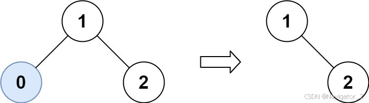

Example 1:
   Input: root = [1,0,2], low = 1, high = 2
Output:[1,null,2]
  Example 2:

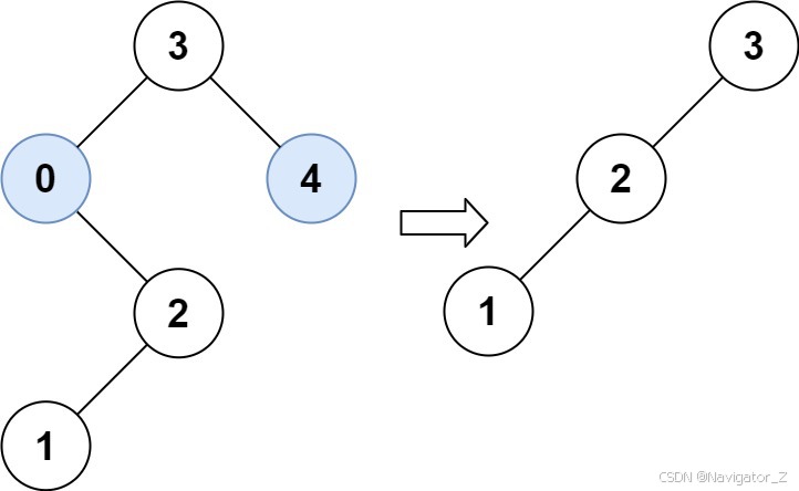

   Input: root = [3,0,4,null,2,null,null,1], low = 1, high = 3
Output: [3,2,null,1]

Ideas:
  • If root->val < low, the current node and its left subtree are discarded (too small).
  • If root->val > high, the current node and its right subtree are discarded (too big).
  • Otherwise, recursively trim the left and right subtrees and return the current node.
