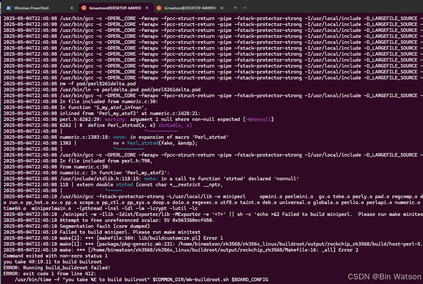

本文提供一种修复 Builroot 系统编译 perl 编译报错途径
  1. 2025-05-04T22:45:08 rm -f pod/perl5261delta.pod
  2. 2025-05-04T22:45:08 /usr/bin/ln -s perldelta.pod pod/perl5261delta.pod
  3. 2025-05-04T22:45:08 /usr/bin/gcc -c -DPERL_CORE -fwrapv -fpcc-struct-return -pipe -fstack-protector-strong -I/usr/local/include -D_LARGEFILE_SOURCE -D_FILE_OFFSET_BITS=64 -O2 -Wall op.c
  4. 2025-05-04T22:45:08 In file included from numeric.c:30:
  5. 2025-05-04T22:45:08 In function 'S_my_atof_infnan',
  6. 2025-05-04T22:45:08 inlined from 'Perl_my_atof2' at numeric.c:1428:21:
  7. 2025-05-04T22:45:08 perl.h:6262:29: warning: argument 1 null where non-null expected [-Wnonnull]
  8. 2025-05-04T22:45:08 6262 | #  define Perl_strtod(s, e) strtod(s, e)
  9. 2025-05-04T22:45:08 |                             ^~~~~~~~~~~~
  10. 2025-05-04T22:45:08 numeric.c:1303:18: note: in expansion of macro 'Perl_strtod'
  11. 2025-05-04T22:45:08 1303 |             nv = Perl_strtod(fake, &endp);
  12. 2025-05-04T22:45:08 |                  ^~~~~~~~~~~
  13. 2025-05-04T22:45:08 /usr/bin/gcc -c -DPERL_CORE -fwrapv -fpcc-struct-return -pipe -fstack-protector-strong -I/usr/local/include -D_LARGEFILE_SOURCE -D_FILE_OFFSET_BITS=64 -O2 -Wall perly.c
  14. 2025-05-04T22:45:08 In file included from perl.h:790,
  15. 2025-05-04T22:45:08 from numeric.c:30:
  16. 2025-05-04T22:45:08 numeric.c: In function 'Perl_my_atof2':
  17. 2025-05-04T22:45:08 /usr/include/stdlib.h:118:15: note: in a call to function 'strtod' declared 'nonnull'
  18. 2025-05-04T22:45:08 118 | extern double strtod (const char *__restrict __nptr,
  19. 2025-05-04T22:45:08 |               ^~~~~~
  20. 2025-05-04T22:45:10 /usr/bin/gcc -fstack-protector-strong -L/usr/local/lib -o miniperl     opmini.o perlmini.o  gv.o toke.o perly.o pad.o regcomp.o dump.o util.o mg.o reentr.o mro_core.o keywords.o hv.o av.o run.o pp_hot.o sv.o pp.o scope.o pp_ctl.o pp_sys.o doop.o doio.o regexec.o utf8.o taint.o deb.o universal.o globals.o perlio.o perlapi.o numeric.o mathoms.o locale.o pp_pack.o pp_sort.o caretx.o dquote.o time64.o  miniperlmain.o  -lpthread -lnsl -ldl -lm -lcrypt -lutil -lc
  21. 2025-05-04T22:45:10 ./miniperl -w -Ilib -Idist/Exporter/lib -MExporter -e '<?>' || sh -c 'echo >&2 Failed to build miniperl.  Please run make minitest; exit 1'
  22. 2025-05-04T22:45:10 Attempt to free unreferenced scalar: SV 0x563360ecf450.
  23. 2025-05-04T22:45:10 Segmentation fault (core dumped)
  24. 2025-05-04T22:45:10 Failed to build miniperl. Please run make minitest
  25. 2025-05-04T22:45:10 make[2]: *** [makefile:364: lib/buildcustomize.pl] Error 1
  26. 2025-05-04T22:45:10 make[1]: *** [package/pkg-generic.mk:231: /home/binwatson/rk3568/rk356x_linux/buildroot/output/rockchip_rk3568/build/host-perl-5.26.1/.stamp_built] Error 2
  27. 2025-05-04T22:45:10 make: *** [/home/binwatson/rk3568/rk356x_linux/buildroot/output/rockchip_rk3568/Makefile:16: _all] Error 2
  28. Command exited with non-zero status 1
  29. you take 49:19.11 to build builroot
  30. ERROR: Running build_buildroot failed!
  31. ERROR: exit code 1 from line 412:
  32.     /usr/bin/time -f "you take %E to build builroot" $COMMON_DIR/mk-buildroot.sh $BOARD_CONFIG

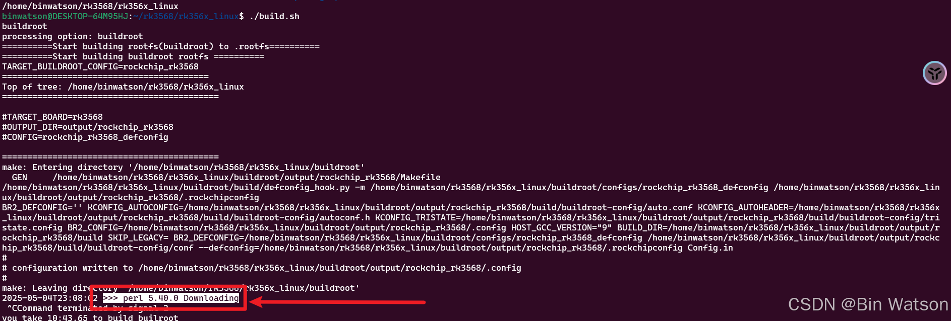

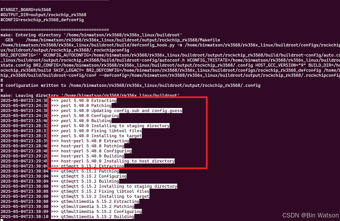

然后回到 SDK 目次,重新编译 buildroot 即可:

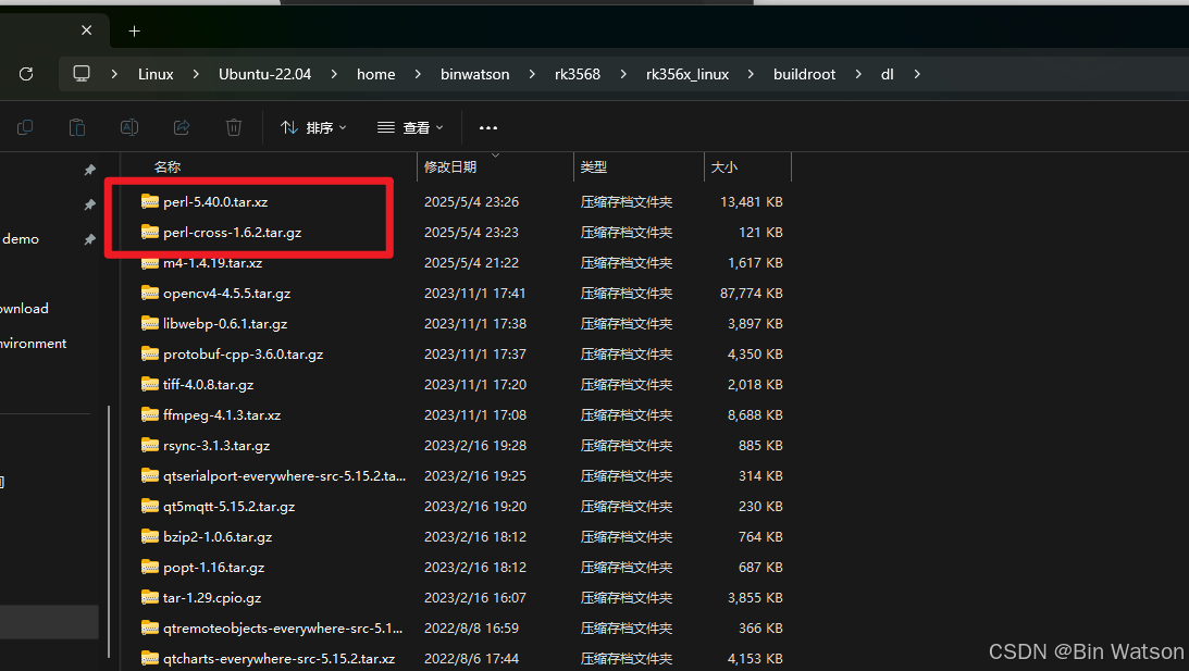

我实测下载很久都没下载下来,因此这里提供一种采用手动下载压缩包的方式:
  • perl 下路径,请记住选择和在 perl.mk 设置的版本雷同,这里我上面设置的是 5.40.0 的版本,因此下载 5.40.0 的版本 perl 5.40.0.tar.xz ;
  • perl-cross 下载路径,这里我下载 perl-cross-1.6.2.tar.gz;
然后将下载后的两个软件包,放在 buildroot/dl 目次下:
然后编译即可:
