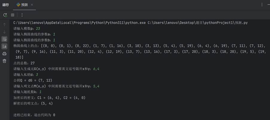

实行结果如下:

  31.         if P[0] == Q[0] and P[1] != Q[1]:
  32.             return (0, 0)  # 无穷远点
  33.         numerator = (Q[1] - P[1]) % p
  34.         denominator = (Q[0] - P[0]) % p
  35.     # 计算斜率 lambda
  36.     lambda_ = (numerator * pow(denominator, p - 2, p)) % p
  37.     # 计算新的点
  38.     x3 = (lambda_**2 - P[0] - Q[0]) % p
  39.     y3 = (lambda_ * (P[0] - x3) - P[1]) % p
  40.     return (x3, y3)
  41. def point_negation(p, P):
  42.     """计算点的逆点"""
  43.     return (P[0], p - P[1])
  44. def point_multiplication(p, a, P, k):
  45.     """椭圆曲线上的点乘法"""
  46.     result = (0, 0)
  47.     temp = P
  48.     while k > 0:
  49.         if k % 2 == 1:
  50.             result = point_addition(p, a, result, temp)
  51.         temp = point_addition(p, a, temp, temp)
  52.         k //= 2
  53.     return result
  54. # 输入参数
  55. p = int(input("请输入模数p:"))
  56. a = int(input("请输入椭圆曲线的参数a:"))
  57. b = int(input("请输入椭圆曲线的参数b:"))
  58. # 找到椭圆曲线上的所有点
  59. points, point_count = findsolution(p, a, b)
  60. print(f"椭圆曲线上的点:{points}")
  61. print(f"点的总数:{point_count}")
  62. # 输入生成元G和私钥d
  63. generator = tuple(map(int, input("请输入生成元G(x,y) 中间需要英文逗号隔开x和y:").strip("()").split(",")))
  64. private_key = int(input("请输入私钥d:"))
  65. # 验证生成元是否在椭圆曲线上
  66. if generator not in points:
  67.     raise ValueError("输入的生成元G不在椭圆曲线上!")
  68. # 生成公钥
  69. public_key = point_multiplication(p, a, generator, private_key)
  70. print(f"公钥Q = dG = {public_key}")
  71. # 加密
  72. plaintext_point = tuple(map(int, input("请输入明文点M(x,y) 中间需要英文逗号隔开x和y:").strip("()").split(",")))
  73. k = int(input("请输入随机数k:"))  # 用于加密过程
  74. # 计算C1 = kG
  75. C1 = point_multiplication(p, a, generator, k)
  76. # 计算C2 = M + k * d * G
  77. C2 = point_addition(p, a, plaintext_point, point_multiplication(p, a, generator, k * private_key))
  78. print(f"加密后的密文:C1 = {C1}, C2 = {C2}")
  79. # 解密
  80. # 计算M = C2 - k * d * G
  81. decrypted_point = point_addition(p, a, C2, point_negation(p, point_multiplication(p, a, C1, private_key)))
  82. print(f"解密后的明文点:{decrypted_point}")
