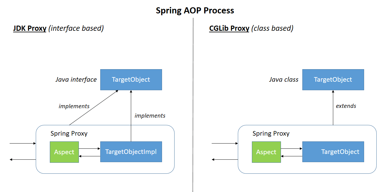

而Spring AOP是运行时织入的,主要使用了两种技术:JDK动态代理和CGLIB代理。对于接口使用JDK Proxy,而继承的使用CGLIB。

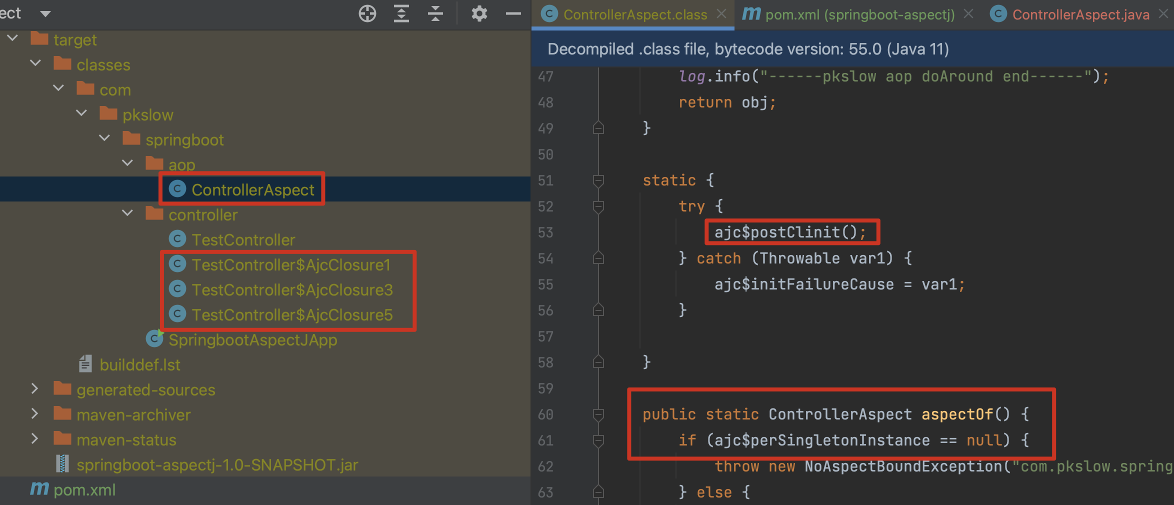

3.4 maven插件
因为是需要编译时织入代码,所以需要maven插件的支持:https://github.com/mojohaus/aspectj-maven-plugin
配置好pom.xml文件即可。
然后执行命令打包:
  1. mvn clean package
这时会显示一些织入信息,大致如下:
  1. [INFO] Join point 'method-execution(java.lang.String com.pkslow.springboot.controller.TestController.hello())' in Type 'com.pkslow.springboot.controller.TestController' (TestController.java:14) advised by around advice from 'com.pkslow.springboot.aop.ControllerAspect' (ControllerAspect.class(from ControllerAspect.java))
  2. [INFO] Join point 'method-execution(java.lang.String com.pkslow.springboot.controller.TestController.hello())' in Type 'com.pkslow.springboot.controller.TestController' (TestController.java:14) advised by before advice from 'com.pkslow.springboot.aop.ControllerAspect' (ControllerAspect.class(from ControllerAspect.java))
  3. [INFO] Join point 'method-execution(void com.pkslow.springboot.controller.TestController.test())' in Type 'com.pkslow.springboot.controller.TestController' (TestController.java:22) advised by around advice from 'com.pkslow.springboot.aop.ControllerAspect' (ControllerAspect.class(from ControllerAspect.java))
  4. [INFO] Join point 'method-execution(void com.pkslow.springboot.controller.TestController.test())' in Type 'com.pkslow.springboot.controller.TestController' (TestController.java:22) advised by before advice from 'com.pkslow.springboot.aop.ControllerAspect' (ControllerAspect.class(from ControllerAspect.java))
  5. [INFO] Join point 'method-execution(void com.pkslow.springboot.controller.TestController.staticTest())' in Type 'com.pkslow.springboot.controller.TestController' (TestController.java:28) advised by around advice from 'com.pkslow.springboot.aop.ControllerAspect' (ControllerAspect.class(from ControllerAspect.java))
  6. [INFO] Join point 'method-execution(void com.pkslow.springboot.controller.TestController.staticTest())' in Type 'com.pkslow.springboot.controller.TestController' (TestController.java:28) advised by before advice from 'com.pkslow.springboot.aop.ControllerAspect' (ControllerAspect.class(from ControllerAspect.java))
看到以上信息,说明成功织入了代码,具体可以查看生成的class文件。
可以看到有许多代码都不是我们写的,而是织入生成。

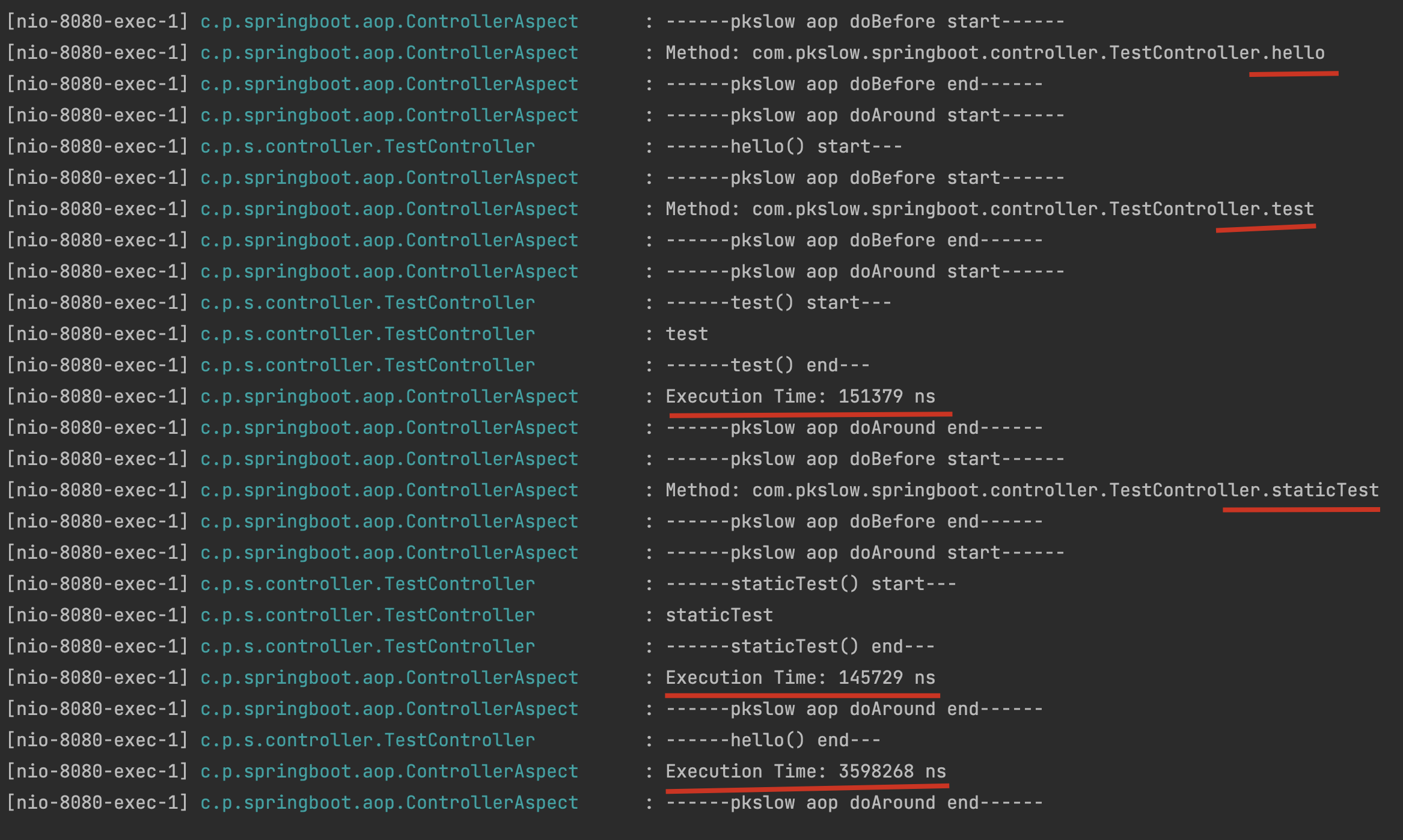

3.5 执行及测试
编译成功后,我们就执行代码。如果是通过IDEA来执行,则在运行前不需要再build了,因为已经通过maven build过了包。通过IDEA自带的编译器build,可能无法织入。或者选择ajc作为编译器。具体请参考:IDEA启动Springboot但AOP失效
访问如下:
  1. GET http://localhost:8080/test/hello
日志日志如下,成功实现AOP功能
