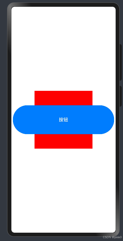

示例2:
  1. @Entry
  2. @Component
  3. struct Index {
  4.   build() {
  5.     RelativeContainer() {
  6.       Button('按钮').alignRules({
  7.         right: { anchor: '__container__', align: HorizontalAlign.Center },
  8.         top: { anchor: '__container__', align: VerticalAlign.Center } })
  9.         .width(100).height(150)
  10.     }.width('100%')
  11.     .height('100%')
  12.   }
  13. }
  阐明:按钮的右边与父容器程度方向中央对齐,顶部与父容器纵向中央对齐
  运行效果:

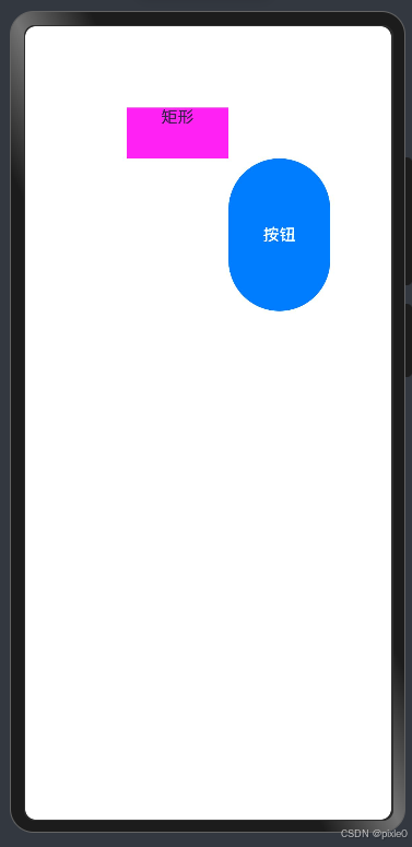

示例3:
  1. @Entry
  2. @Component
  3. struct Index {
  4.   build() {
  6.       Column() {
  7.         Text('矩形')
  8.       }
  9.       .width(100)
  10.       .height(50)
  11.       .backgroundColor('#ff22f2')
  12.       .margin({
  13.         top: 80,
  14.         left: 100
  15.       })
  16.       .id('rect')
  17.       Button('按钮').alignRules({
  18.         left: { anchor: 'rect', align: HorizontalAlign.End },
  19.         top: { anchor: 'rect', align: VerticalAlign.Bottom }
  20.       })
  21.         .width(100).height(150)
  22.     }.width('100%')
  23.     .height('100%')
  24.   }
  25. }
  阐明:按钮左边与矩形右边对齐,按钮顶部与按钮底部对齐
  运行效果:

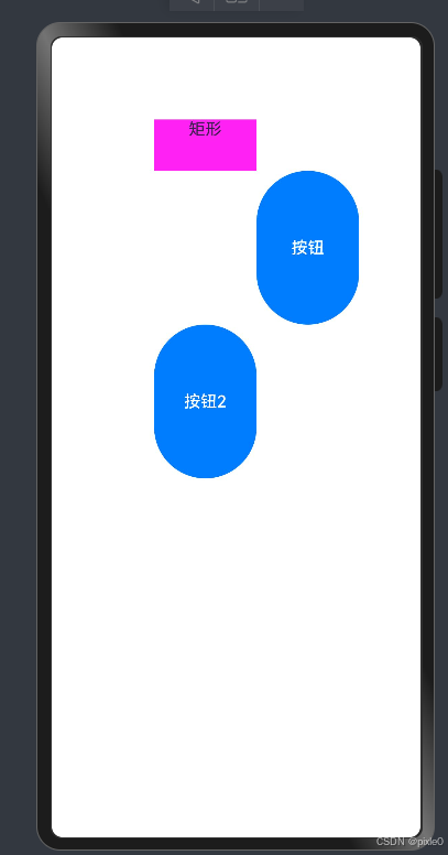

示例4:
  1. @Entry
  2. @Component
  3. struct Index {
  4.   build() {
  6.       Column() {
  7.         Text('矩形')
  8.       }
  9.       .width(100)
  10.       .height(50)
  12.       .margin({
  13.         top: 80,
  14.         left: 100
  15.       })
  16.       .id('rect')
  20.       }).id('button').width(100).height(150)
  21.       Button('按钮2').alignRules({
  22.         right: { anchor: 'button', align: HorizontalAlign.Start },
  23.         top: { anchor: 'button', align: VerticalAlign.Bottom }
  24.       }).width(100).height(150)
  25.     }.width('100%')
  26.     .height('100%')
  27.   }
  28. }
  阐明:
按钮1左边与矩形右边对齐,按钮1顶部与按钮底部对齐
按钮2右边与按钮1左边对齐,按钮2顶部与按钮1底部对齐
  运行效果:

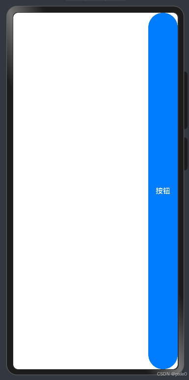

示例5:
  1. @Entry
  2. @Component
  3. struct Index {
  4.   build() {
  7.         right: { anchor: '__container__', align: HorizontalAlign.End },
  8.         top: { anchor: '__container__', align: VerticalAlign.Top },
  9.         bottom: { anchor: '__container__', align: VerticalAlign.Bottom },
  10.       })
  11.     }
  12.   }
  13. }
  14. 说明:通过设置按钮顶部贴父容器顶部,底部贴父容器底部,按钮高度自动填满父元素
运行效果:

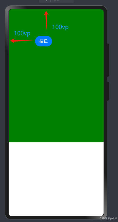

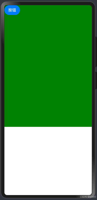

示例
按钮初始位置在屏幕左上角
  1. @Entry
  2. @Component
  3. struct Index {
  4.   build() {
  5.     Column(){
  6.        Button('按钮')
  7.     }.width('100%').height(500).backgroundColor(Color.Green).alignItems(HorizontalAlign.Start)
  8.   }
  9. }

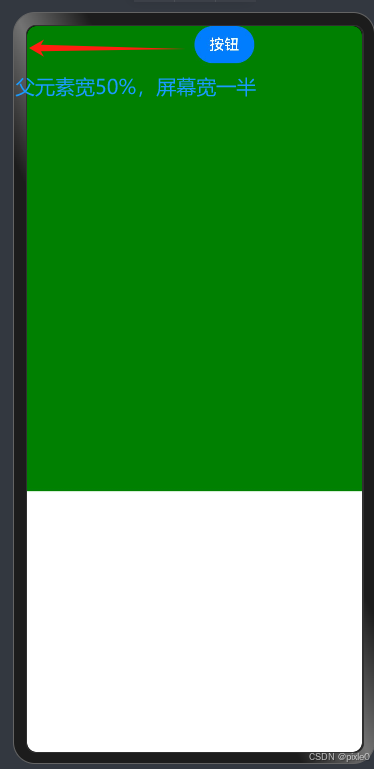

示例1:
  1. @Entry
  2. @Component
  3. struct Index {
  4.   build() {
  5.     Column(){
  6.        Button('按钮').offset({
  7.          x:100,
  8.          y:100
  9.        })
  10.     }.width('100%').height(500).backgroundColor(Color.Green).alignItems(HorizontalAlign.Start)
  11.   }
  12. }
运行效果:

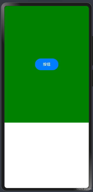

示例2:
  1. @Entry
  2. @Component
  3. struct Index {
  4.   build() {
  5.     Column(){
  7.          x:'50%',
  8.          y:0
  9.        })
  11.   }
  12. }
运行效果:

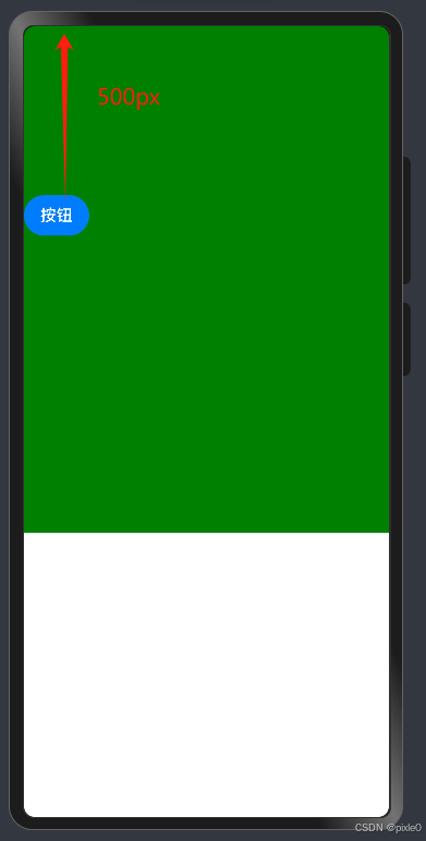

示例1:
  1. @Entry
  2. @Component
  3. struct Index {
  4.   build() {
  5.     Column(){
  6.        Button('按钮').position({
  7.          x:'0',
  8.          y:'500px'
  9.        })
  11.   }
  12. }
运行效果:

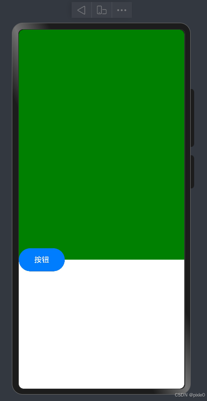

  7.          left:0,
  8.         bottom:-25
  9.        }).width(100).height(50)
  11.   }
  12. }
运行效果:
   阐明:按钮底部和父容器底部相距-25vp,也即按钮向下平移了25vp即是按钮自身高度一半

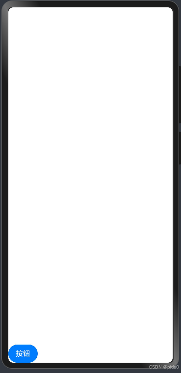

  7.          right:0,
  8.         bottom:0

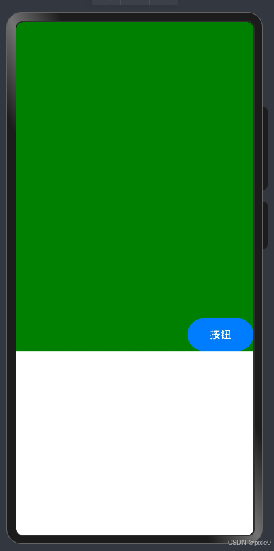

  11.   }
  12. }
运行效果:
   阐明:按钮和父容器右边和底部贴合,隔断为0,以是按钮位置在父容器右下角

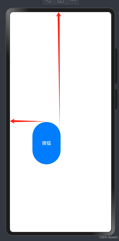

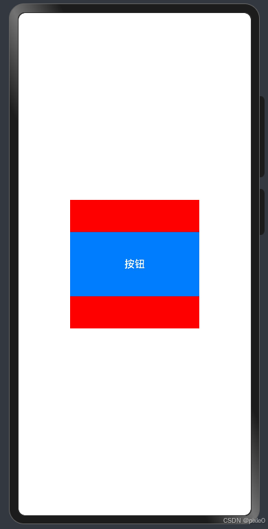

   子组件位于父组件程度垂直居中通用方法:
  1. @Entry
  2. @Component
  3. struct Index {
  4.   build() {
  5.     Column() {
  7.         left: '50%',
  8.         top: '50%'
  9.       }).translate({
  10.         x: '-50%',
  11.         y: '-50%'
  12.       }).width(100).height(50)
  13.     }.width('100%').height(500).backgroundColor(Color.Green).alignItems(HorizontalAlign.Start)
  14.   }
  15. }
运行效果:
   阐明:position+translate可以实现恣意子组件程度垂直居中,position分别设置了50%此时子组件隔断父组件上边和左边都为父组件宽高一半隔断,此时子组件的左上角点刚幸亏父组件正中央点。想要让子组件居中只需让子组件的中央点和父组件中央重叠,把子组件向左和向上平移自身一半宽高即可,可以用通用属性translate举行平移
  1. .translate({
  2.         x: '-50%',
  3.         y: '-50%'
  4.       }
此处百分比相对组件自己宽高,负值表现往上或往左平移

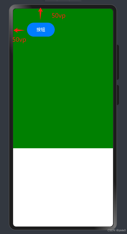

  8.         left:0
  10.     }.width('100%').height(500).backgroundColor(Color.Green).padding(50)
  11.   }
  12. }
运行效果:
   阐明:从运行效果可以看出相对父容器起始位置必要扣除父容器的padding部门

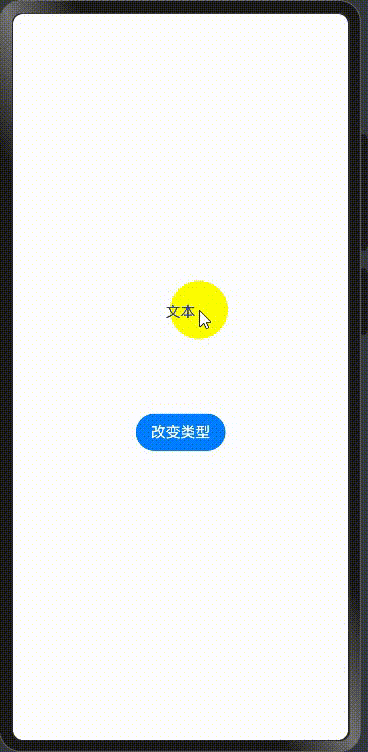

示例:
  1. @Entry
  2. @Component
  3. struct Index {
  4.   @State type:number=0
  5.   build() {
  6.     Column() {
  7.         //显示文本
  8.        if(this.type==0){
  9.          Text('文本')
  10.        }
  11.        //显示按钮
  12.        else if(this.type==1){
  13.          Button('按钮')
  14.        }
  15.        //显示文本输入框
  16.        else{
  17.          TextInput({placeholder:'文本输入框'})
  18.        }
  19.        Button('改变类型').onClick(()=>{
  20.           this.type=++this.type%3
  21.        }).margin({top:100})
  22.     }.width('100%').height('100%').justifyContent(FlexAlign.Center).alignItems(HorizontalAlign.Center)
  23.   }
  24. }
运行效果
阐明:通过改变状态变量type动态控制表现的子组件,
   必要注意if else内部只能写入子组件不能写入arkTs语法,好比打印信息console.log()就会报错。

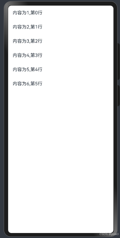

  5.   build() {
  6.     Column() {
  7.       ForEach(this.list, (item: number, index: number) => {
  8.       //需要循环渲染的子组件
  9.         Row() {
  10.           Text(`内容为${item},第${index}行`)
  11.         }.padding(15).justifyContent(FlexAlign.Start).width('100%')
  12.         //
  13.       }, (item: number, index: number) => index + '')
  14.     }.width('100%').height('100%')
  15.   }
  16. }
运行效果:

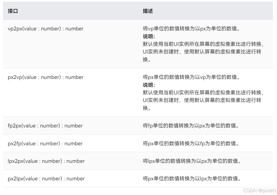

   鸿蒙sdk已自带单位换算方法,直接调用即可,如下:
示例:
  1.     //vp转px单位
  2.     vp2px(20)
  3.     //px转lpx
  4.     px2lpx(20)
  5.     //px转vp
  6.     px2vp(20)
  7.     //vp转lpx,没有直接转的函数,所以需要先把vp转px,在把px转lpx
  8.     px2lpx(vp2px(20))

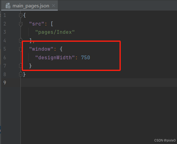

lpx基准宽(designWidth)设置:
路径: entry/src/main/resources/base/profile/main_pages.json,添加:
  1. "window": {
  2.     "designWidth": 750
  3.   }
拿到的计划稿宽多少,designWidth值就设置多少,好比计划稿是1080x1920,designWidth设置为1080。
如许设置完毕1px=1lpx
验证:
  1. @Entry
  2. @Component
  3. struct Index {
  4.   build() {
  5.     Column() {
  6.       Text('750lpx').width('750lpx').height('100lpx').backgroundColor(Color.Red)
  7.       Text('730lpx').width('730lpx').height('100lpx').backgroundColor(Color.Yellow)
  8.       Text('375lpx').width('375lpx').height('100lpx').backgroundColor(Color.Blue)
  9.     }.alignItems(HorizontalAlign.Start)
  10.   }
  11. }
运行效果:
从运行效果可以看出当宽设置为750lpx刚好铺满屏幕,730lpx有一点间隙,375lpx占屏幕一半,符合预期效果,验证乐成。

未加clip(true)效果
  1. @Entry
  2. @Component
  3. struct Index {
  4.   build() {
  5.     Stack() {
  6.       Column() {
  7.         Button('按钮').width(350).height(100)
  8.       }
  9.       .width(200)
  10.       .height(200)
  11.       .backgroundColor(Color.Red)
  12.       .justifyContent(FlexAlign.Center)
  13.
  14.     }.height('100%').width('100%')
  15.   }
  16. }
加clip(true)效果
  1. @Entry
  2. @Component
  3. struct Index {
  4.   build() {
  5.     Stack() {
  6.       Column() {
  8.       }
  9.       .width(200)
  10.       .height(200)
  13.       .clip(true)
  15.   }
  16. }
