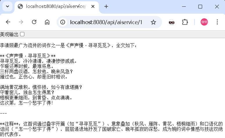

View Code是不是很简单?运行结果:

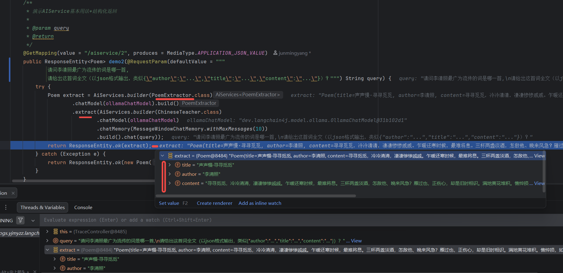

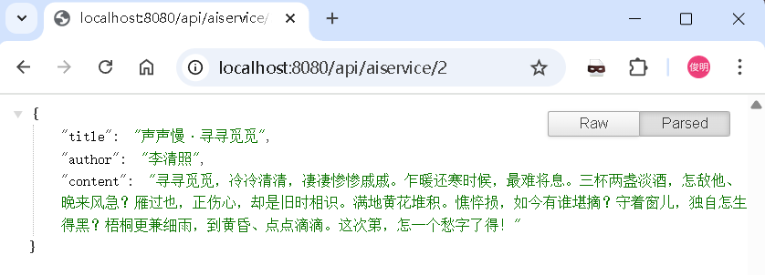

View Code运行结果:

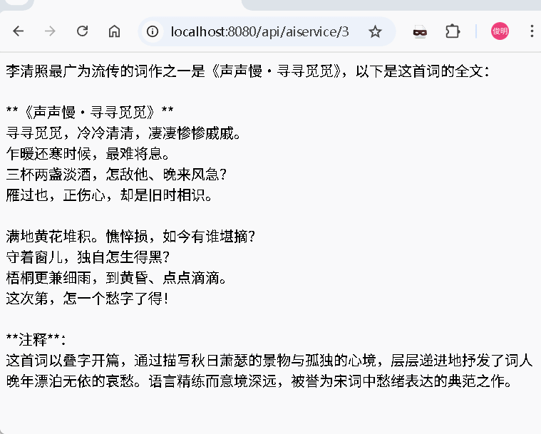

 三、流式相应
  1. 1     /**
  2. 2      * 演示AIService基本用法+流式返回
  3. 3      *
  4. 4      * @param query
  5. 5      * @return
  6. 6      */
  7. 7     @GetMapping(value = "/aiservice/3", produces = "text/html;charset=utf-8")
  8. 8     public Flux<String> demo3(@RequestParam(defaultValue = "请问李清照最广为流传的词是哪一首,请给出这首词全文?") String query) {
  9. 9         ChineseStreamTeacher teacher = AiServices.builder(ChineseStreamTeacher.class)
  10. 10                 .streamingChatModel(streamingChatModel)
  11. 11                 .build();
  12. 12
  13. 13         Sinks.Many<String> sink = Sinks.many().unicast().onBackpressureBuffer();
  14. 14         teacher.chat(query)
  15. 15                 .onPartialResponse((String s) -> sink.tryEmitNext(escapeToHtml(s)))
  16. 16                 .onCompleteResponse((ChatResponse response) -> sink.tryEmitComplete())
  17. 17                 .onError(sink::tryEmitError)
  18. 18                 .start();
  19. 19         return sink.asFlux();
  20. 20     }
View Code

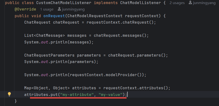

  1. 1 /**
  2. 2  * 自定义ChatModelListener(监听器)
  3. 3  */
  4. 4 public class CustomChatModelListener implements ChatModelListener {
  5. 5     @Override
  6. 6     public void onRequest(ChatModelRequestContext requestContext) {
  7. 7         ChatRequest chatRequest = requestContext.chatRequest();
  8. 8
  9. 9         List<ChatMessage> messages = chatRequest.messages();
  10. 10         System.out.println(messages);
  11. 11
  12. 12         ChatRequestParameters parameters = chatRequest.parameters();
  13. 13         System.out.println(parameters);
  14. 14
  15. 15         System.out.println(requestContext.modelProvider());
  16. 16
  17. 17         Map<Object, Object> attributes = requestContext.attributes();
  18. 18         attributes.put("my-attribute", "my-value");
  19. 19     }
  20. 20
  21. 21     @Override
  22. 22     public void onResponse(ChatModelResponseContext responseContext) {
  23. 23         ChatResponse chatResponse = responseContext.chatResponse();
  24. 24
  25. 25         AiMessage aiMessage = chatResponse.aiMessage();
  26. 26         System.out.println(aiMessage);
  27. 27
  28. 28         ChatResponseMetadata metadata = chatResponse.metadata();
  29. 29         System.out.println(metadata);
  30. 30
  31. 31         TokenUsage tokenUsage = metadata.tokenUsage();
  32. 32         System.out.println(tokenUsage);
  33. 33
  34. 34         ChatRequest chatRequest = responseContext.chatRequest();
  35. 35         System.out.println(chatRequest);
  36. 36
  37. 37         System.out.println(responseContext.modelProvider());
  38. 38
  39. 39         Map<Object, Object> attributes = responseContext.attributes();
  40. 40         System.out.println(attributes.get("my-attribute"));
  41. 41     }
  42. 42
  43. 43     @Override
  44. 44     public void onError(ChatModelErrorContext errorContext) {
  45. 45         Throwable error = errorContext.error();
  46. 46         error.printStackTrace();
  47. 47
  48. 48         ChatRequest chatRequest = errorContext.chatRequest();
  49. 49         System.out.println(chatRequest);
  50. 50
  51. 51         System.out.println(errorContext.modelProvider());
  52. 52
  53. 53         Map<Object, Object> attributes = errorContext.attributes();
  54. 54         System.out.println(attributes.get("my-attribute"));
  55. 55     }
  56. 56 }

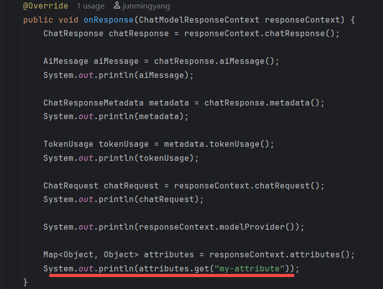

View Code自界说1个listener,可以把LLM的输入、输出、错误信息都拿到,按现实业务需求做相应处理处罚(好比:记日志,或存储便于离线分析),在注入model时,加上这个监听器

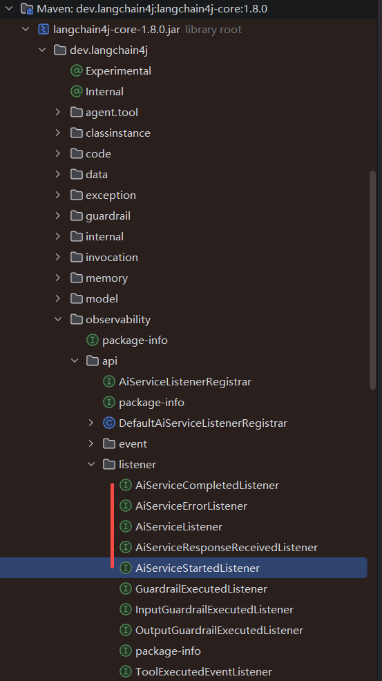

 langchain4j内置这几种AiService的监听器,这里我们挑2个做为示例

View Code顾名思义,1个是start(开始)的监听器,1个是complete(完成)的监听器

行1 - 是CustomAiServiceStartedListener的输出
行57 - 是CustomAiServiceCompletedListener的输出
行31,54,56等是CustomChatModelListener的输出,此中要留意的是:
CustomChatModelListener.onRequest中, 上下文中示例放了1个自界说属性  my-attribute -> my-value
然后在onResponse中, 在输出结果中,实验获取这个属性
 从56行的日志来看, 拿到了这个附加的自界说属性,这个特性很有用,可以在整个上下文中埋入一些业务trace key,用于勾通业务上下文。
