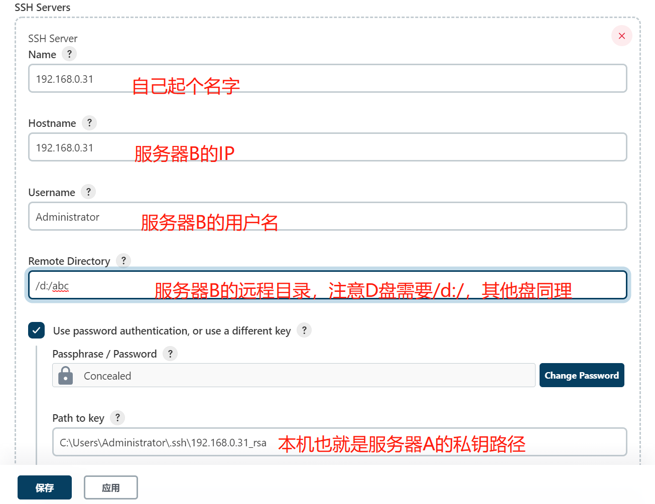

  • 在jenkins的Publish Over SSH插件配置中并测试联通性,位置Manage Jenkins->Configure System->SSH Servers中:
    点击测试,看是否联通成功,如果出现类似Fail Auth等错误,可以参考此解决方法来解决:Jenkins Publish over ssh authentification failed with private key
