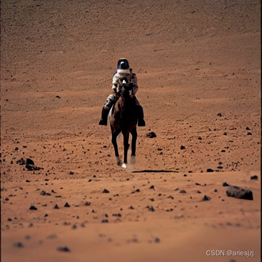

按官方文档(https://hf-mirror.com/runwayml/stable-diffusion-v1-5)运行Stable diffusion 1.5:
  1. from diffusers import StableDiffusionPipeline
  2. import torch
  3. model_id = "runwayml/stable-diffusion-v1-5"
  4. pipe = StableDiffusionPipeline.from_pretrained(model_id, torch_dtype=torch.float16)
  5. pipe = pipe.to("cuda")
  6. prompt = "a photo of an astronaut riding a horse on mars"
  7. image = pipe(prompt).images[0]
  8.
  9. image.save("astronaut_rides_horse.png")
运行上面脚本,结果:

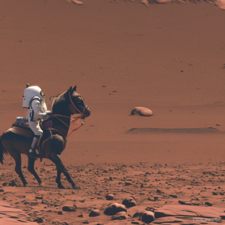

运行Stable Diffusion 2.1也是类似的。运行官方例子:
  1. import torch
  2. from diffusers import StableDiffusionPipeline, DPMSolverMultistepScheduler
  3. model_id = "stabilityai/stable-diffusion-2-1"
  4. # Use the DPMSolverMultistepScheduler (DPM-Solver++) scheduler here instead
  5. pipe = StableDiffusionPipeline.from_pretrained(model_id, torch_dtype=torch.float16)
  6. pipe.scheduler = DPMSolverMultistepScheduler.from_config(pipe.scheduler.config)
  7. pipe = pipe.to("cuda")
  8. prompt = "a photo of an astronaut riding a horse on mars"
  9. image = pipe(prompt).images[0]
  10.
  11. image.save("astronaut_rides_horse.png")
结果:

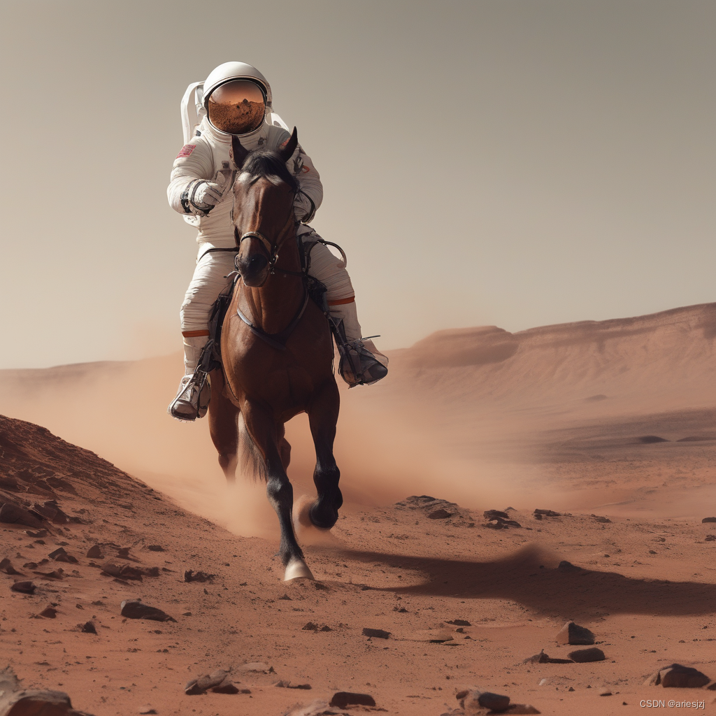

Stable Diffusion XL(SDXL)是一个更为强盛的天生模子。用法可拜见:https://hf-mirror.com/docs/diffusers/en/using-diffusers/sdxl。比如文生图的例子:
  1. from diffusers import AutoPipelineForText2Image
  2. import torch
  3. pipeline_text2image = AutoPipelineForText2Image.from_pretrained(
  4.     "stabilityai/stable-diffusion-xl-base-1.0", torch_dtype=torch.float16, variant="fp16", use_safetensors=True
  5. ).to("cuda")
  7. image = pipeline_text2image(prompt=prompt).images[0]
  8. image.save("astronaut_rides_horse.png")
结果:

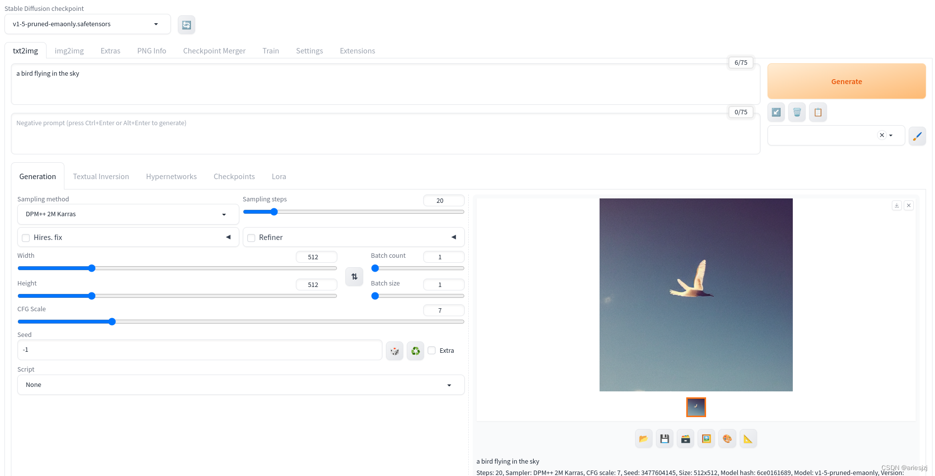

Stable Diffusion web UI
前面都是用的Python脚本。要调模子的各种参数须要改调用参数,不太易用和直观。接下来看看怎么基于Diffusion模子构建App。
stable-diffusion-webui是用Gradio库实现的Stable Diffusion的web接口。在Linux环境可以按照以下文档搭环境:
https://github.com/AUTOMATIC1111/stable-diffusion-webui?tab=readme-ov-file#automatic-installation-on-linux
如果在实验webui.sh的过程碰到下面标题:
  1. stderr: ERROR: Could not find a version that satisfies the requirement tb-nightly (from versions: none)
  2. ERROR: No matching distribution found for tb-nightly
可以换成阿里的pip源:
  1. pip config set global.index-url https://mirrors.aliyun.com/pypi/simple
别的脚本中会实验从hugging-face官网下载,无法下载的话可以将地点更换成:
  1. diff --git a/modules/sd_models.py b/modules/sd_models.py
  2. index 9355f1e1..bf5dbba5 100644
  3. --- a/modules/sd_models.py
  4. +++ b/modules/sd_models.py
  5. @@ -150,7 +150,7 @@ def list_models():
  6.      if shared.cmd_opts.no_download_sd_model or cmd_ckpt != shared.sd_model_file or os.path.exists(cmd_ckpt):
  7.          model_url = None
  8.      else:
  9. -        model_url = "https://huggingface.co/runwayml/stable-diffusion-v1-5/resolve/main/v1-5-pruned-emaonly.safetensors"
  10. +        model_url = "https://hf-mirror.com/runwayml/stable-diffusion-v1-5/resolve/main/v1-5-pruned-emaonly.safetensors"
  11.      model_list = modelloader.load_models(model_path=model_path, model_url=model_url, command_path=shared.cmd_opts.ckpt_dir, ext_filter=[".ckpt", ".safetensors"], download_name="v1-5-pruned-emaonly.safetensors", ext_blacklist=[".vae.ckpt", ".vae.safetensors"])
脚本实验完,顺遂的话就可以看到UI界面了。恣意输入点啥点Generate按钮就可以出图了。
比起脚本,这里参数的调治就直观得多,使用上傻瓜得多。

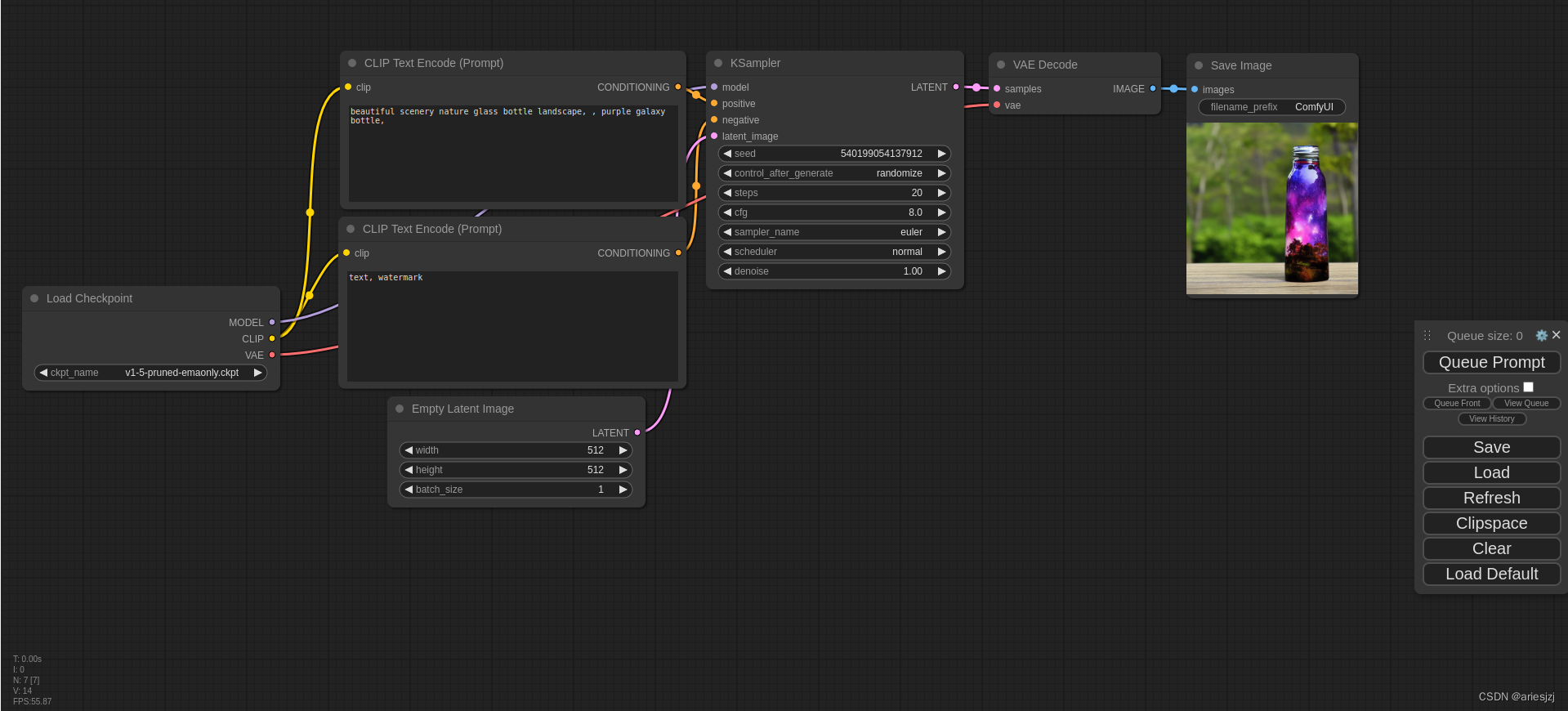

ComfyUI

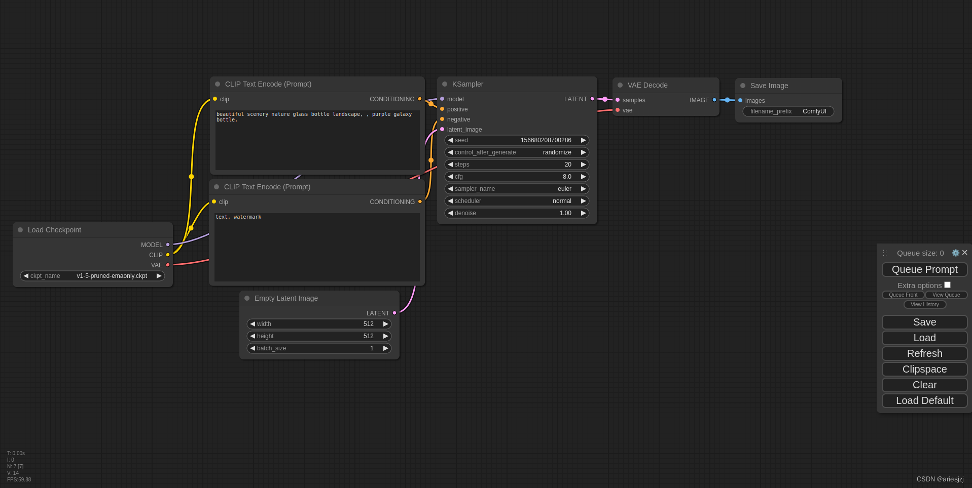

ComfyUI是图形化、模块化的Diffusion模子工作流构建工具。别的它还支持插件扩展。可以按照https://github.com/comfyanonymous/ComfyUI?tab=readme-ov-file#nvidia搭建环境,末了运行:
  1. python main.py
运行乐成后,打开http://127.0.0.1:8188,就可以看到UI界面:
接下来准备模子:
  1. cd models/checkpoints
  2. wget https://hf-mirror.com/runwayml/stable-diffusion-v1-5/resolve/main/v1-5-pruned-emaonly.ckpt
然后在UI中选择该模子后点Queue Prompt按钮,默认的例子就可以跑通了。整个过程图形化,很直观。
根本环境搭好后,接下来就可以试试官方的别的例子:https://comfyanonymous.github.io/ComfyUI_examples。比如用于视频天生的SVD(先容可拜见https://blog.comfyui.ca/comfyui/update/2023/11/24/Update.html)。根听阐明:https://comfyanonymous.github.io/ComfyUI_examples/video,先下载所需模子:
