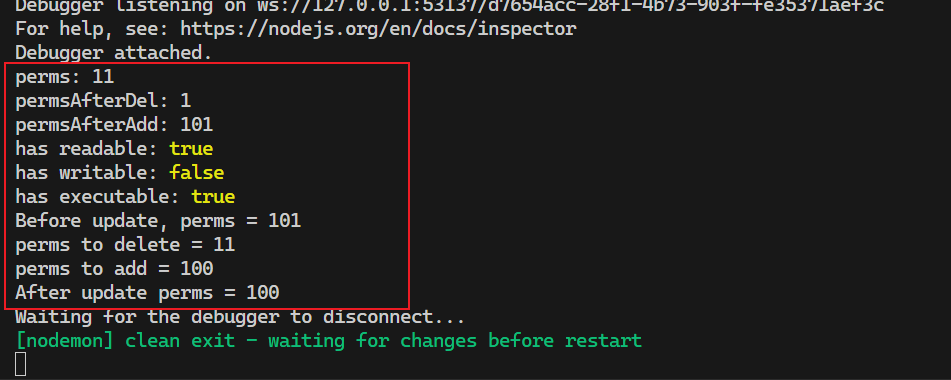

大功告成。
2.5 完整测试
搞定了 CRUD 操作,最后再完整测试一遍:
  1. // Test cases
  2. let perms = addPermission(Permission.Readable, Permission.Writable);
  3. console.log('perms:', perms.toString(2));  // 011
  4. // Test permission deletion
  5. perms = delPermission(perms, Permission.Writable);
  6. console.log('permsAfterDel:', perms.toString(2));  // 001
  7. // Test permission addition
  8. perms = addPermission(perms, Permission.Executable);
  9. console.log('permsAfterAdd:', perms.toString(2));  // 101
  10. // Test shared permission
  11. console.log('has readable:', hasPermission(perms, Permission.Readable));  // true
  12. console.log('has writable:', hasPermission(perms, Permission.Writable));  // false
  13. console.log('has executable:', hasPermission(perms, Permission.Executable));  // true
  14. // Test permission update
  15. console.log('Before update, perms =', perms.toString(2));               // 101 (i.e. 5)
  16. const pDel = addPermission(Permission.Readable, Permission.Writable);  // 011
  17. const pAdd = addPermission(Permission.Executable, Permission.Executable);  // 100
  18. console.log('perms to delete =', pDel.toString(2));  // 011 (i.e. 3)
  19. console.log('perms to add =', pAdd.toString(2));  // 110 (i.e. 6)
  20. perms = updatePermission(perms, pDel, pAdd);
  21. console.assert(perms === 0b100, `updatePermission failed: \nExpected '0b100', but got '0b${perms.toString(2)}'`);
  22. console.log('After update perms =', perms.toString(2));  // 110
实测结果如下:
