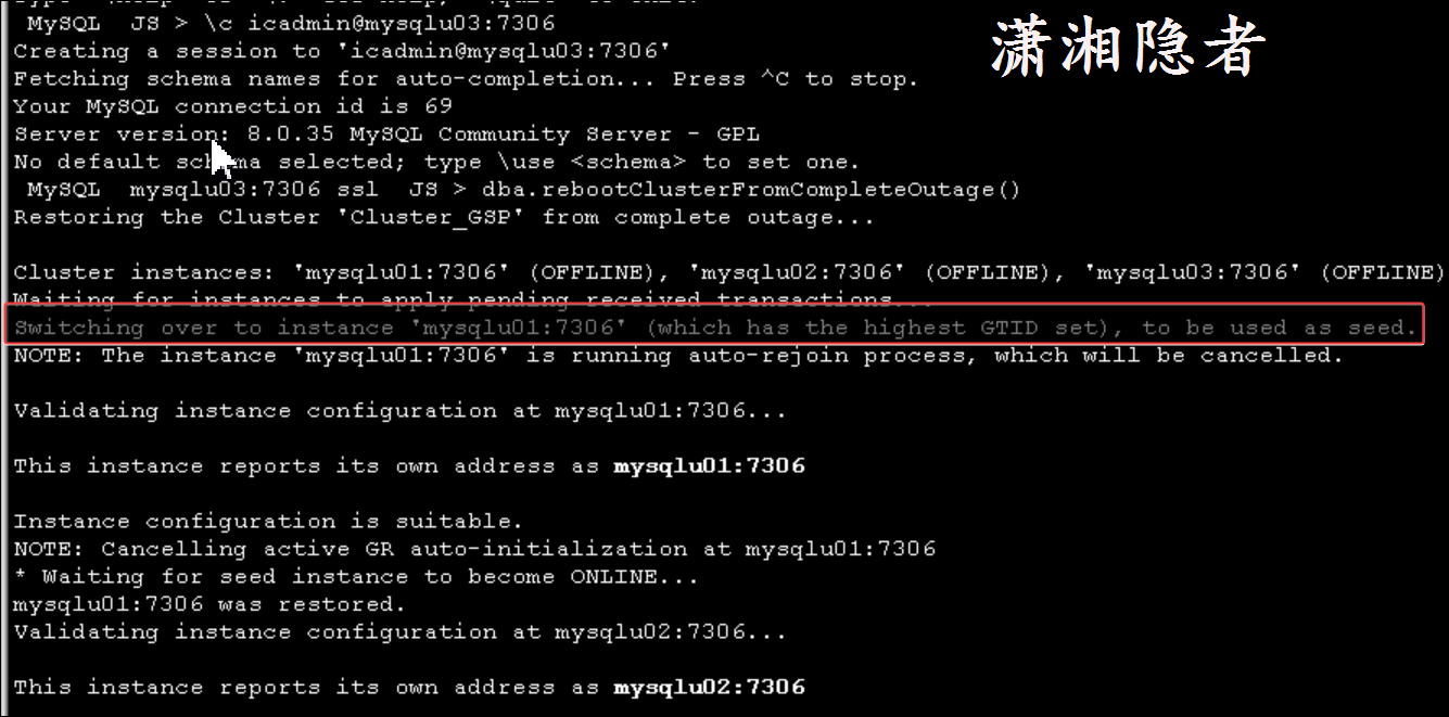

然后先后依次将mysqlu02,mysqlu01的MySQL服务关闭,然后启动这三个节点的MySQL服务,然后利用mysqlsh连接到mysqlu03上来启动
  1. mysqlsh icadmin@mysqlu03:7306
  2. mysqlsh icadmin@mysqlu03:7306 --log-level=DEBUG3
如下所示:
  1.  MySQL  mysqlu03:7306 ssl  JS > dba.rebootClusterFromCompleteOutage()
  2. Restoring the Cluster 'Cluster_GSP' from complete outage...
  3. Cluster instances: 'mysqlu01:7306' (OFFLINE), 'mysqlu02:7306' (OFFLINE), 'mysqlu03:7306' (OFFLINE)
  4. Waiting for instances to apply pending received transactions...
  5. Switching over to instance 'mysqlu01:7306' (which has the highest GTID set), to be used as seed.
  6. NOTE: The instance 'mysqlu01:7306' is running auto-rejoin process, which will be cancelled.
  7. Validating instance configuration at mysqlu01:7306...
  8. This instance reports its own address as mysqlu01:7306
  9. Instance configuration is suitable.
  10. NOTE: Cancelling active GR auto-initialization at mysqlu01:7306
  11. * Waiting for seed instance to become ONLINE...
  12. mysqlu01:7306 was restored.
  13. Validating instance configuration at mysqlu02:7306...
  14. This instance reports its own address as mysqlu02:7306
  15. Instance configuration is suitable.
  16. Rejoining instance 'mysqlu02:7306' to cluster 'Cluster_GSP'...
  17. Re-creating recovery account...
  18. NOTE: User 'mysql_innodb_cluster_201'@'%' already existed at instance 'mysqlu01:7306'. It will be deleted and created again with a new password.
  19. * Waiting for the Cluster to synchronize with the PRIMARY Cluster...
  20. ** Transactions replicated  ############################################################  100%
  21. The instance 'mysqlu02:7306' was successfully rejoined to the cluster.
  22. Validating instance configuration at mysqlu03:7306...
  23. This instance reports its own address as mysqlu03:7306
  24. Instance configuration is suitable.
  25. Rejoining instance 'mysqlu03:7306' to cluster 'Cluster_GSP'...
  26. Re-creating recovery account...
  27. NOTE: User 'mysql_innodb_cluster_202'@'%' already existed at instance 'mysqlu01:7306'. It will be deleted and created again with a new password.
  28. * Waiting for the Cluster to synchronize with the PRIMARY Cluster...
  29. ** Transactions replicated  ############################################################  100%
  30. The instance 'mysqlu03:7306' was successfully rejoined to the cluster.
  31. The Cluster was successfully rebooted.
  32. <Cluster:Cluster_GSP>
  33.  MySQL  mysqlu03:7306 ssl  JS >
如上所示,从"Switching over to instance 'mysqlu01:7306' (which has the highest GTID set), to be used as seed."这个输出信息,我们可以清楚的看到MySQL Shell中利用命令启动集群的时候,它会自动判断哪一个节点的GTID值最大,这个测试案例中,mysqlu01节点的GTID值最大,它就将mysqlu01作为MGR的引导节点。所以,利用命令(dba.rebootClusterFromCompleteOutage())重启集群时,可以连接到集群的任一节点去启动集群。
